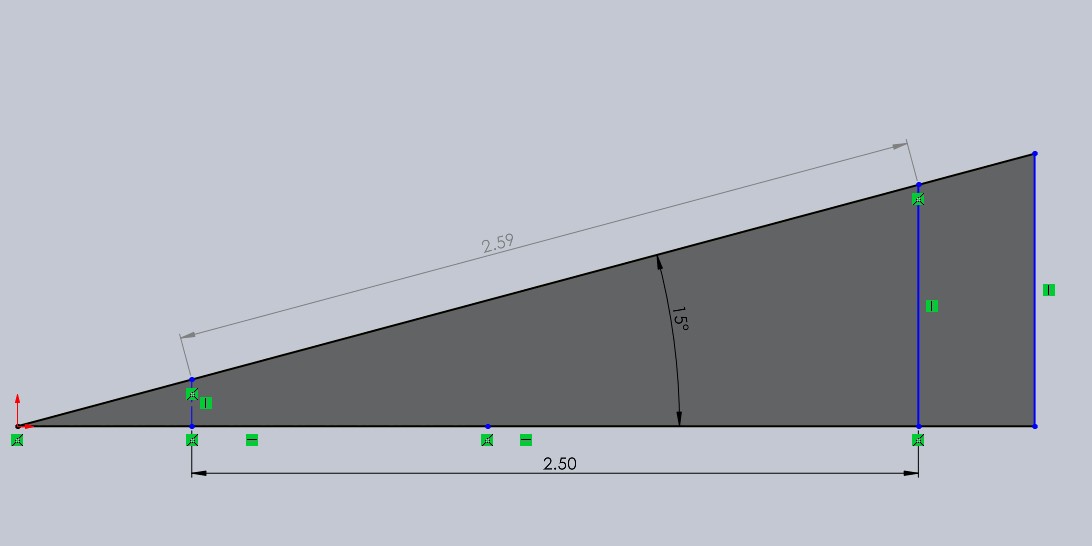

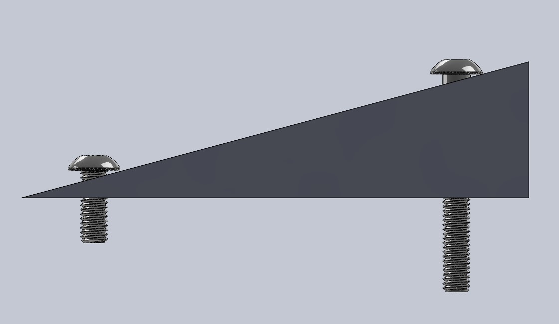

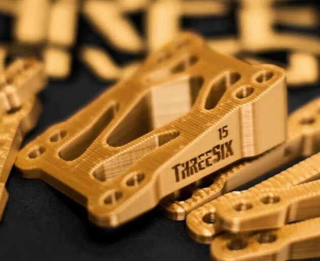

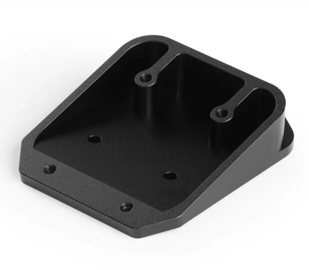

Sorry but you are comparing apples to oranges…i.e. additive manufactured (3d print) 15 degree wedge that compromises mounting bolt integrity due to the misaligned mounting angle compared to an engineered CNC aluminum mount that uses 4 bolts to mount the riser to the deck and 4 bolts to mount the trucks to the riser so all bolts are normal to their respective mounting surface.
I’ve never seen mounting bolts lose integrity from wedge risers, or have any sort of failure at all.
Especially not for an angle as low as 15 degrees.
A wedge riser might the most simple tech possible in all of skateboarding.
I don’t see any real justification, and a $50 wedge riser feels obscene.
And… Tapped aluminum, what?
Half of the old trucks I have in my collection with tapped baseplates are stripped out.
I think that’s a bigger risk than mounting hardware losing integrity.
I think the biggest advantage here is that extra long hardware is a huge pain, and this is a neat and clean solution.
I do like neat and clean. The engineer in me has a hard time coping with the angle of contact and the lengthening of the mount centers either on the deck or truck depending on what surface you mount to…something has to give.
My approach to that would be to ask, what are the observed outcomes?
I already know, Slalom guys have been bending bolts, angle drilling decks and base plates since day 1. Life is hard as a perfectionist.
Slalom guys break everything.
As an engineer i have never used angle wedges for the exact same reason of the bolt head contact patch is angled. there is no universe where those bolts won’t try to bend.

In line with current discussion it’s worth noting this board has the sketchy style risers…
To boot they are undersized 3D printed ones…
I do have high strength bolts.
I would gladly pay 50 Bucks for the MBS one as I think it’s a different beast than a regular plastic wedge…
But I need 10 degrees maximum. So I roll with the sketchy wedge…
