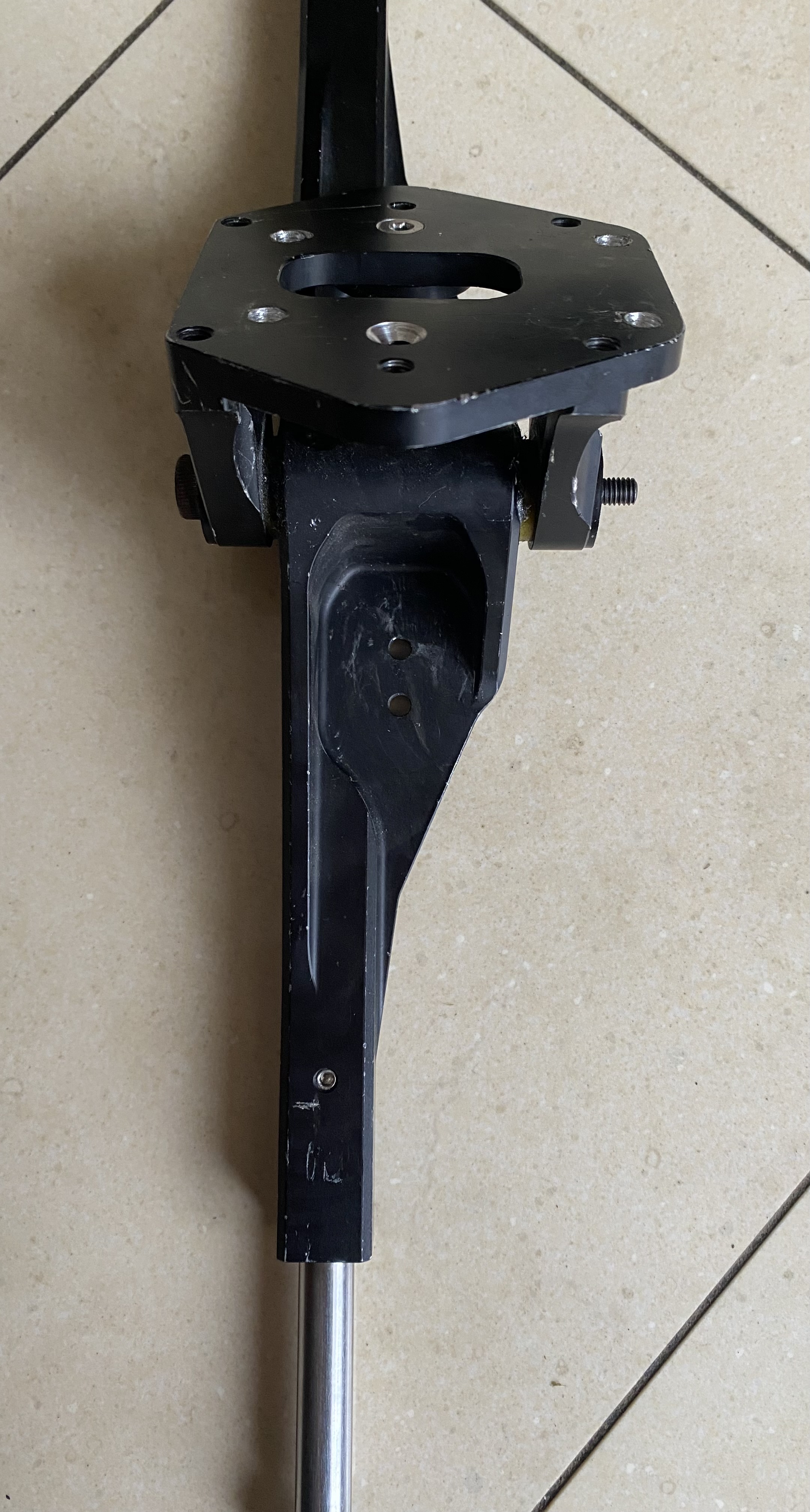

Adapting to existing designs is always tricky and with @MBS cooperation by sending me .step files of the components helped a lot as well as having a set of the trucks. Sending the 3dservisas finality truck would help but I would like to see detailed pictures first to see if it is even a possible adaptation. If the offer also extends to Trampa and Onsra, we would be interested. I do not think Kaly is a good candidate due to the small market size and they are gone.

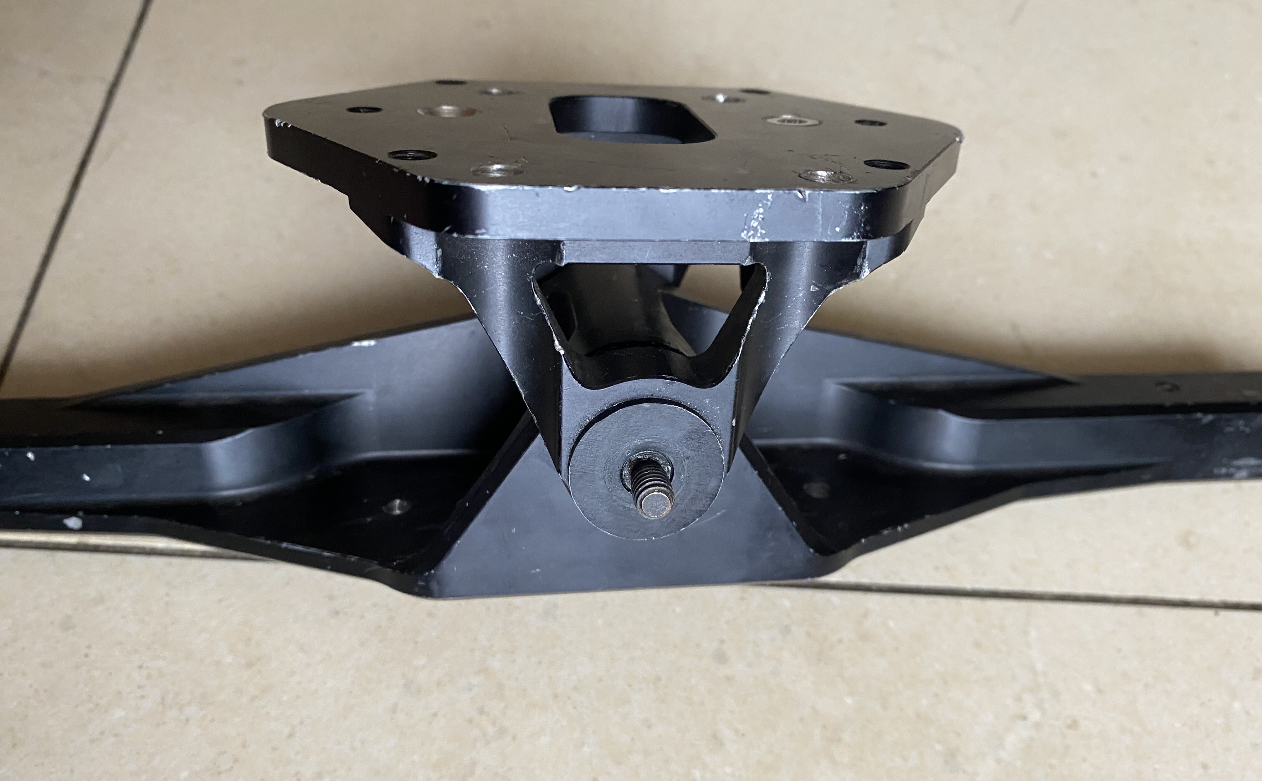

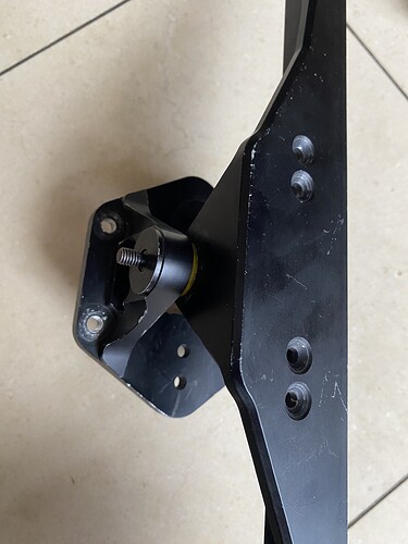

Great. I think these photos should help let me know if you want any more or some dimensions.
I don’t think you will easily make bushings that fit some of these trucks but not others and there are a good couple kaly’s still in use by owners who modify them.

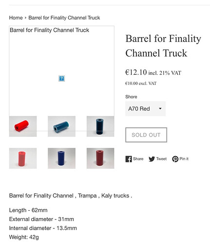

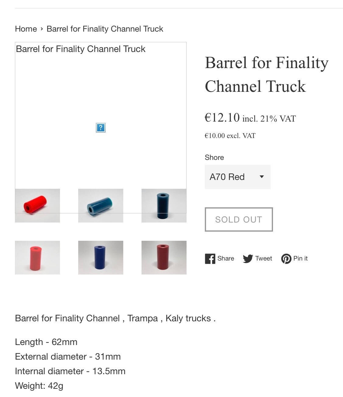

bushing dimensions used by all barrel bushing trucks by 3dservisas. screenshot w/ wayback machine
70A is very hard and the highest or near the hardest in the list. I had a turning circle of approx 6 metres
