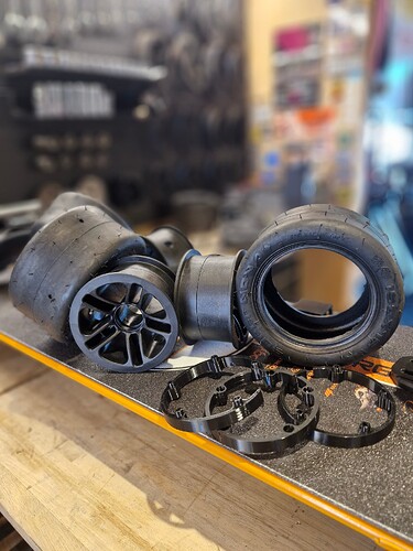

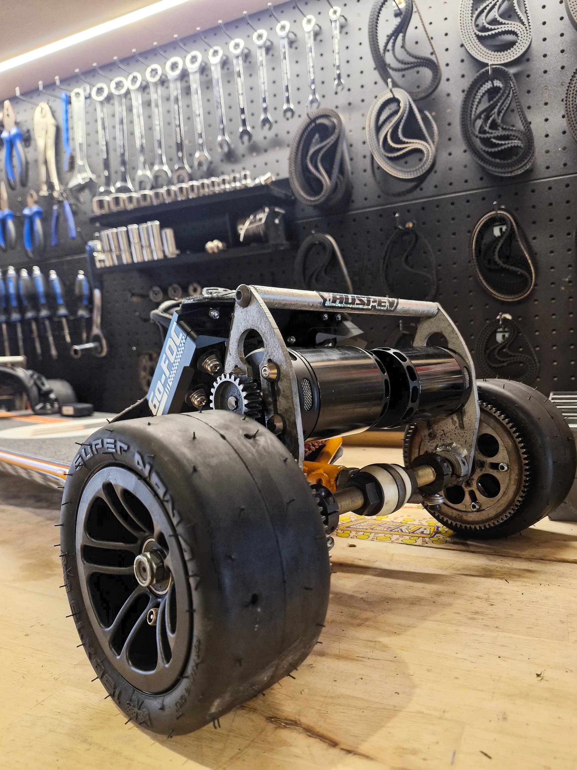

I tested the supernovas today, on stretched tomiboi hubs with 10mm spacers by @Twotwentyz
They look awesome, and gripped ok on the slick indoor surface once warm enough, but unfortunately it took me far too long to get hot - around 5 laps / 1.25km distance.
This would be less than ideal on raceday as we usually only get just under a lap to get to the start line, in which the standard 6 inch treaded Novas warm up quite easily. I swapped back to the novas just to double check that it wasnt a surface issue, and i was completely locked and gripping in on lap 2.
This reinforces our theory that the combination of a smaller contact patch combined with soft natural rubber is the best performing tyre on the slick indoor surface. Some people are also thinking the treaded pattern assists with further grip on this slick surface

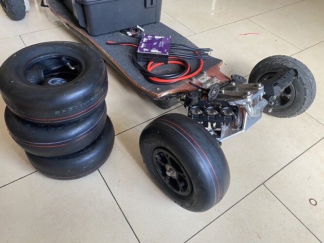

Bought the CST and Trampa tires and got free inner tubes. Unfortunately I don’t have the skills and experience to tell if they are relatively good or not, but I can leave some life in them until then.

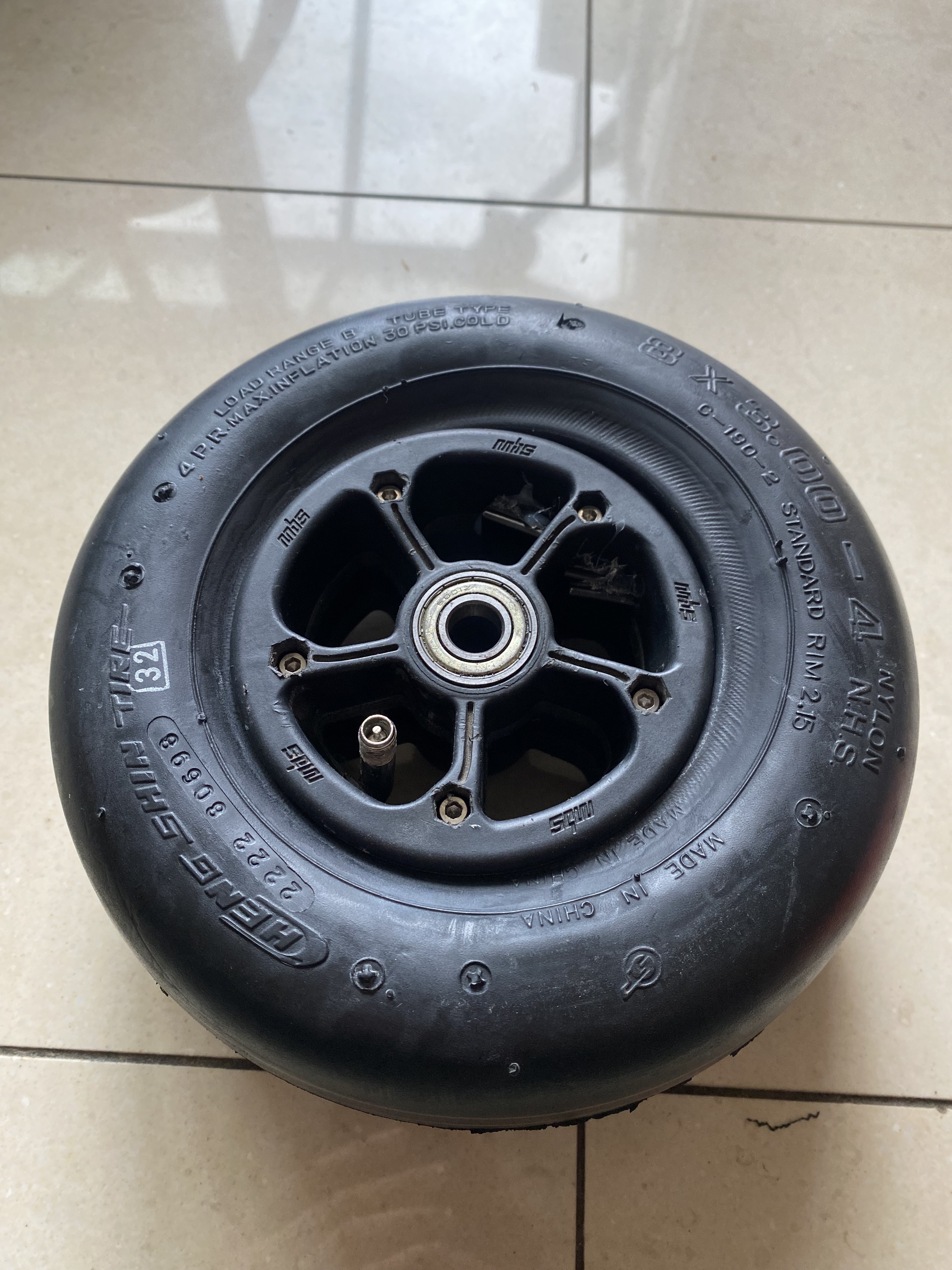

Wasn’t sure where to ask but will a lip spacer fix this or are MBS rockstars just too small?
I can get some Acedeck Nyx Z3 hubs very cheap but idk if they are better.
I’d just get different wheels. There may be a way to jerry-rig them to work, but they’re not intended to fit on those wheels. There are two diameters commonly used in eskate: one is 94 mm (or 3.75"), and the other is 100 mm (or 4"). Rockstars are for 94 mm diameter, but those tires are 100 mm diameter. I don’t know anything about Acedeck hubs, but Fivestars or Rockstar II XLs will work as far as MBS stuff, and then Trampa has some options. I haven’t looked at wheels other than those a ton, but you want to make sure that they’re compatible with the larger diameter.
The Width of the wheel also matters, but I’ve run those on Fivestars before and they worked fine. They might be slightly flatter on a wider wheel, but they were fine on the Fivestars.
Edit: Actually, I haven’t run those. I had Kendas in that size. Tires of the same size aren’t completely consistent in how they fit between brands, though. I have Air-Locs now, and those seem bigger than the Kendas, even though they’re all 8x3.00- 4.
Thanks that clears things up a lot for me.

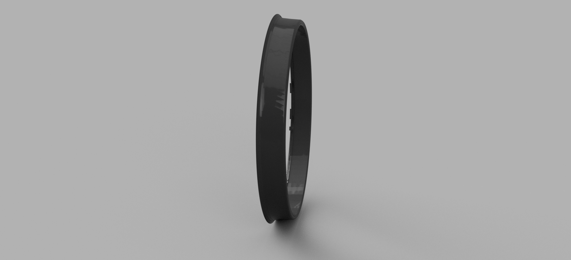

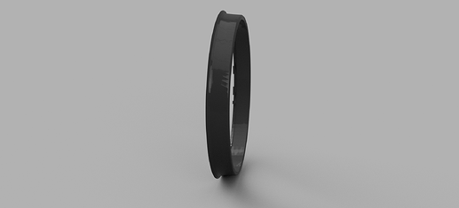

I will try this in the meantime if it fits right I will clean up and share the file.
