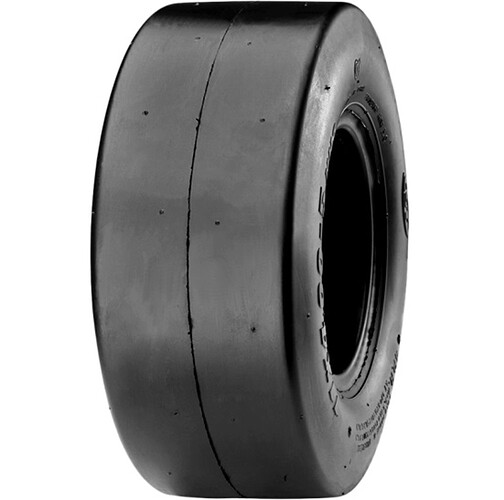

Does anyone know if they actually use a different compound on the C190 “kart tires” and the C190 mower tires? I’m having a hard time finding places in the US to buy the 8" slicks at all, but the main place I found them was selling them as mower tires. Also, unfortunately, they’re back-ordered, and they don’t have an ETA. It does seem on their site the cart tires have “Challenger” in the name, and the mower tires don’t, but I’m having trouble finding much information.
The lawn tires only being $12.25 makes them pretty damn cheap tires if they’re any good.
Also, just as an informational point, these Kenda lawn tires claim to have a durometer rating of 63:
which I think is reasonable. I’m used to durometer ratings also having a letter, though. Anyway, I think maybe these could work or even are the same as the kart tires, but I’m not sure.

These are the ones I’ve used.
Here’s a source for the kendas in supposedly the 63A compound.

Yep, but I only did an inclined plane test. “Lab” results, not real world riding, indicate 20% more static friction than the CSTs. I’m pretty far off from having a board to ride them on.
Has anything been said about these?
