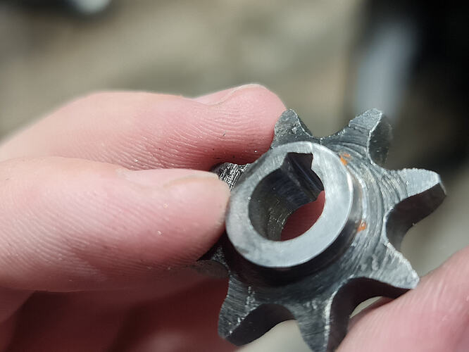

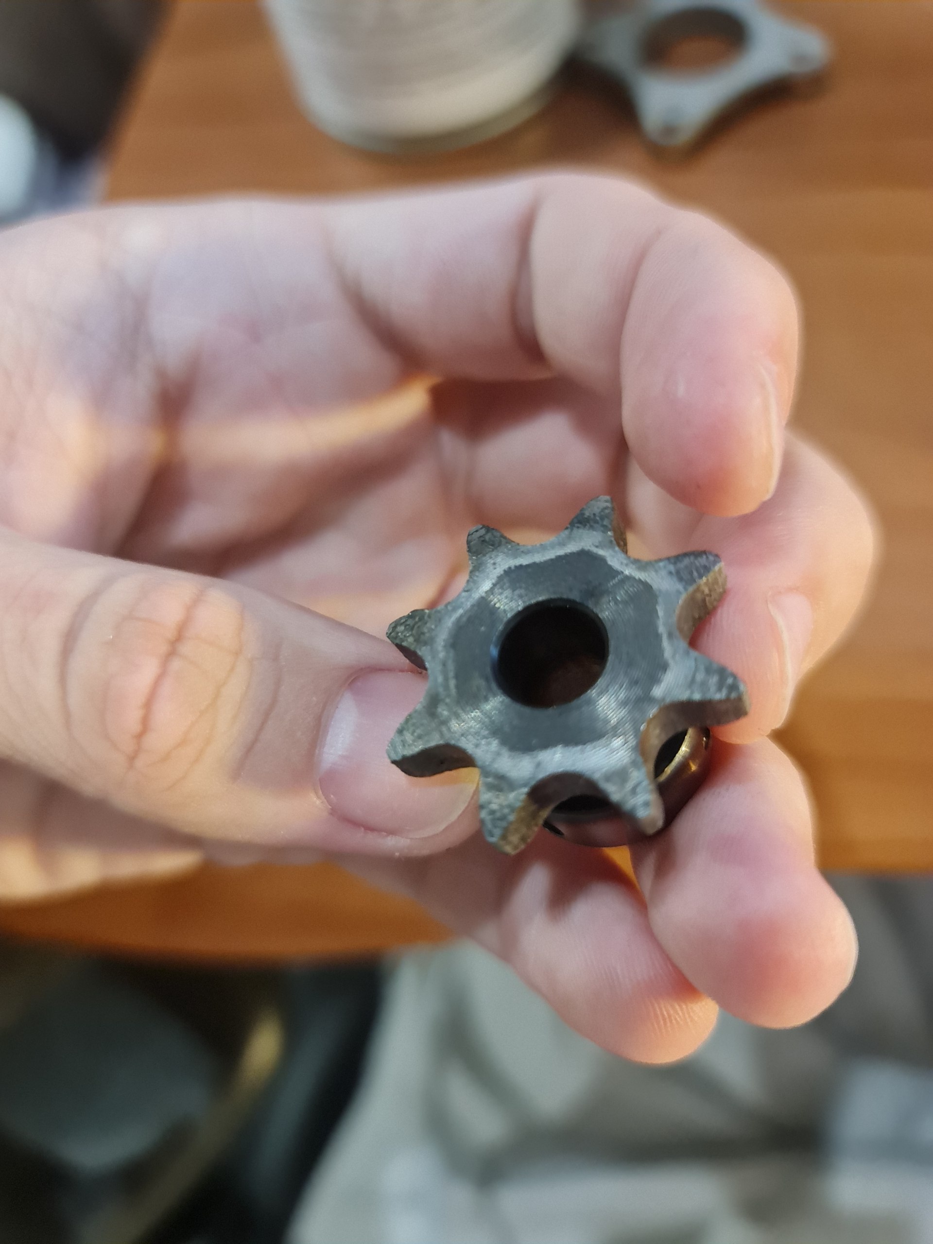

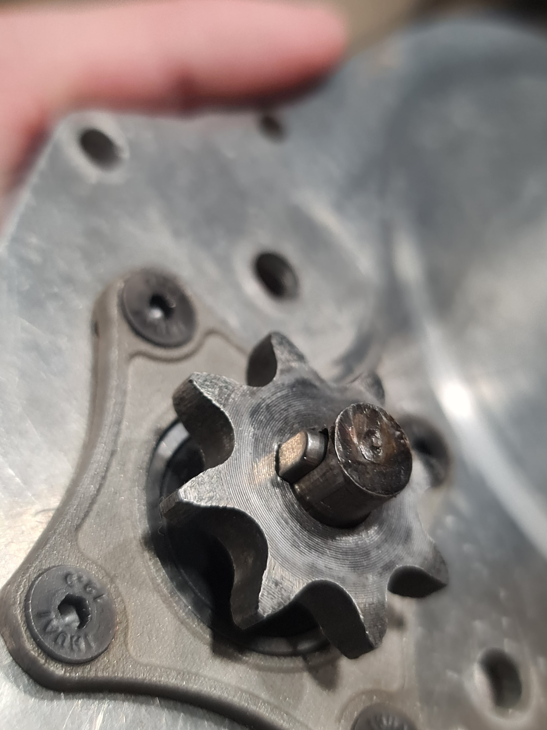

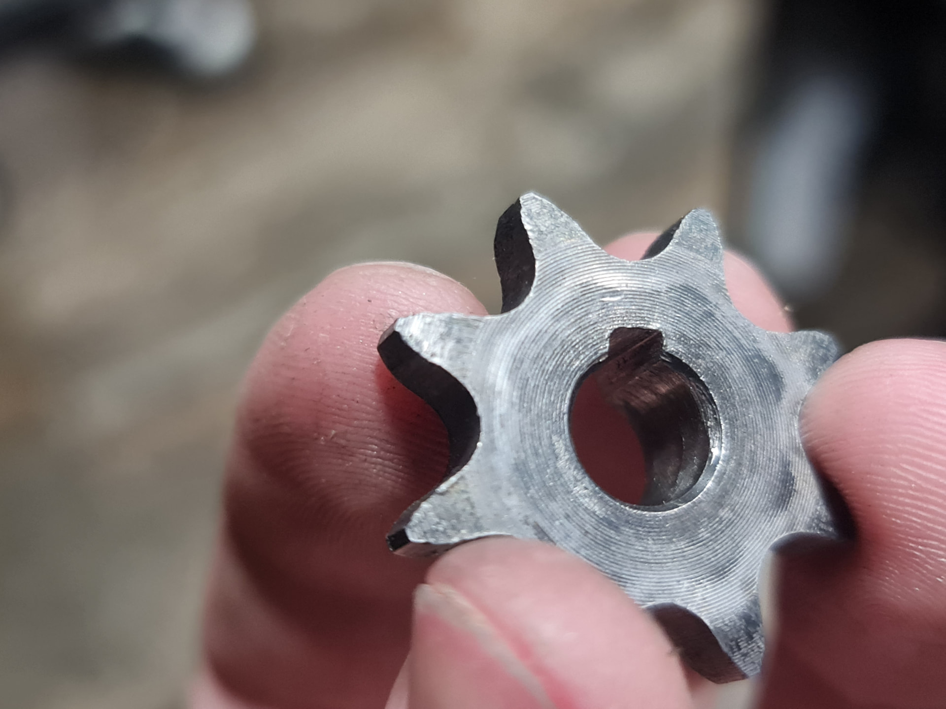

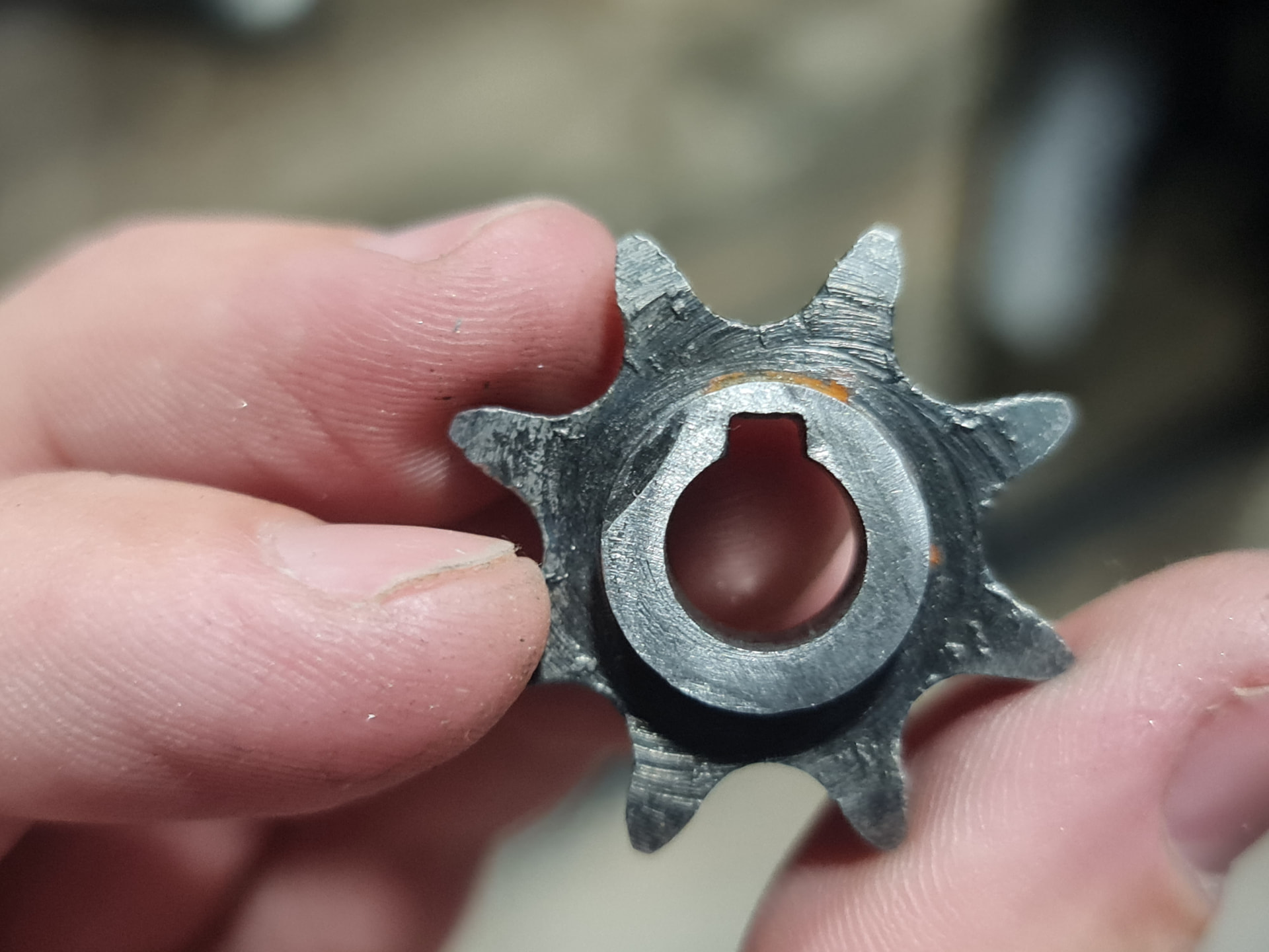

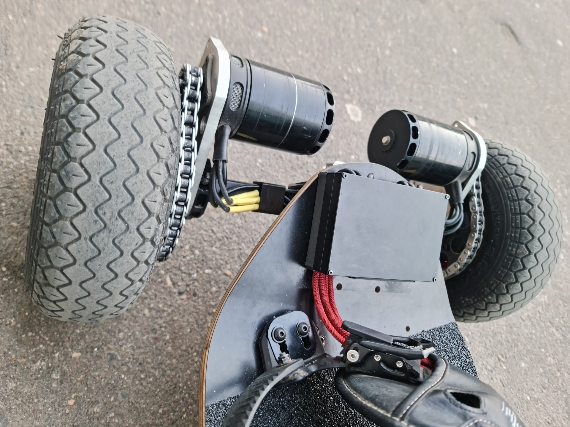

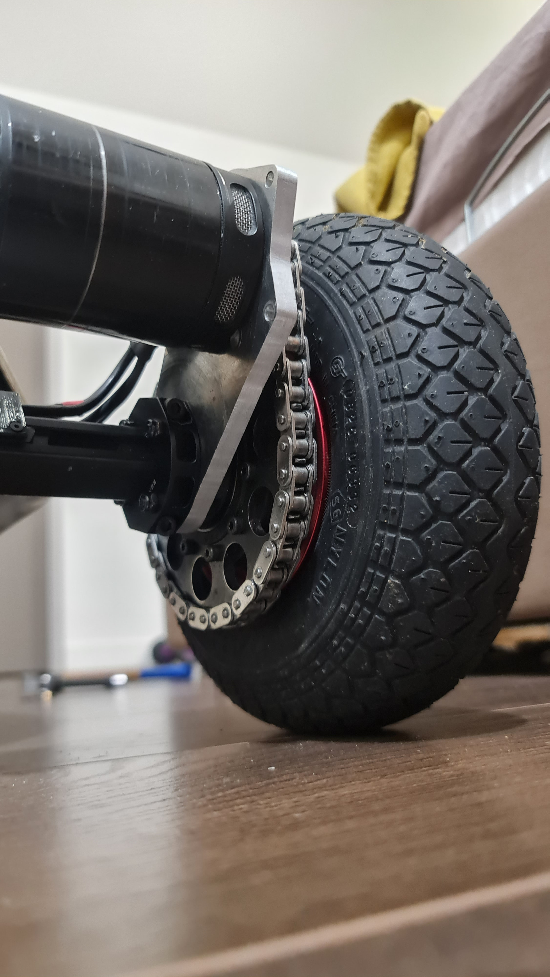

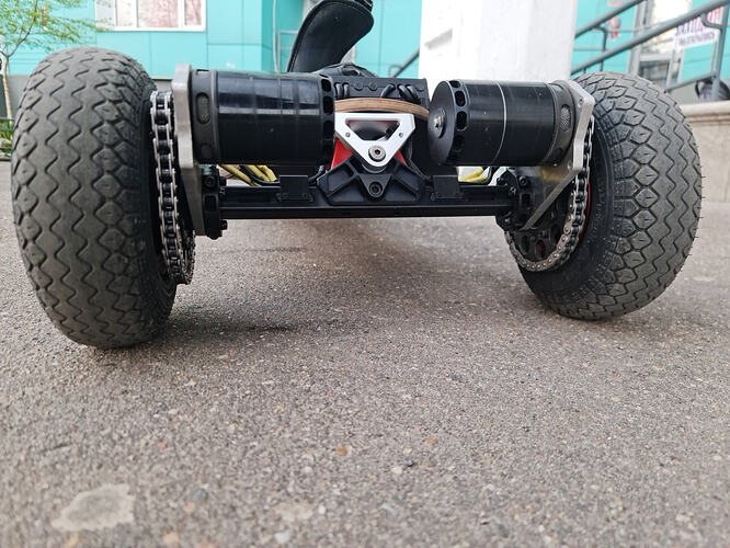

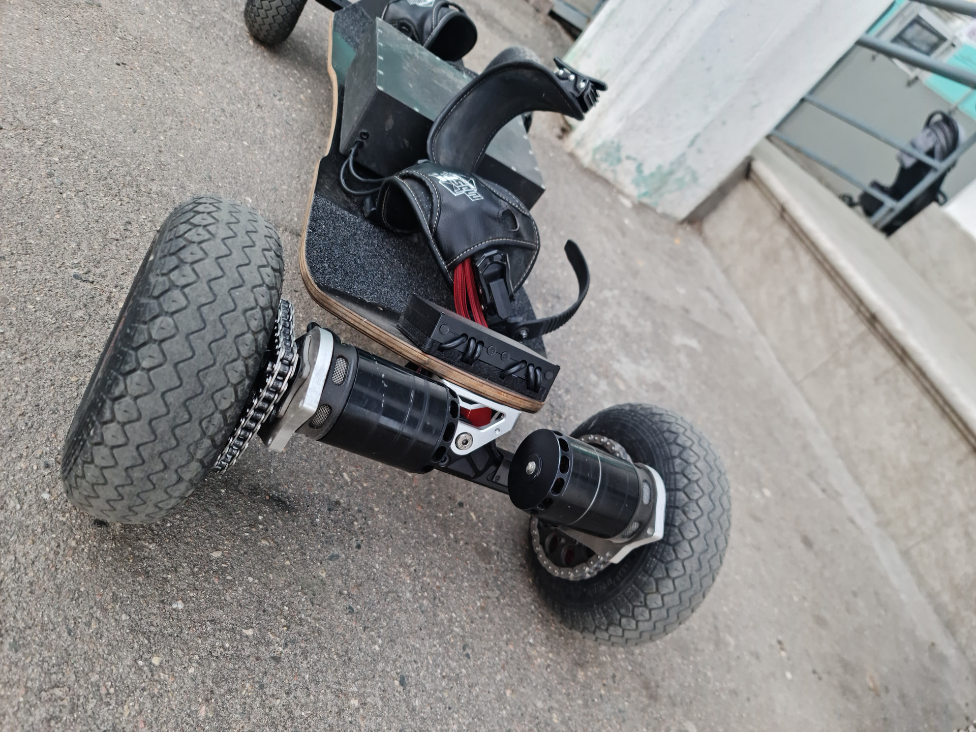

The process of creating a 06B DIY chain drive 5.0
I did it by hand with a file, I hate it):grinning_face::smiley::slightly_smiling_face::upside_down_face:

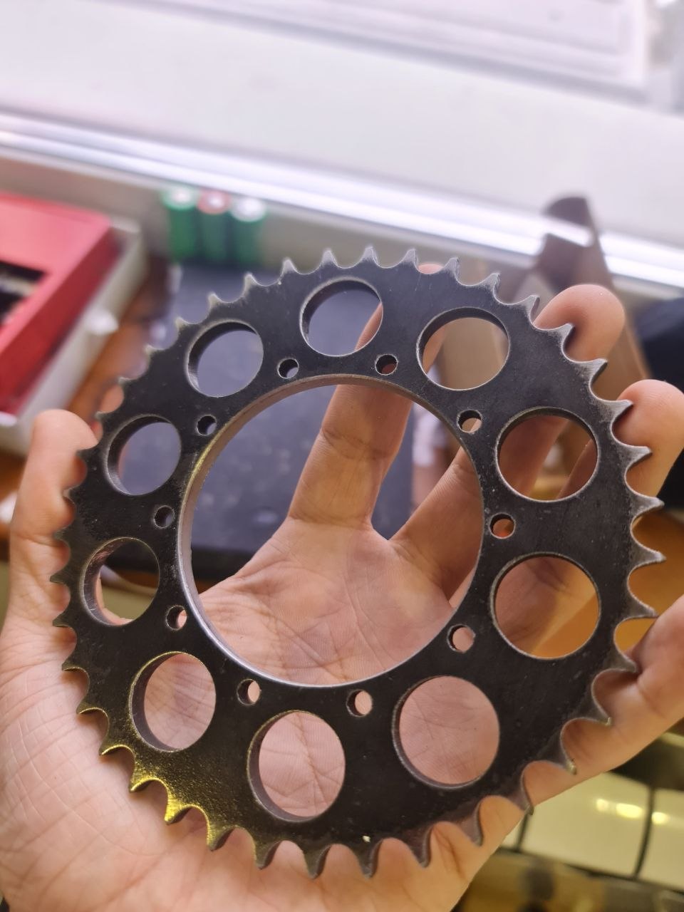

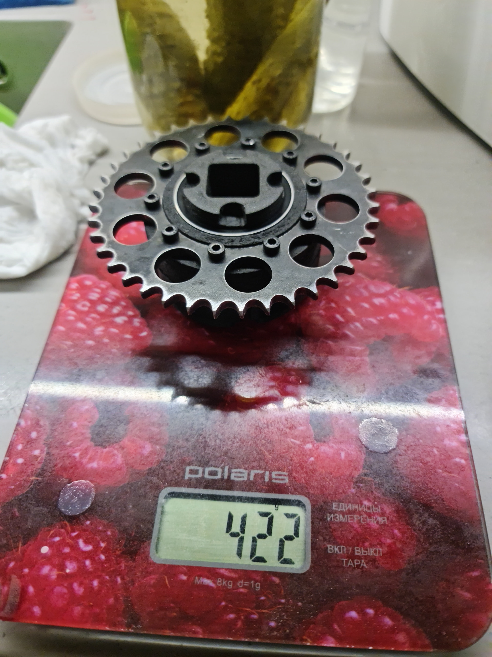

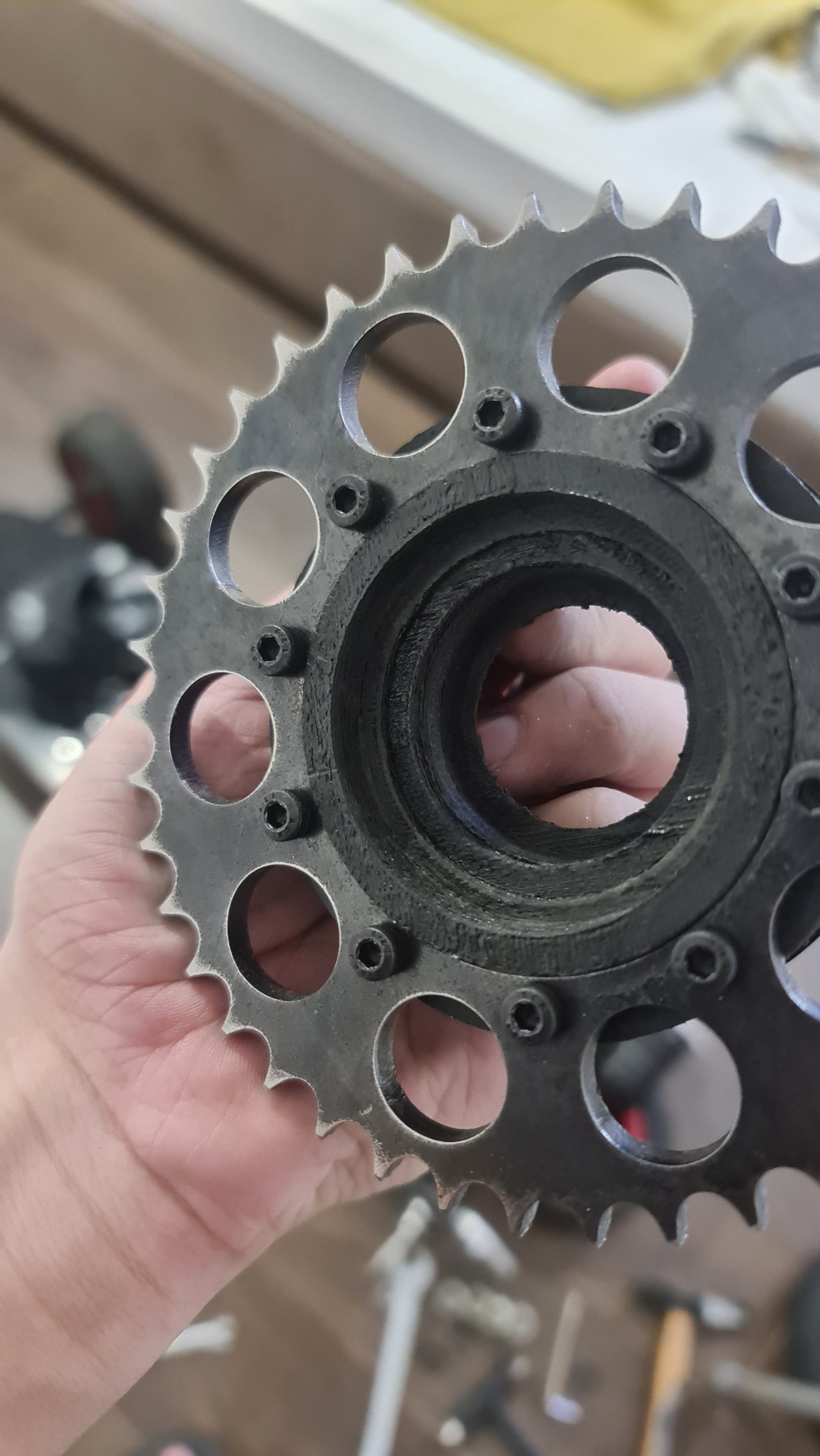

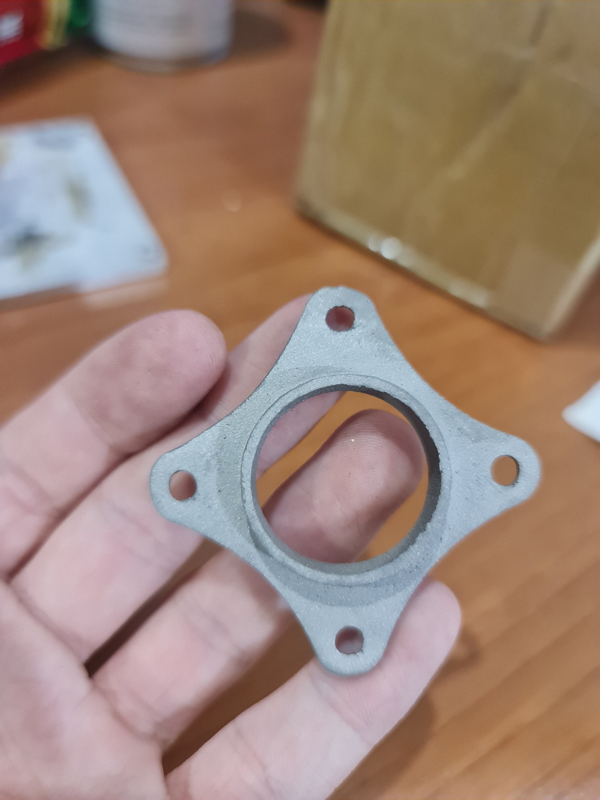

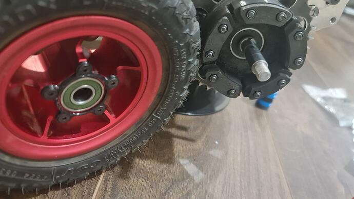

Where’d you get the big sprocket? Is it MBS pattern?

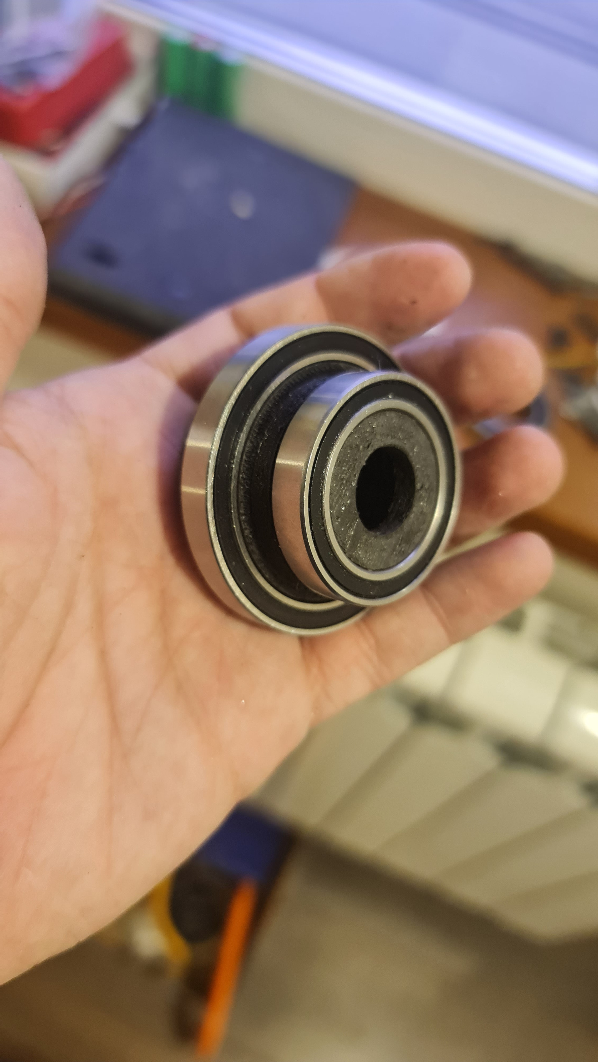

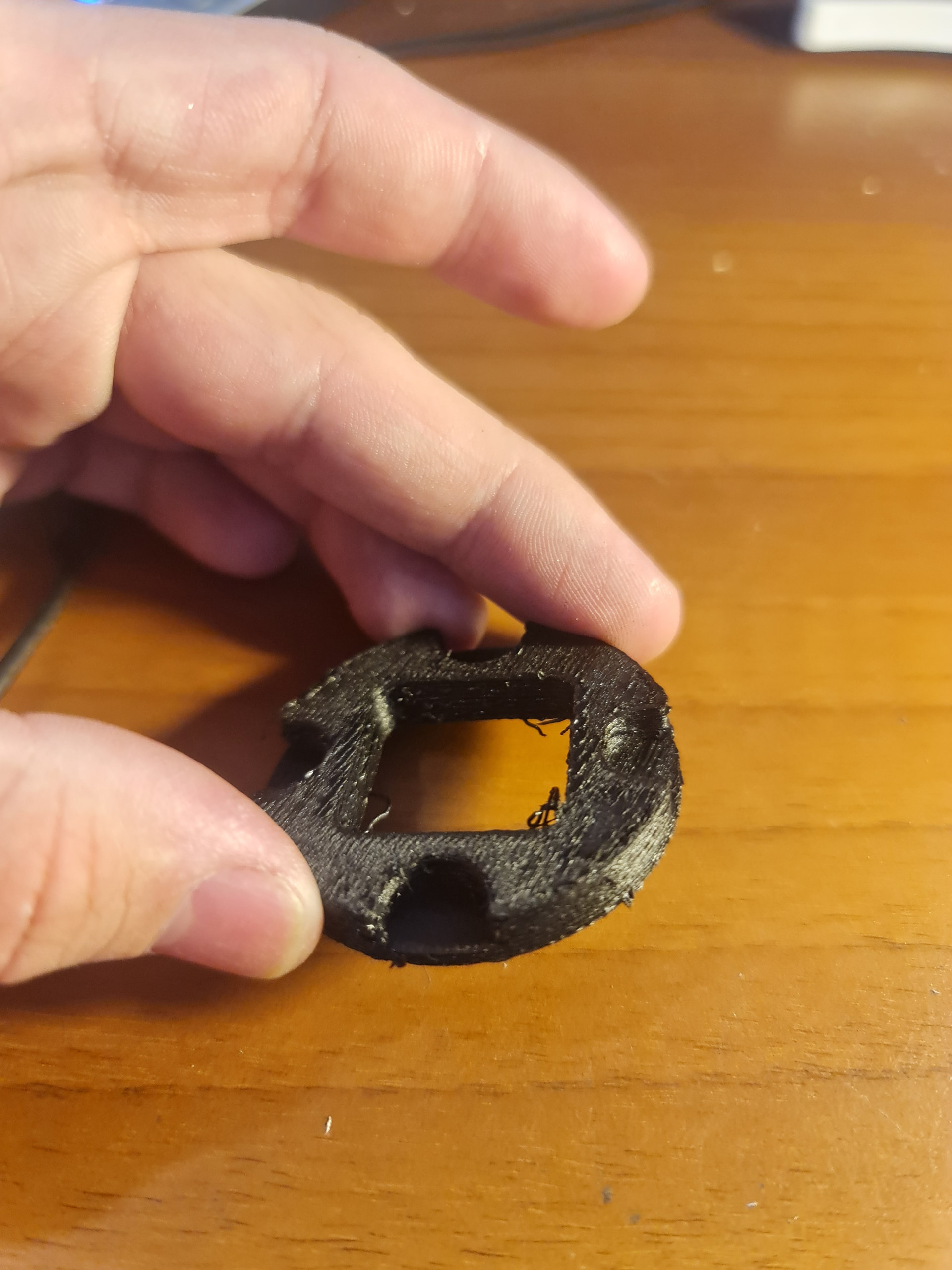

I had these large sprockets custom-made. They were originally supposed to be mounted on 6007 bearings. But it turns out the sprockets are wobbling up and down. I’ll try using smaller diameter bearings and making an offset hub to compensate. Yep its 06B, like mbs.

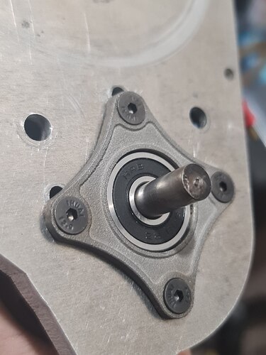

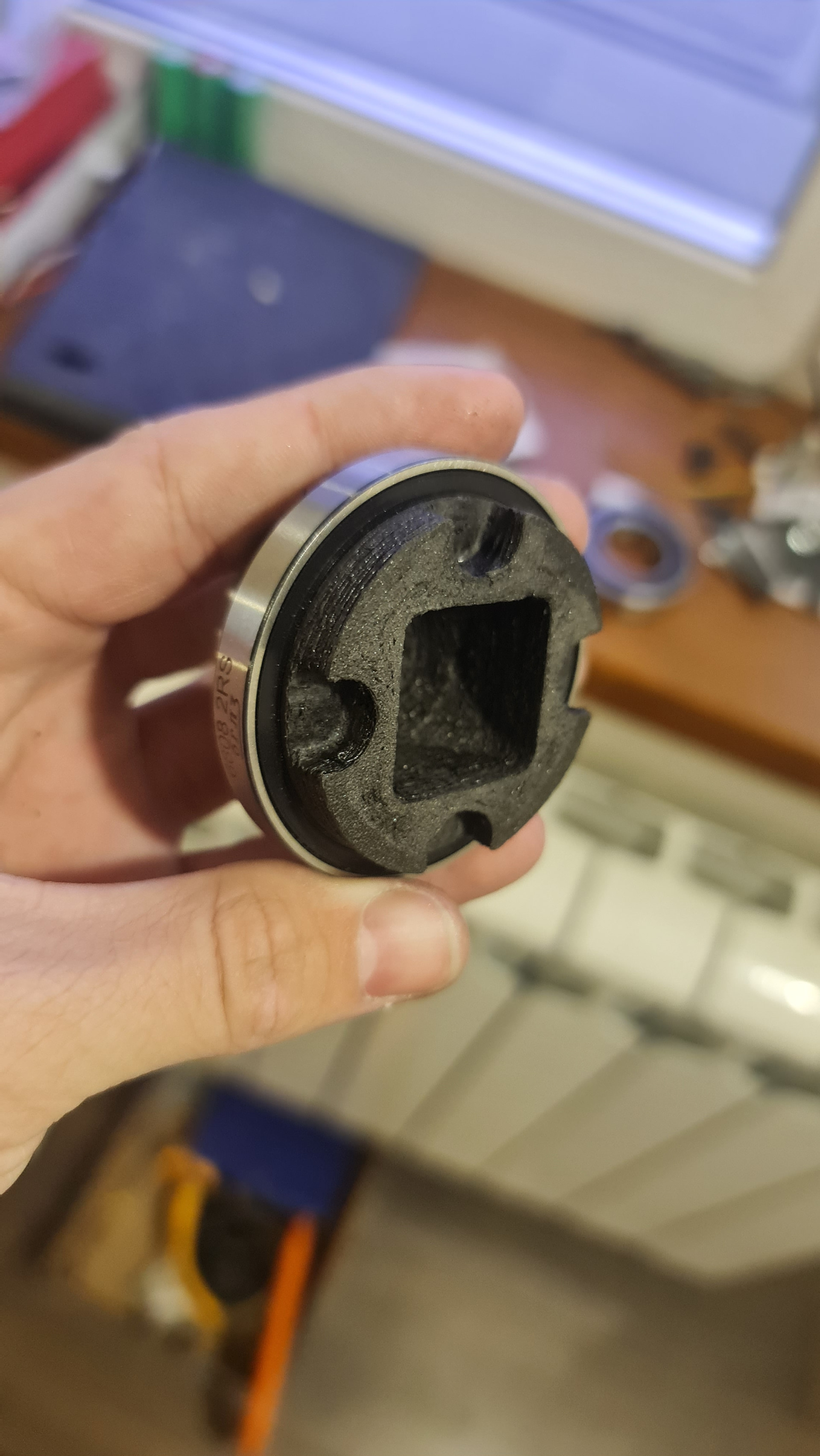

Fitting

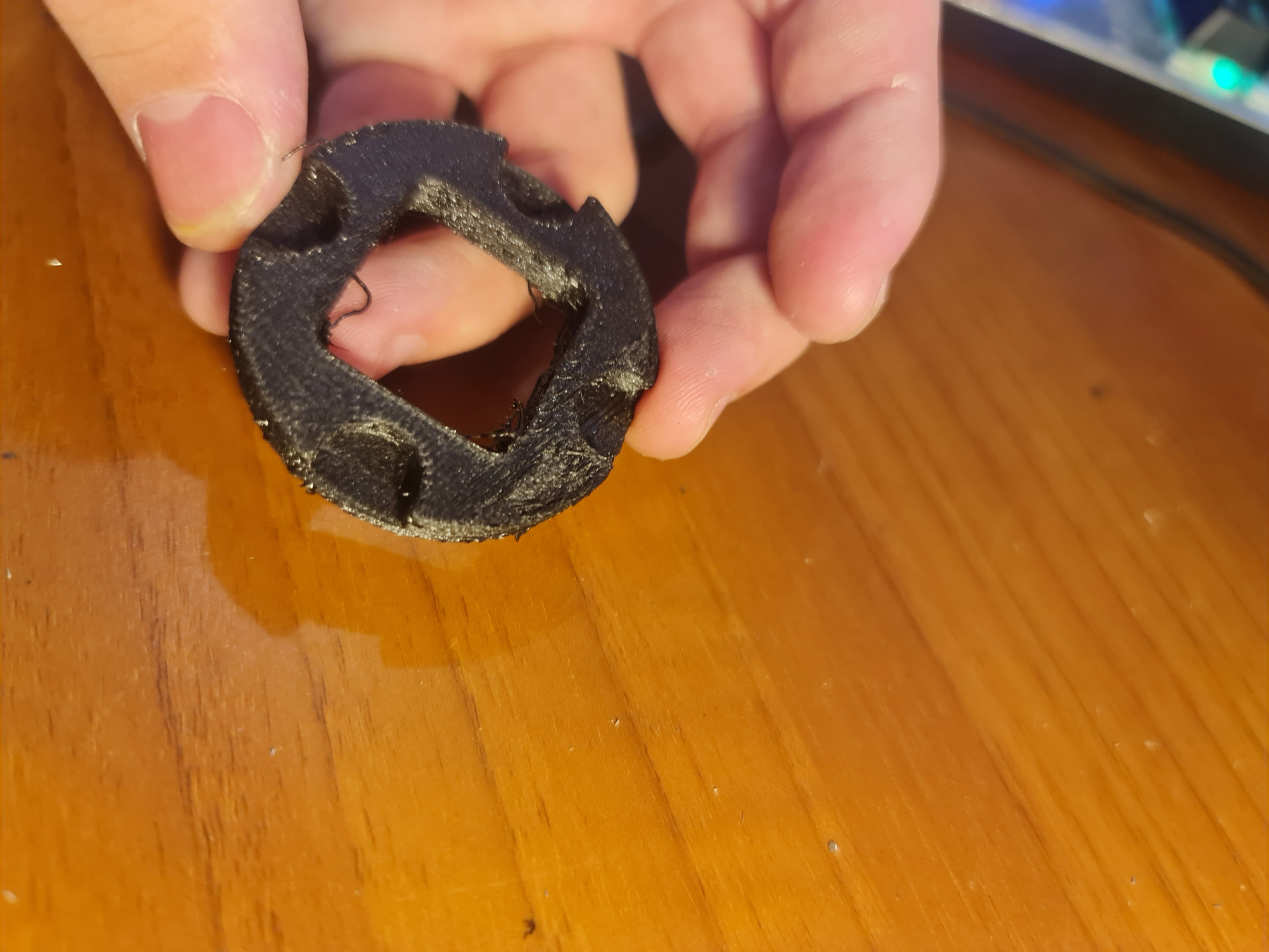

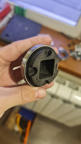

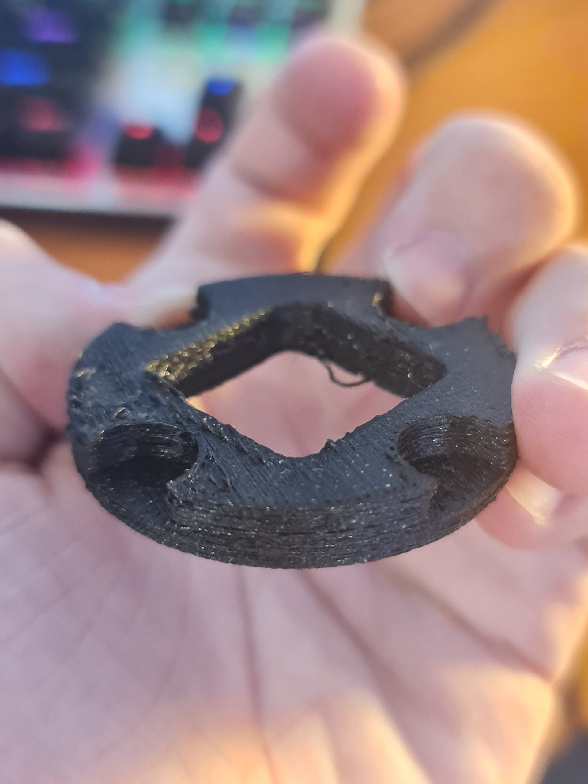

pa6-cf 30%…
