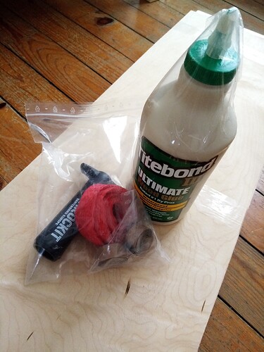

So I ordered a @Roarockit kit including a vacuum bag, a foam mold, some glue and enough plys to build the whole deck + enclosure
Using my 3D was really helpful to get the right dimensions and print technical plans
I then formed the foam to the desired concave and put the plys inside the vacuum press for a few hours
It was in the middle of the summer and temperature was high, so I think the glue dried too quicly and this was the first mistake (but we’ll talk about that later)
