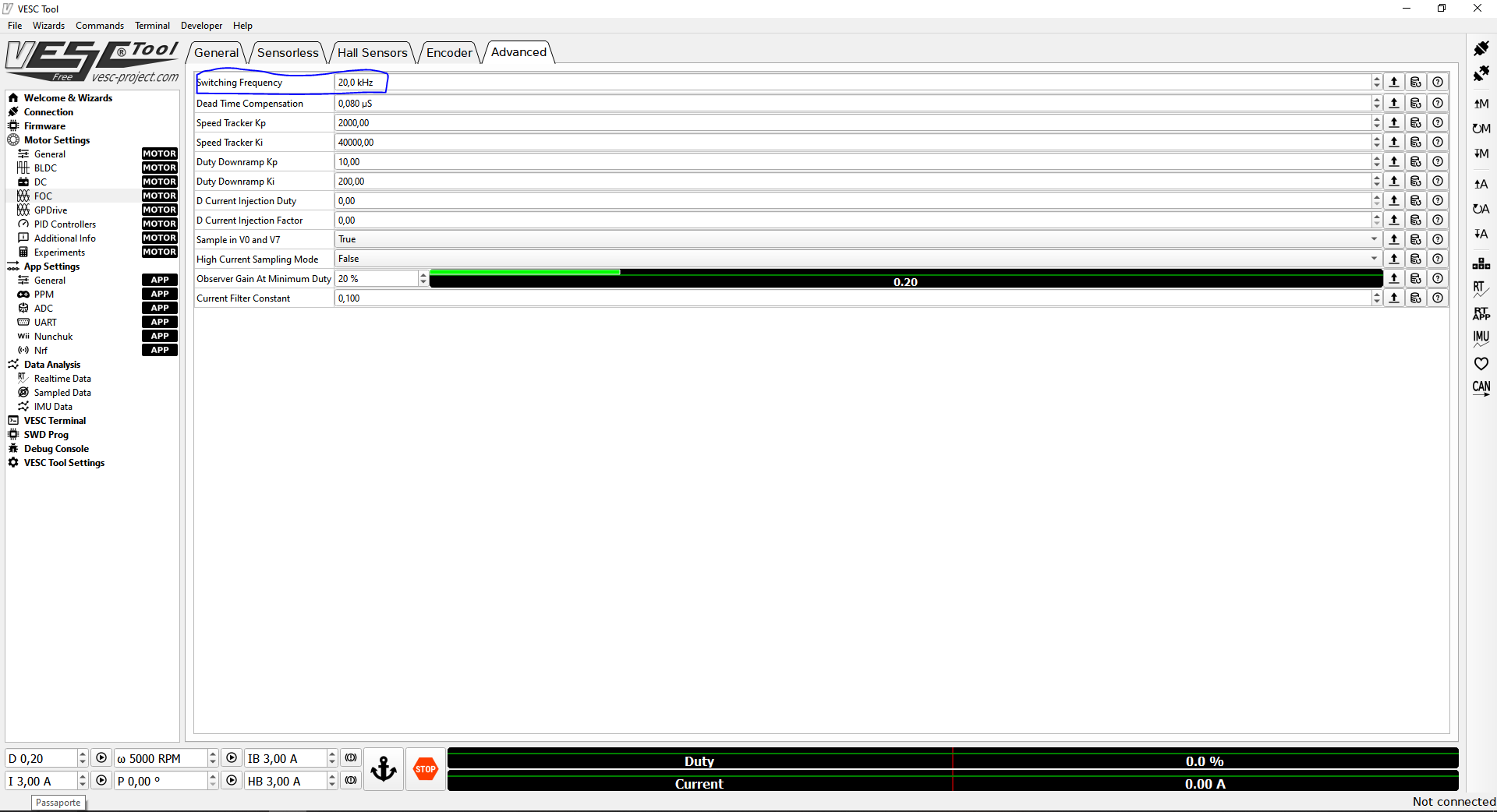

Boosted motor being driven in FOC, quietest one I have tried. Don’t count if you only heard it in a boosted board, they don’t run FOC
Also increasing the switching frequency is a must, the default is still audible for most people, I personally still hear it even at 25 kHz due to harmonics
Be careful though, you’re gonna make a dog’s ear bleed if you start running big motors hot and heavy with high switching frequency

Thanks for your reply! What is the switching frequency? How do you adjust that?
New ones are called ‘battle hardened’
It’s how fast the transistor inside the ESC operate, the default is 20 kHz, for me it is pretty audible, was almost the same as the BLDC mode of operation
No all hardware will work the same, on VESC 6 I know 25 kHz works without problem, but for example, on the StormCore 100D I couldn’t make it work higher than the default
