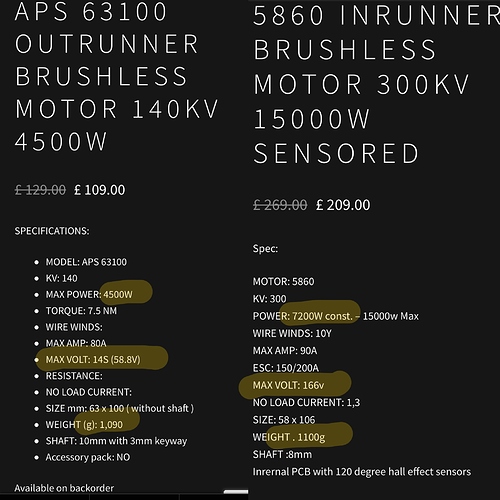

Can anyone knowledgeable comment on why inrunners generally can handle more amps?
For the same motor, if your Kv is higher the motor resistance is lower, so you can push more amps, inrunner generally have higher Kv’s
Also, for inrunner the windings have great thermal contact with the exterior, they can get rid of heat more easily
300kv for this inrunner is in the outrunner territory we (I) am used to. Mass is similar, yet Power is double.
So, the cooling benefits from the copper windings Placed on the cans (inrunner style) is mostly responsible for this?
I guess the amp ratings are similar too.
Yeah, the power rating of any motors means nothing
Motor heat loses are mostly due to cooper loss (winding resistance), and proportional to current², so if you keep the the amps constant and increase the voltage to make it spins faster, you increase the power since power is torque*speed
My bet on this ratings, since the inrunner has a smaller diameter rotor, the centripetal force is smaller and you can spin them faster to get this power rating
it doesn’t show the resistance compared. if the resistance is lower for the same kv its a better motor for doing the same job. with the inrunner having the airgap diameter (not thickness) being smaller it has less leverage and to still have such a low 300kv im guessing the windings must be many turns and thin to get the torque/inductance to compensate. either that or they have super magnets building the mag field strength in the gap
i think the amp limit of any motor should depend on the winding resistance and potential cooling alone.
And saturation of the core, no point pushing more amps if all its doing is just creating more heat instead of torque
yea that of course I forgot it being the more real limit.
