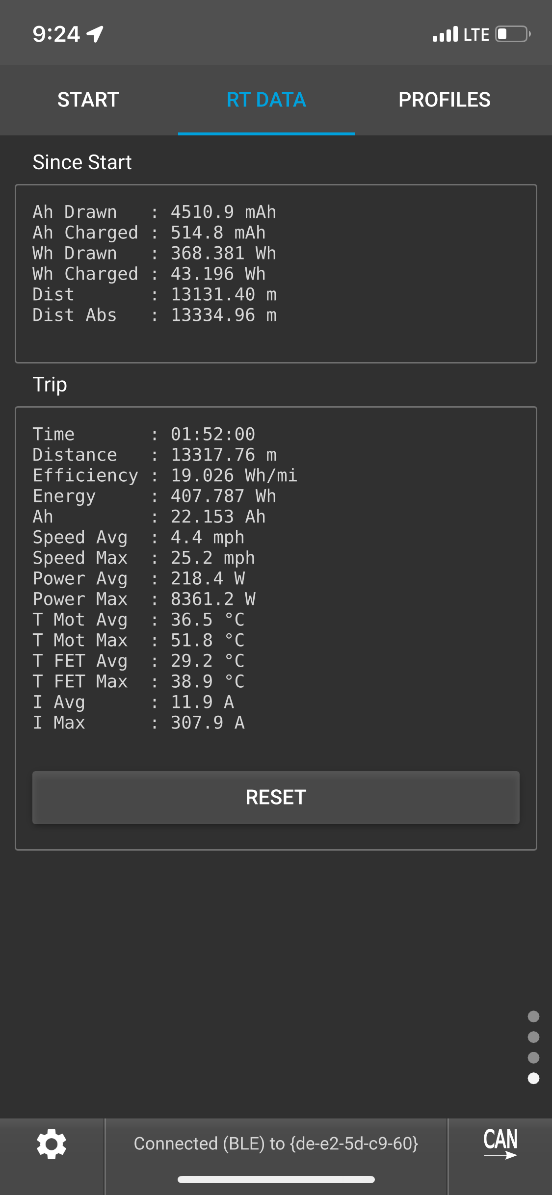

Here’s some videos of @poastoast absolutely sending it on 0-20 launches. My personal best was like 2.77s I think, so I’m not putting up any high scores on drag racing :rofl:
I don’t have logging on these runs but I pulled the vesc log. Over 8,000w
