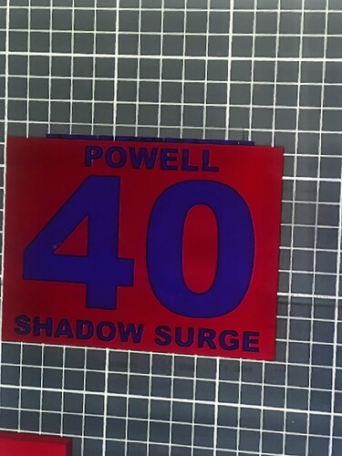

I designed and printed a box for the D100s esc to be mounted on the underside of the tail. Added some branding that would never be seen because why not.
