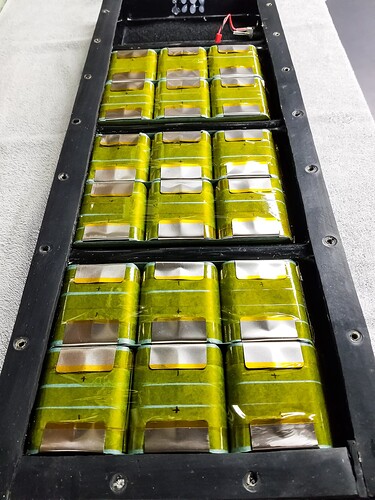

Getting the ION Drive boards completed finally gave me some breathing room to work on the ol’ Fluxy poo. It’s been on my wish list to upgrade the 12s 30Q battery that’s been in the Flux for 3 whole years. So buckle up kids… it’s battery build time!
The plan is for an 18s6p P42A pack, which is going to be a tight fit in the OG Flux enclosure. I decided to live on the edge and buy exactly 108 cells. Then grabbed some super nice pre-cut 6p staggered nickel from @mikebeard and got to work on some P groups:
Swaddled those P groups in some fish paper & kapton tape:
756 spot welds later… we finally have 18 whole P groups. It’s starting to feel like a real battery now.
I realized very quickly that the overhead was very limited between the top of the battery and the bottom of the deck. Not sure if the AT1 enclosure was designed for staggered 21700 cells or not, but I definitely didn’t want to make the gasket any thicker. I decided to use some copper braid for the series connections. Pre-tinned and shrink wrapped:
Yeah, that’s gonna be juuuust right:
Series connections done. 68v baby!
Now time for my favorite part of the build: mapping out the balance wires. I was forced to pre-sort since there isn’t enough overhead space for crossing over the balance wires. This is my preferred method anyway, since it looks so much more puuurty. It just takes a lot more planning when you are working with 19 balance leads.
Yeah boyeeeeee
Soo clean!

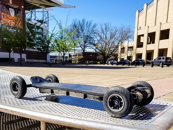

Back to esk8 stuff… I finally had a chance to take the 18s Flux out for it’s first ride. Wow, I am blown a way by this board. All of the individual component selections compliment each other so nicely.
The 8" CST tires are the most round and well balanced tires I’ve ever ridden. The Flux is meant for more meaty tires, and now they are absolutely required with the low ride height that the BN channel trucks offer.
18s power is intoxicating. I’ve been on 12s power for the last… I dunno… 6 years? My body is calibrated to lean back around the 30-33mph mark, which has historically been the previous top speed. I can sense my body positioning for the acceleration to end around that speed, yet this board just keeps pulling like a freight train. Such a weird feeling.
And wow… the Reacher motors on the 4GS drives sound so heavenly. I will commit to trying to put together a quick sound clip to try and show what this drive train sounds like.

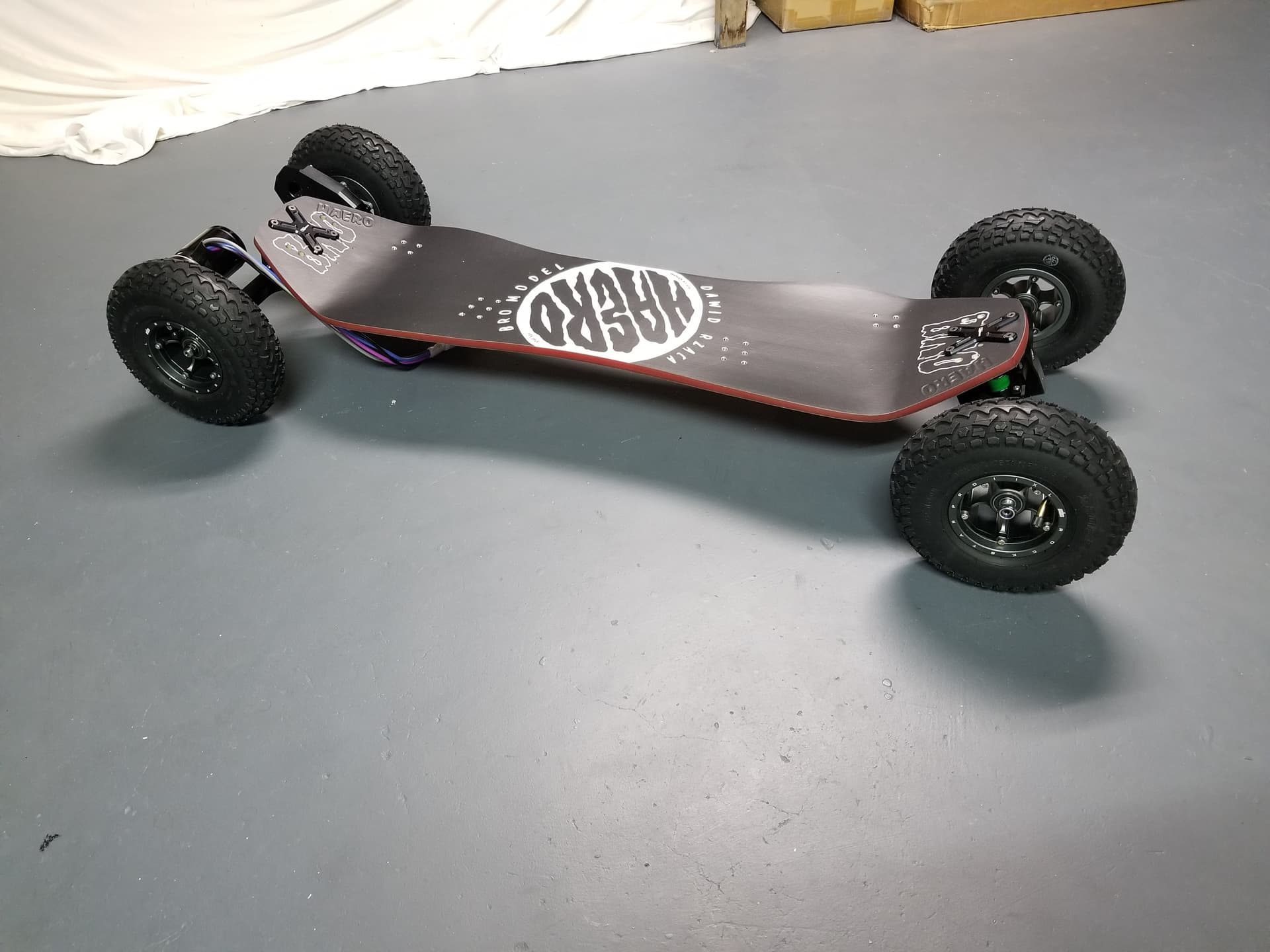

I literally justified an entire build just so I could try out these trucks. There wasn’t any kind of objective with this build, so I just slapped together all my favorite parts. I bought a Haero Bro and drilled another set of truck mounting holes to get this thing as low as possible.
I loved 7" tires until I tried 8". And I loved 8" tires until I tried 9". So yeah… this board was going to have big ol meats. Looking proper!

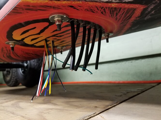

I then soldered up the phase wire leads & sensor wire extensions, and taped it up.

Okay… so here are my thoughts on the dualities. I left them loose, the way they are setup from Tito. I actually brought a wrench with me on the ride, thinking that I’d want to tighten them up once I started riding at a higher speed.
Slow speed carving felt great. The lean to turn ratio will take some getting used to. I was expecting more turn for the amount of lean that the trucks are capable of.
It wasn’t long into the ride before I was topping out the board. These trucks really shine at 30+ mph. I was shocked by how stable the board felt, considering how loose they are. I’ve never ridden a board that felt so stable. No slop or wandering. The board felt planted. It just went wherever I pointed the board.
No need to swap out the bushings. They are the absolute best of both worlds. Completely capable of both slow speed carving and high speed stability.
I even tried some full speed carving. I’ve never tried carving this hard at 30+ mph before. I usually only carve around 10-20mph, then when I get to 30-40+ I’m just focused 100% on keep the board straight. The stock angles on these trucks are great for faster speeds. I think this is where they shine.
Later on I tossed on a +5’ angled riser onto the front baseplate. Made a world of a difference. The turn to lean ratio is much more in line with what I’m used to.
Such an easy board to ride around. I’m a big fan of these trucks! Well worth the reason to build another board…
