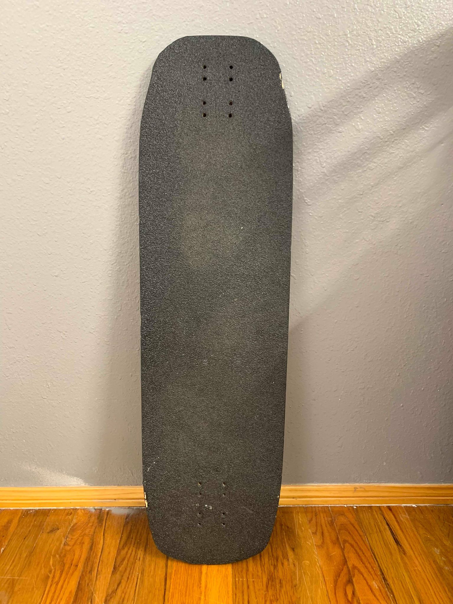

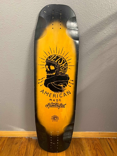

So for the build, I was lucky to pick up a Jet Potato Rocker 34.5 locally from Facebook for $50

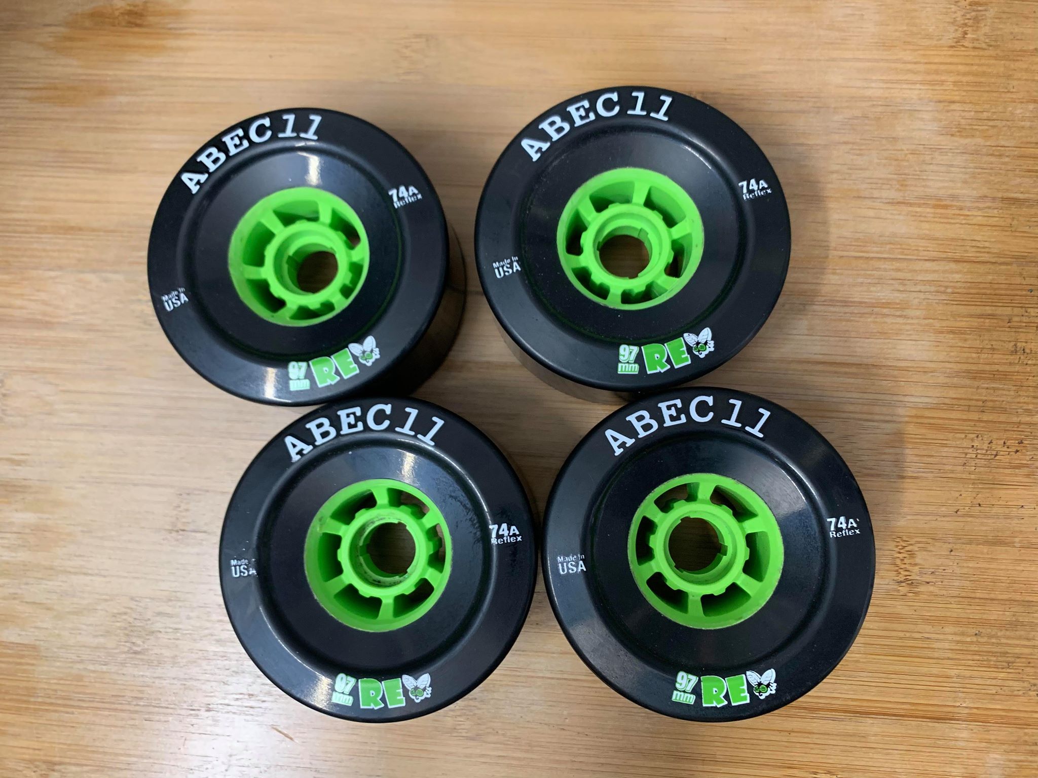

and some Abec Superfly 97 for $60.

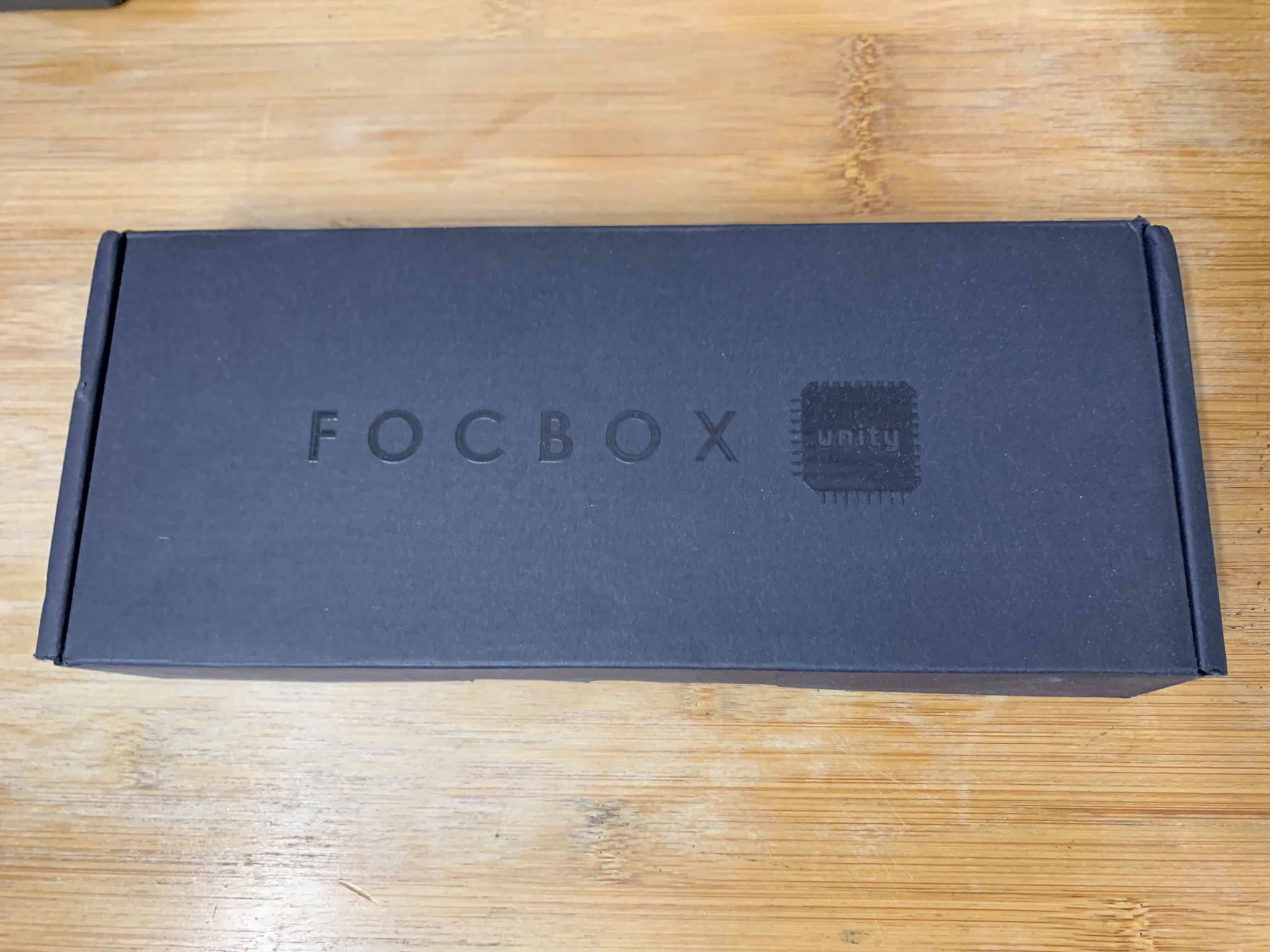

I also picked up a unity from the sale a couple months back for $200

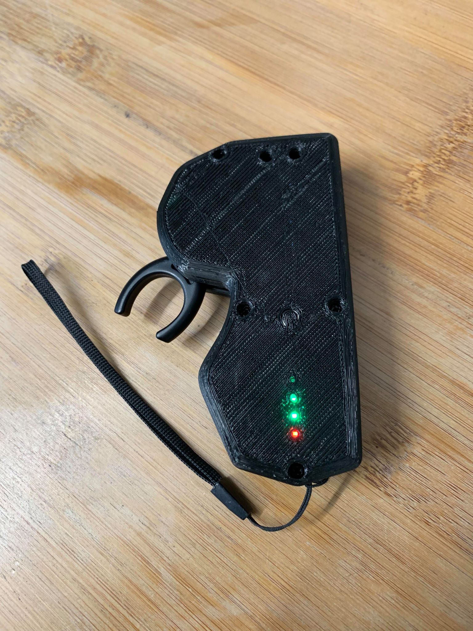

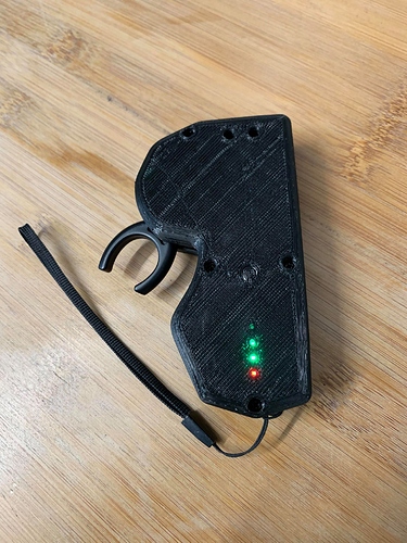

Avio remote that I made during the summer.

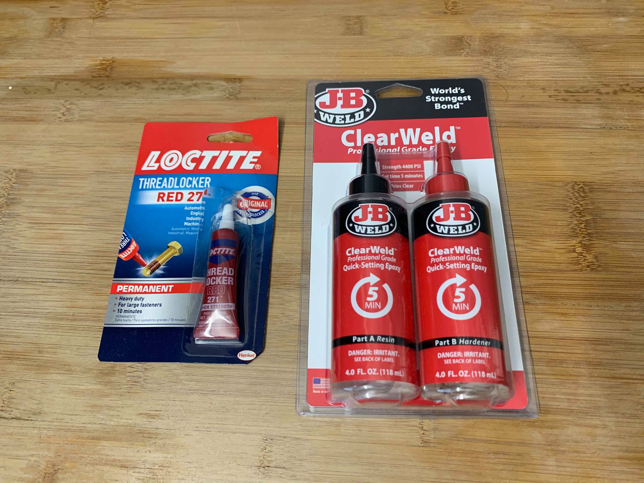

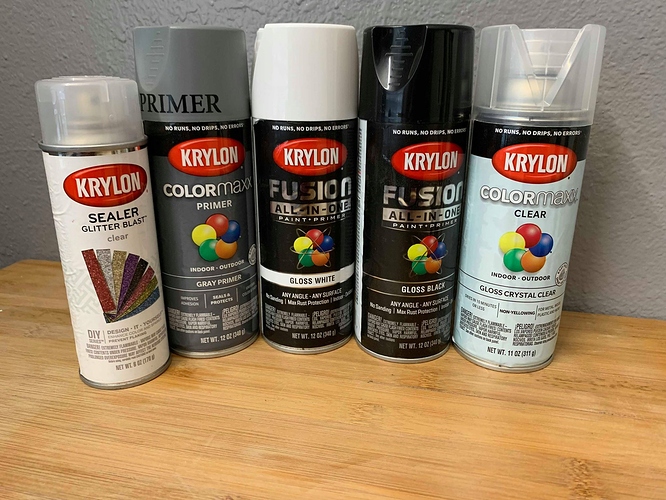

Some craft foam for making the enclosure mold and filberglass clothe, resin, and other stuff for making the enclosure.

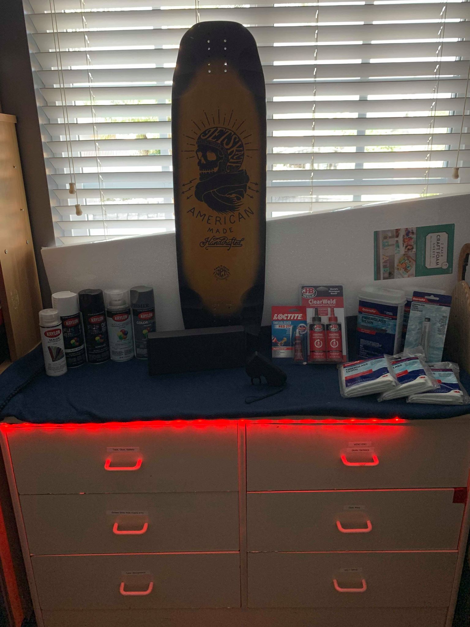

And this is mostly everything I have so far except the eloftys which are ordered through @murdomeek groupbuy, and the 12s4p battery.

Looking great! quite like the jet potato deck…
