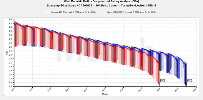

So here is the thing on the cells. I own like 700X of them I got super cheap from my past work in automation machine design. I agree with you a high power cell would be an improvement in peak power output from this setup and I plan on building a new pack if this isn’t powerful enough. The interesting thing about these cells is they will still “pulse” for short durations at 20A with reasonable sag. I’m not going to be continously drawing 140A from the batteries on a skateboard. Full throttle or full power draw is going to happen in bursts. This is why I feel these cells will do a decent job for me as a starting point. For example these cells would be terrible for a high climb as the sustained power draw would quickly overheat the cells and sag would limit power severely.
Compared to the 18650 30Q these hold up pretty well at 15A continuous:
You can see here that the cells don’t really overheat if drawn at 20A for short duration with breaks. I think this will be typical of my use.
Sag gets pretty bad at over 20A, but Samsung does rate these up to 35A for 10 seconds.
