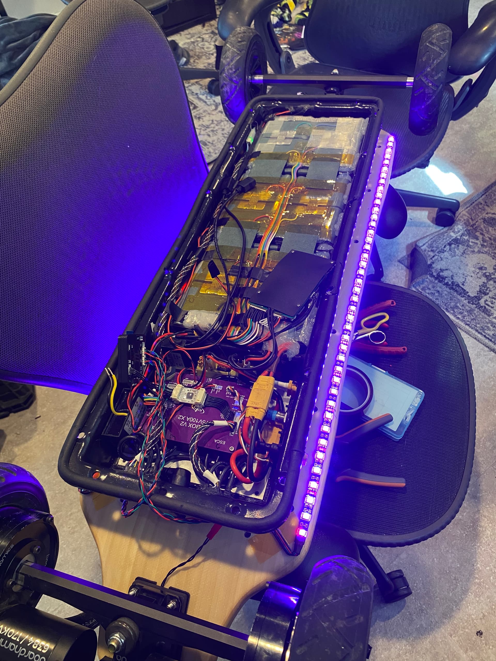

I want lights, shiny functional lights, break lights running lights. Ground effect lights. All the dam lights! This was part of why i chose the Ubox v2 75v/100a as I has an integrated 12v lighting power and control scheme via the uni remote.
Led strips I grabbed a maxkgo controller module to push the strips ages ago and it was time to use this… never worked out but I upgraded to a ttl and it has been better but my setup is buggy - more details later

Got a big ass heatsink and trimmed it up, too many heat problems on my hills so i want MASS. lots of thermal mass and surface area. went way overkill here but i like how it turned out. went to Heatsinksusa.com and snatched two of these bad boys for 20ish freedum labor exchange tokens and chopped it to size. should have been more careful with the depth of cut when i was roughing the flange and shortening the fins but nothing a lot of Dremel, fileting, sanding couldn’t fix up.
it turned out pretty good imho so not too bad. made a stencil from the finest cardboard from the trash can and trimmed a slot in the last bay to just about completely replace the bottom with aluminum. was able to keep the fit nice an tight and secured it with 6 taped M3 bolts and some liberal application of clear silicone as a gasket.
With a click and a grunt i got it fitted up and poped some holes for the motor connections while i was messing around… this was a bad idea. the holes are exactly over the mounting screws for the enclosure… i just wasn’t paying attention riding the endorphin high of getting the fitment of the heat sink so nice. that’s what rtv silicone is for!

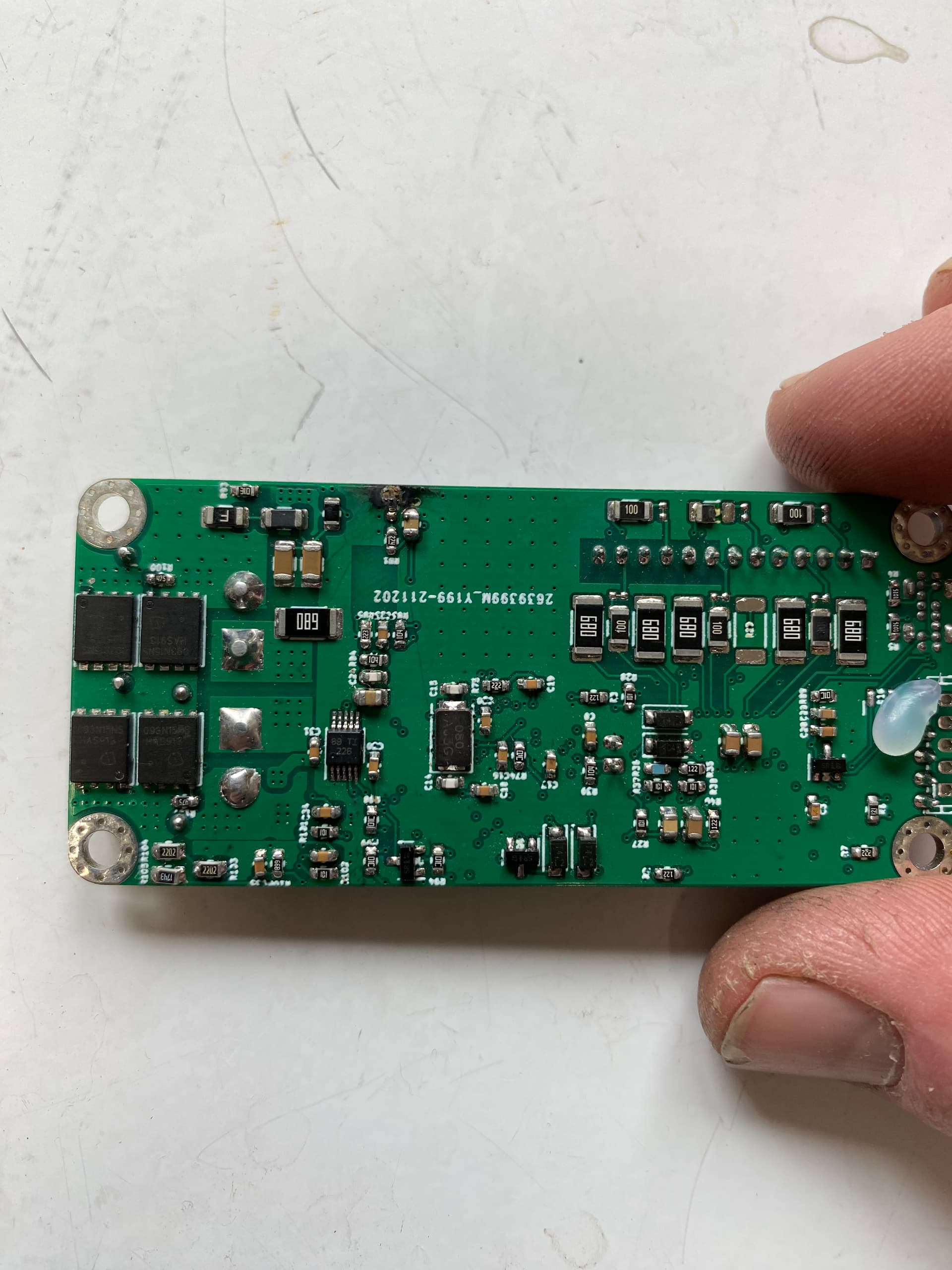

everything was going great until I drilled the holes for the heatsink, my ennoid xlite took a shit when i dropped some shavings on it bridging a component connection. Booooo not repairable but i had a spare. Yayyyyyy

it was acting so weird it had to be me, i must have broken something or got chips in the case or some shit. took it apart and it was so clean and fresh looking. not one thing wrong. went over the whole thing under magnification but anything beyond a visual inspection for complicated pcbs is outside of my wheelhouse.
