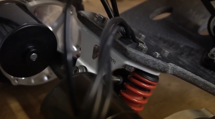

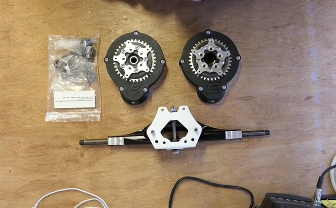

So I knew I wanted to go gear drive with this build, less maintenance and well, they are cool AF. So I went with a well proven system - The E-TOXX helical 5:1 trampa gear drive by @NoWind
I was really impressed with the kit, The gear drives come pre-assembled so you know how they go together and you get everything needed, including spare bolts and shugru to seal up the back plate on the inside of the truck
Installation was a breeze, I did it on the truck whilst it was off the board, takes about 30 mins per side.
And the results look impressive!
Motors are dual 6374 from Streetwing in the UK
