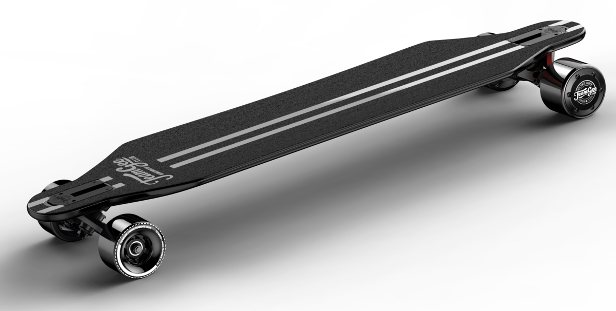

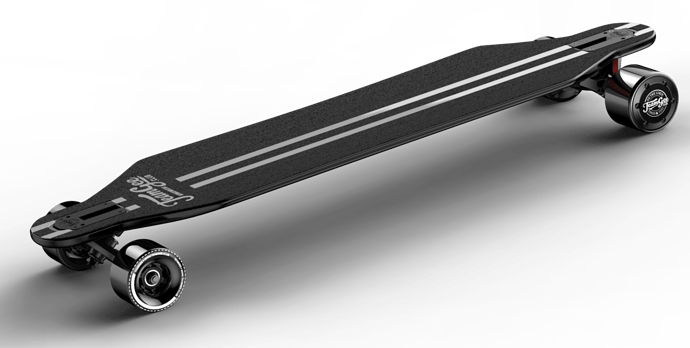

For 6kg we can offer you the TeamGee H5 if you like :slight_smile:

Actually that’s a good package on paper, if it didn’t lack power and range tho. Also remember I said 12kg is too much for me, I agree some people have no problem at all with it !
It depends what you expect from a 450€, 6kg ESK8 :smiley:
You get about 10-12km real world range and 25km/h-30km/h top speed with significant sag.
