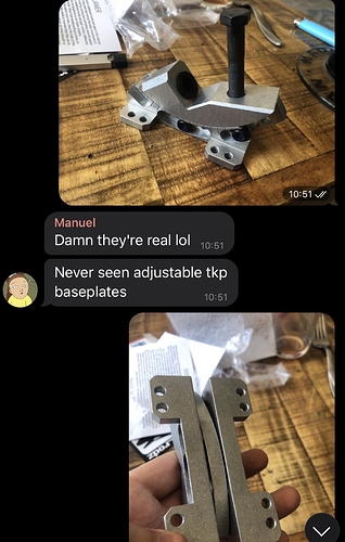

Got the first of two adjustable TKP baseplates from Surfrodz. Was planning to pick up adjustable baseplates from @rey8801 but missed the group buy and was looking for something stateside where possible. Let me start off by saying the pics of @rey8801s adjustable TKP plates suggest they’re a better design but I’ve never worked with them. At $75 ea, SR was slightly more expensive as well. Get reys
Recently, surfrodz updated these were in stock. They have been present on their website for sometime, but listed out of stock.
(Also to note, some email exchange with SR revealed that they are discontinuing colors for most trucks and will focus on black and silver with limited runs of single colors from here out). The website had very little info about them and I haven’t been able to find a single photo or user experience about them here. They were like this fucking mystery that no one ever talked about.
So when they arrived, I was pretty excited. Especially since I had no idea what to expect… @ThermalChild said it best :exploding_head:… they’re reeaaaaalllll!!!
So the SR TKP are a three piece design. There are two cross bolts that hold the center portion with the pivot cup and kingpin together with two separate baseplates that come together and mount to the deck. They are not adjustable without removing on drop through setups, but would be of top mounted.
The baseplates included a kingpin bolt but not a bushing washer. Currently the bolt is 82* to the baseplate so I have a feeling I have some work to do. What’s the reference to measure kingpin angle single the pivot cup and bolt are not aligned?
I measured the baseplate to pivot cup angle at 42* on the stock. Have the adjustable at 35 currently.
Also, the ride height increased by approximately 17mm but may he position dependent

@bwahl602, any issues with the threaded insert for kingpin on those? Does kingpin thread in smoothly?
Just received some and the insert looks a bit damaged (Straight out of the box) and kingpin bolt is pretty stiff to thread past the deformed part.
I have hit SZ up and will see what they say about it.
I will say kingpins that end at threads are not the greatest idea. It’s why most trucks have pressed bolts with extra long shoulders. Lot of repeated stress on the end of kingpin/beginning of baseplate. Not a place where u want threads. Just my 3 cents
I had a bit of a booger we area as well. It threads fine but definitely has some resistance about the depth yours does. Keeps it from falling out :rofl:
Agreed @boardnamics. I’d prefer a captured lock nut position
And why put in an insert aswell :thinking:
Because threads in aluminum sorta suck so they put helicoils in all their threads in hopes of increasing their useful life cycles
Yeah… Im not fond of that, prefer a good thread in aluminum then prob (with these forces rather not like you said)
its a restriction in the three piece design, theres no way they could have done bolt through.
Ideal no, availability is key.
