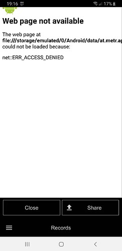

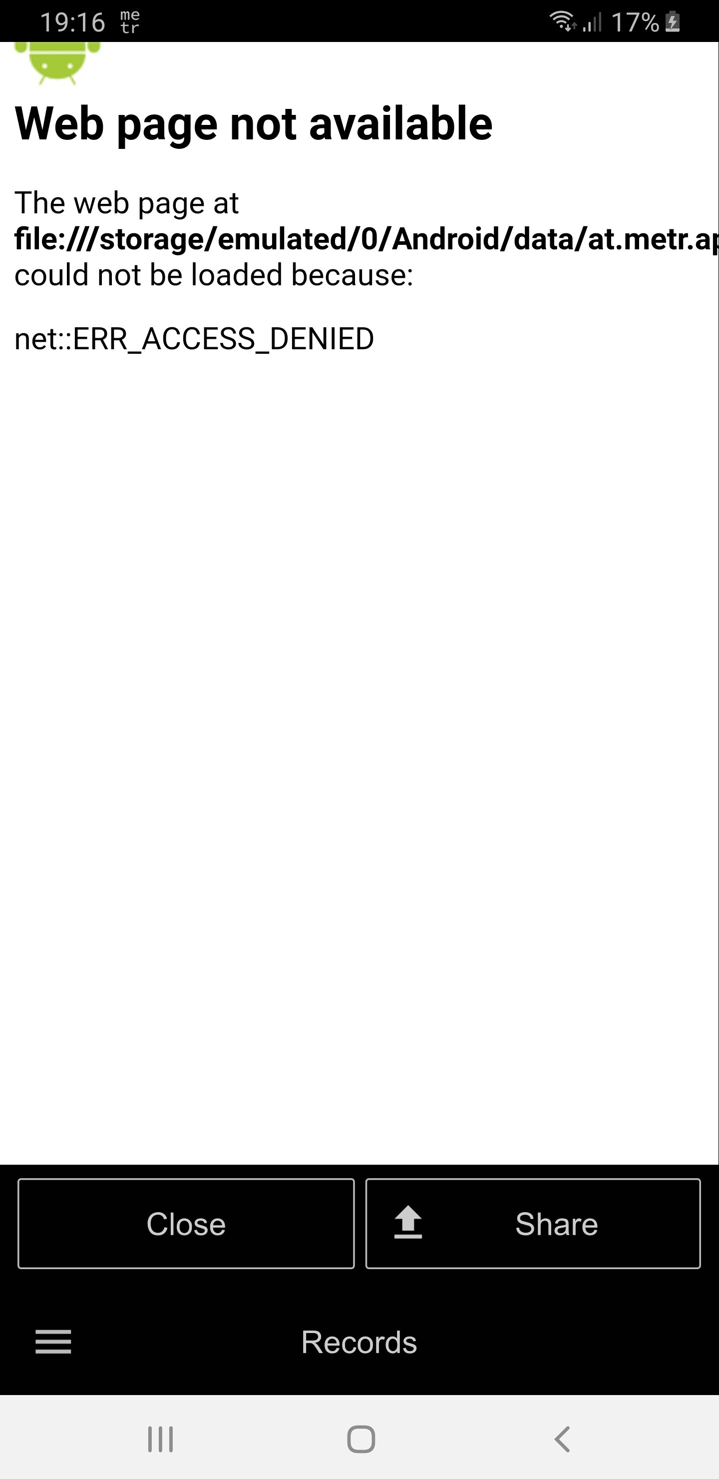

Any idea why I’m getting an error accessing all my records please? They worked fine before… Temporary glitch?
Please go to Play Store and update to v4.10.9 and try again :pray:

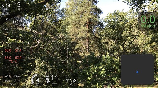

Now that’s exciting stuff, man. That’s like replay Shangri-La. Will it also be possible to bring up the full telemetry trace alongside the video?
Yeeeeeeeessss!!! Now this is cool! I hope you make it work with 4wd aswell!
It will be possible to bring up anything that is available right now on the Realtime tab. Including 4WD, yes :slight_smile:
Nice! But not the timeline-plot (yet)? :grimacing:
Wait, this is done on the phone? No more messing with Virb?
I need some ideas like that. What overlay would you like to see?
Realtime timeline plot? For how long? What values?
@Pedrodemio yes everything will be done on the phone, in real time.

@rpasichnyk I tested the legacy overlay app today and it didn’t work for me. Is it possible it no longer works with the latest logs? The Garmin VIRB Edit is very fancy but the choice of overlay values is limited. I’d like to see my current / braking current to be able to analyze where I accelerated and where I braked on the T-race track.
