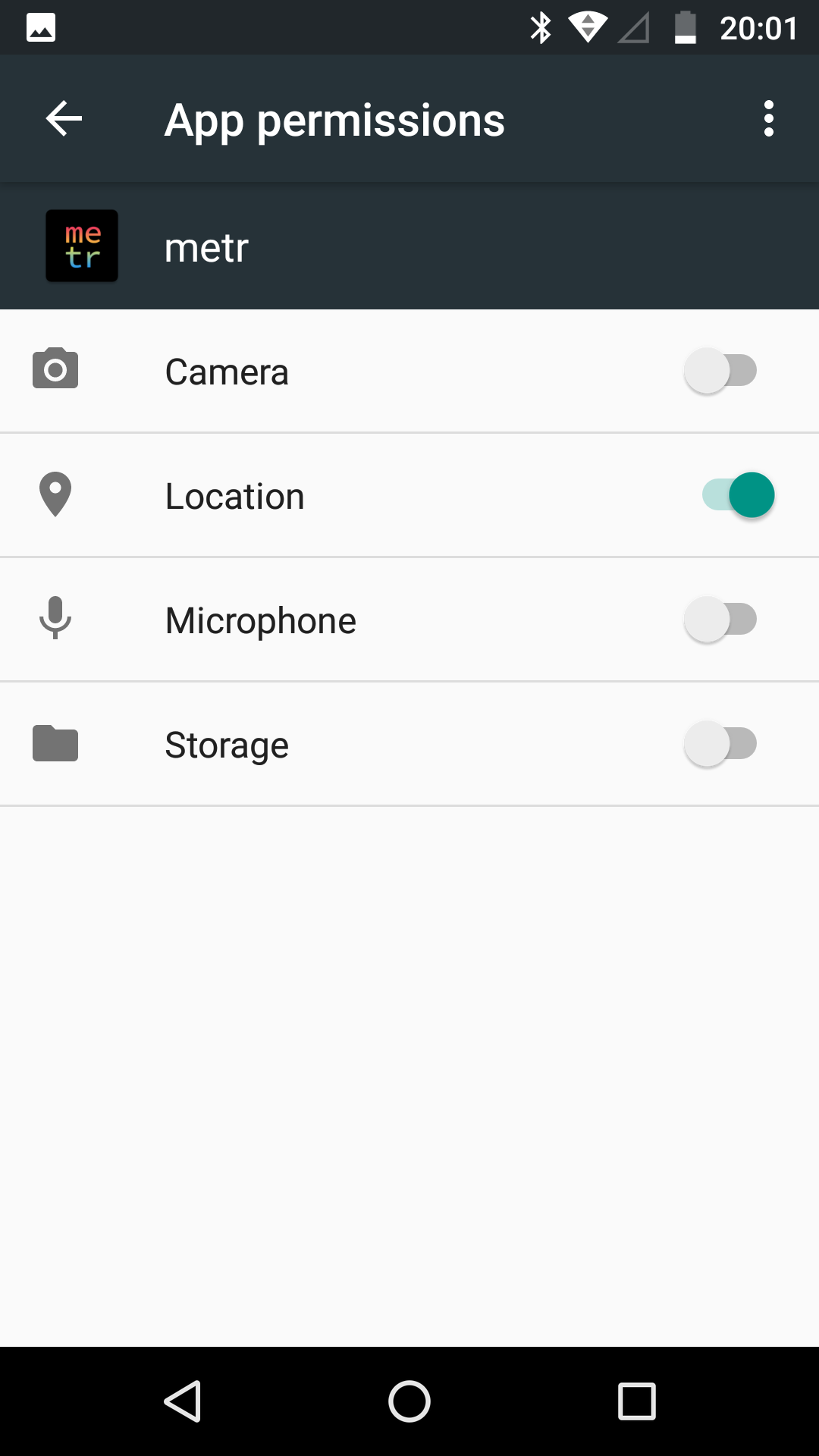

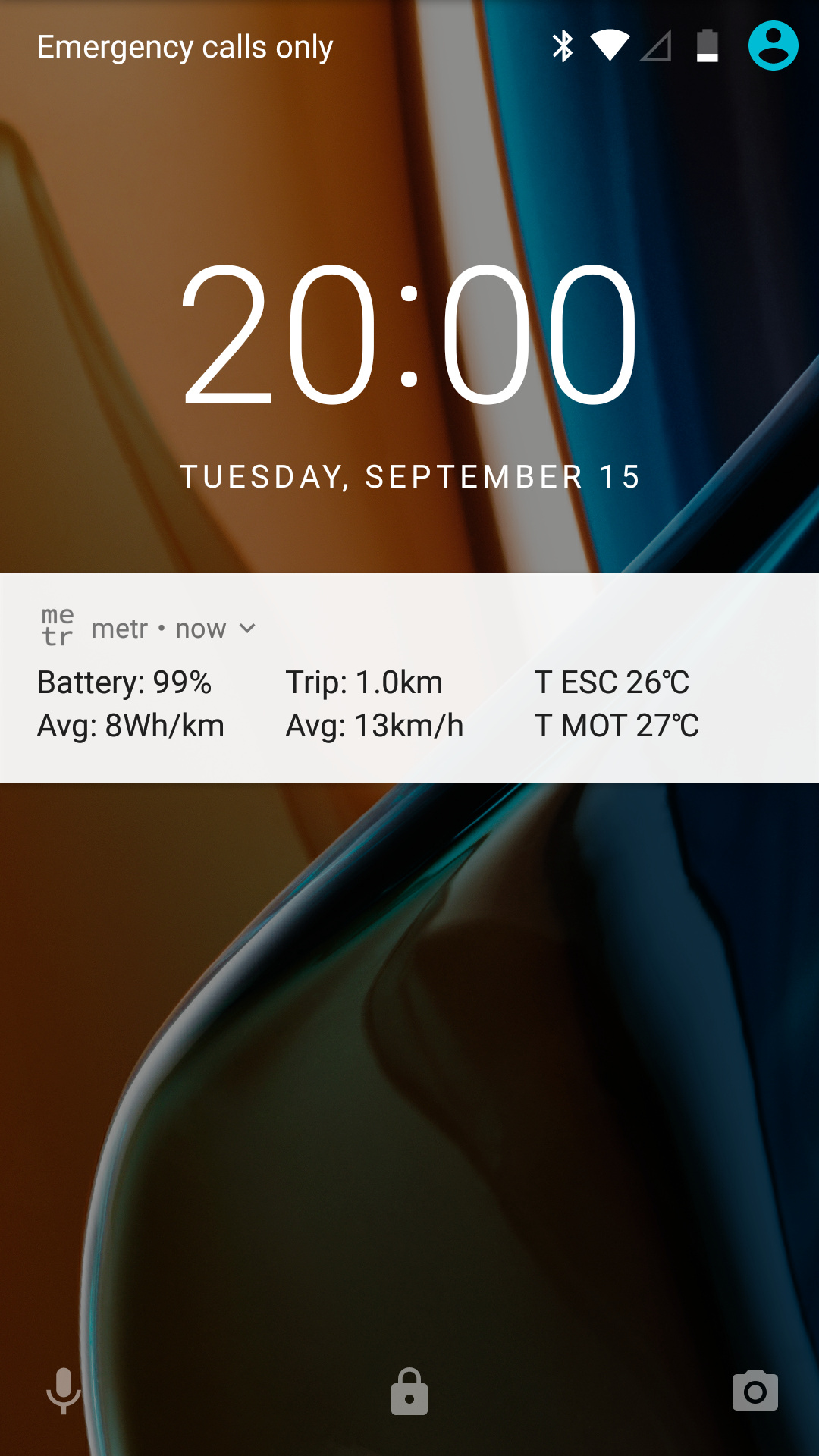

I just checked with my 7.0 and location is recorded, no issues. Check that you have
  1. Location ON / High accuracy in System settings
  1. Location permission
  1. Notifications are enabled
  1. You have this notification on the lock-screen when the app is running
  1. Metr app -> Settings -> Location -> GPS Accuracy -> 0
Ok, the only thing that could be messing was my 'hide sensitive notification on lock screen" setting, i dehactivated it and will try tomorrow.
Do you use the notification always on display as a way to force the refresh of the location ?
That’s weird as the fact than the content is hidden should not prevent the notification to be recognised by the system.
Try it :+1: Foreground service is required for background location access. That notification and foreground service is kind of the same thing.
That-s what i thought.
Although when i used to work with DJI api, they had a function to use the locatiok even when in background if i’m not mistaken.
Worth digging there
Edit : thanks for your super quick answers
That is awesome, thank you so much Roman

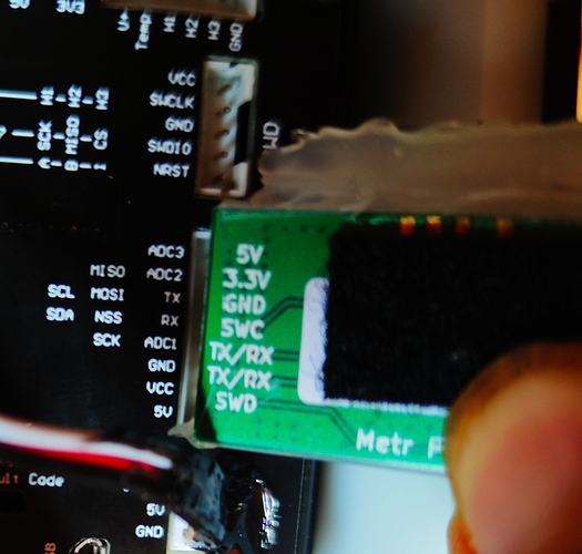

~How does one wire up an ESCape?~
How to wire METR to an ESCape?
okay, found the Answer!
  • 5v>5v
  • 3.3v>VCC
  • GND>GND
  • SWC>ADC1
  • TX/RX>RX
  • TX/RX>TX
  • SWD>ADC2
so it’s just the reverse basically.
Thanks @abusfullofnuns

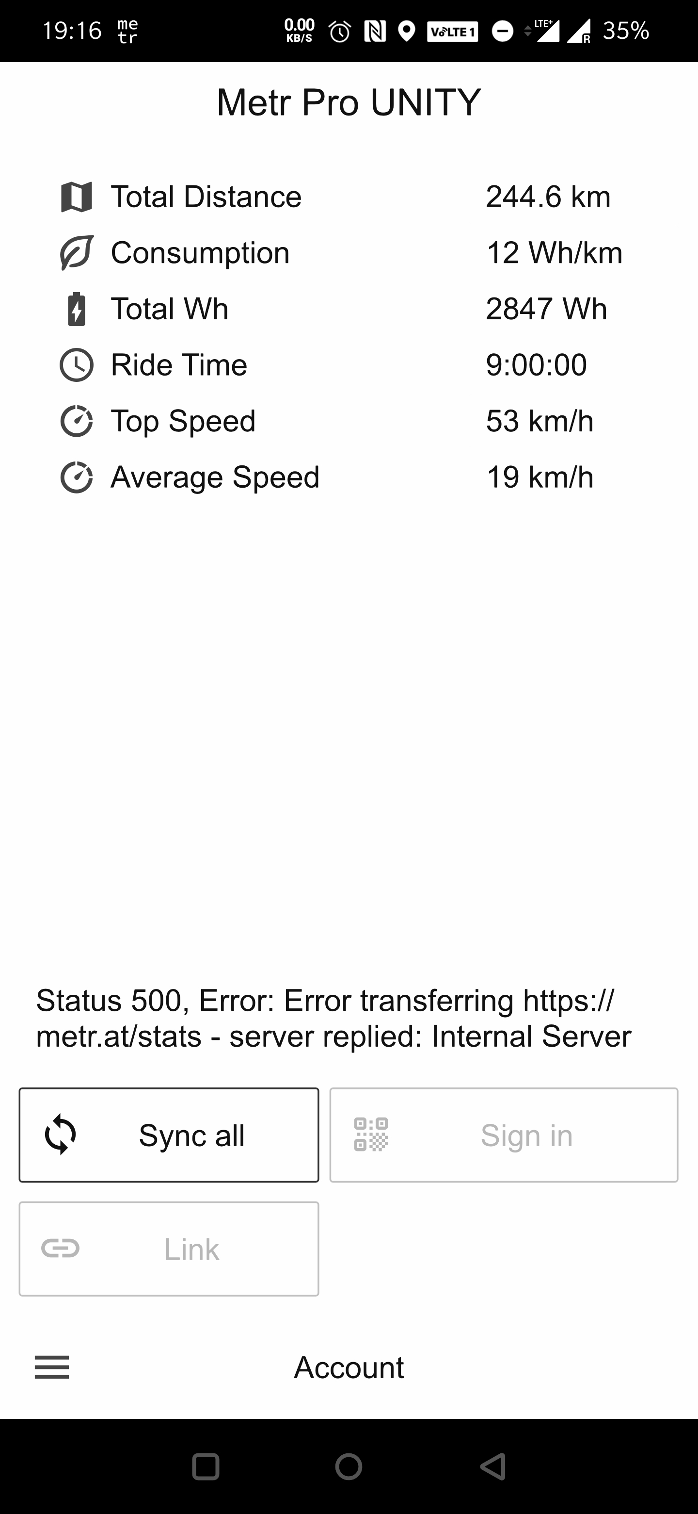

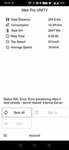

I am getting an internal server error when trying to sync all. Sign in does not seem to work either (in screenshot its greyed but when I connect to board, I can click it but it does not do anything, or gives server error). Any ideas? Internet connection is ok.
Can you try again, I restarted the server. If it still doesn’t work, please send logs from Settings -> Show Logs to support@metr.at
That seems to have done the trick, thanks! Works great now.

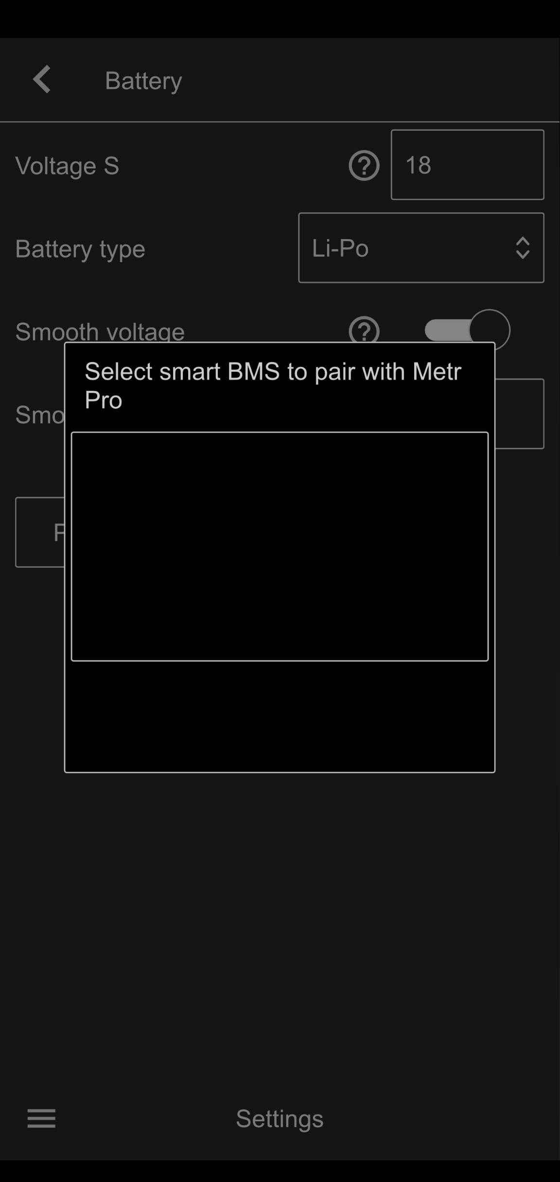

Does it support password/pin protected LLT BMS?
Let me know if it doesn’t. Update should be out soon. Metr app v4.6.0
woohooooo
Roman -how do you show individual cell voltages without a charger being connected?
When I search I don’t get any results despite having an 18s LLT in my board and a few other 12s ones in my garage.
They don’t have the default Bluetooth name, could this be why they don’t show up?
I mean were you able to update the app already? There’s no update in Google Play that I can see
