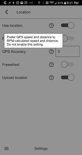

Pictured here… Only a .6mi ride but from Darien to where the dot starts to move is in question…
  1. for this GPS its says don’t enable. Any explanation for this and why? I also feel lile sometimes the max speed value it shows os higher than in reality…sometimes by 3-4mph higher… I usually have a go pro recording to verify… Or even speed past a radar sign to see what it has to say…
Your phone was reporting incorrect GPS. On your screenshot there is GPS Accuracy. Set it to 50 (meters) instead of 0.
I just went through this again. Killer job on this walkthrough.
Thx for the reply and will try. Any info on “prefer gps” and why to keep it disabled?
RPM based speed calculation is updated more frequently than GPS data. Make sure that you have the values under Settings → Motor set up correctly, so the correct number of motor poles, motor/wheel pull teeth and wheel diameter. When everything is set up correctly you should get very precise speed data. When you are driving through a tunnel and loose GPS signal for an example it will kind of mess up your data when that setting is enabled.
The setting is useful for things like eFoils where you can not calculate the speed based on RPM data.
