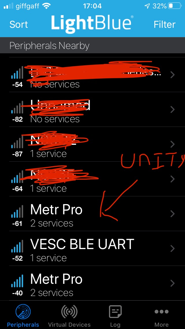

@rpasichnyk so after all the disconnections Following you advise I ran a BT analyser on the metr pro that keeps disconnection finds the small aural one in my other board in 2 seconds it can not fined the unity one?
Only thing google searches tell me is if the signel is to week I might not show up.
Any thing els to try? I’m kind of leaning towards a faulty metr pro is the only thing left.
Do you have original UNITY BLE module? How does that one work?
That’s the one that keep disconnecting and is not found by the BT analyser

Had again play and the app found it This time This is from 30cm away shin height from the deck other deck is about a meter away For comparison.
For some reason the unity one is very temperamental of been found other one is found every time no issues.

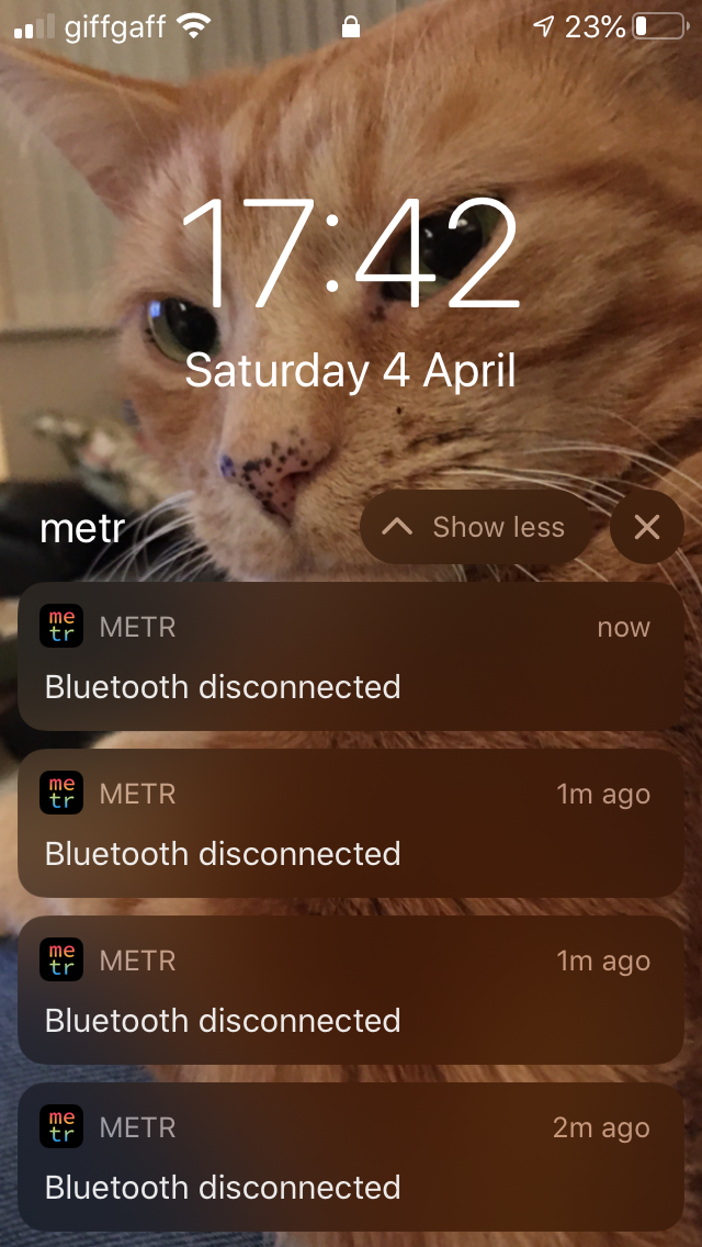

Walked around the hose all fine sat down with phone next to the board for a few minutes and I get these notifercations. When are thay triggered is it module disconnection from the VESC or module disconnection from the the BT devise?

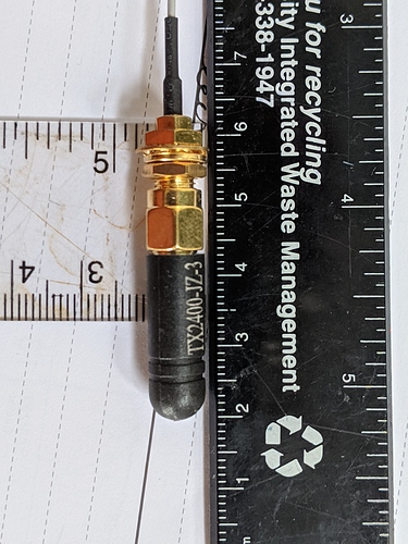

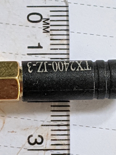

@rpasichnyk I might have missed it but can you post pictures to show the different sized antenna? I need to know their dimensions.
Thanks :smile:
the one i got is 8mm diameter and approximately 44mm long
i can’t promise that you’ll get the same antenna with your order. i suspect any 2.4ghz antenna with a u.fl connector will work in it’s place
So that’s the small antenna? That is quite compact.
