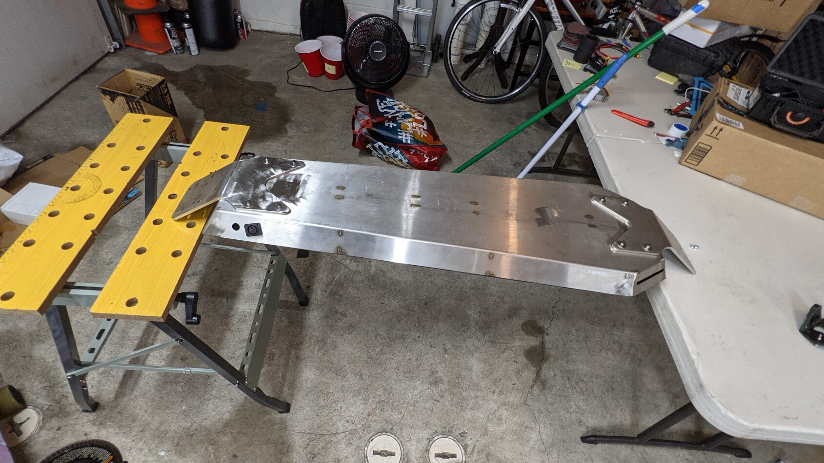

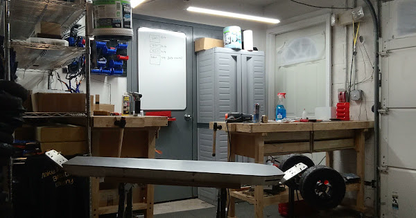

It’s out of my shop
Time to continue work.

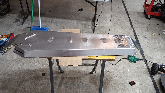

First, let’s get rid of the heat marks from welding
before
after

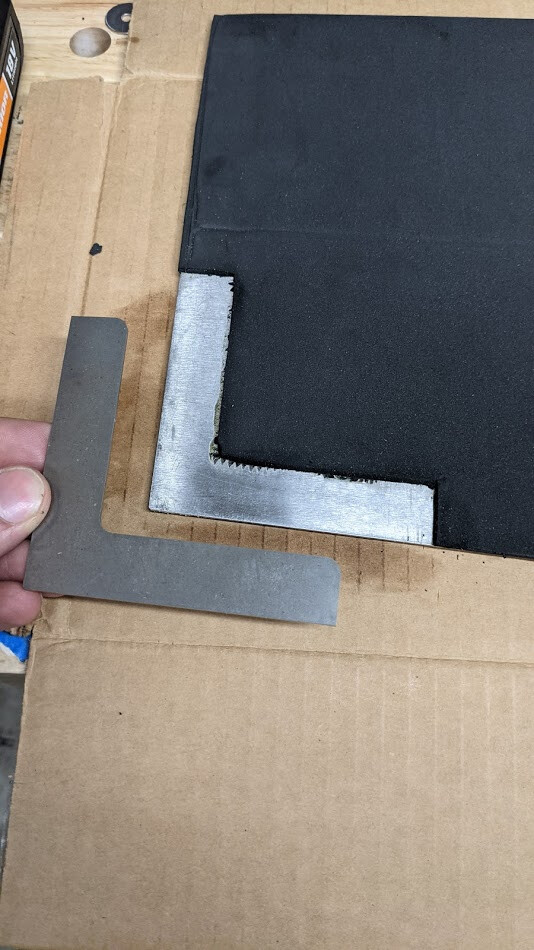

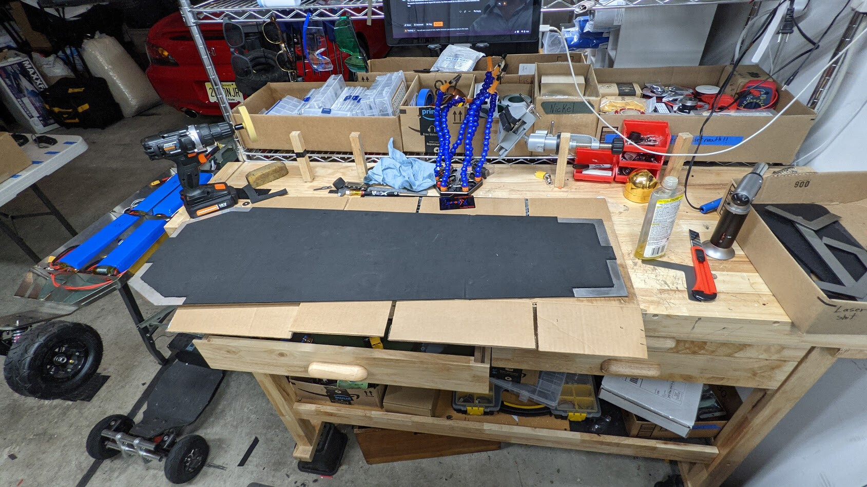

Next, the lid attachment system that has been giving me so much stress. I finally decided on something with zero moving parts or exposed fasteners. To do this I glued a huge sheet of 1/8in thich neoprene foam to the underside of the lid. This stops all rattling sounds from steel-on-steel contact.

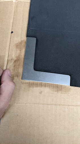

To hold this lid down using magnets is a bit of a challenge due to the fact that stainless steel isnt magnetic. I solved this by ordering some regualr steel lasercut from sendcutsend.com. I cut sections out from the foam and JB welded it together.
Cutting and gluing and cutting and gluing and cutting and gluing. What a PITA but its well worth it. The lid passes the dairy queen flip test now.
It takes a lot of force to get this lid off, neodymium magnets are no joke. Remind me to take photos of how I JB welded them to the internal walls/frame of the board.
The friction + the steel frame digging into the foam means the lid will not be sliding around at all. I may add some foam to the steel on the inside of the chasis. We’ll see.
