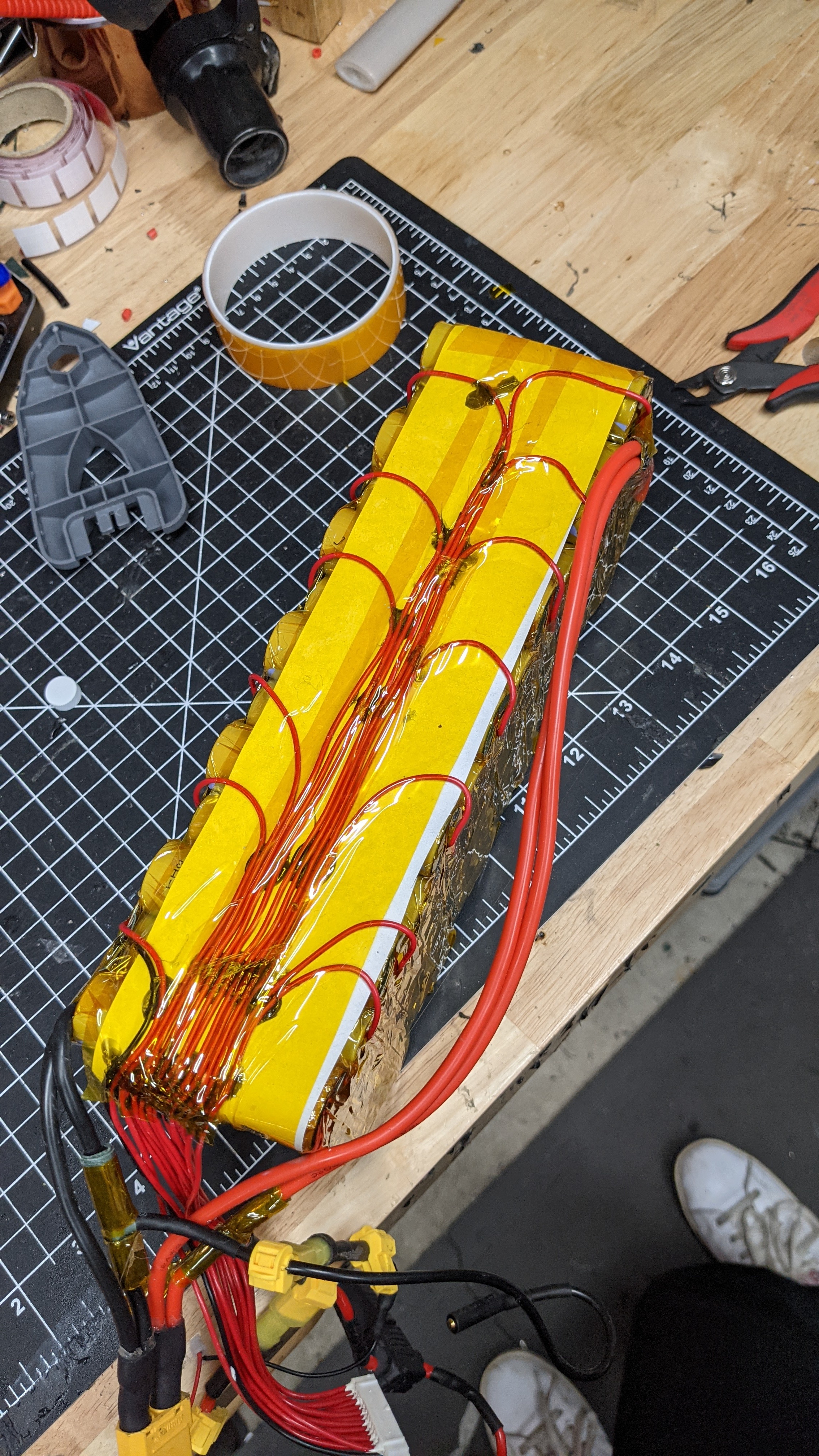

1.3Kwh Boombox Speaker
For some reason my batteries are a hit in the Washington DC area. This is one of the most interesting builds to date.

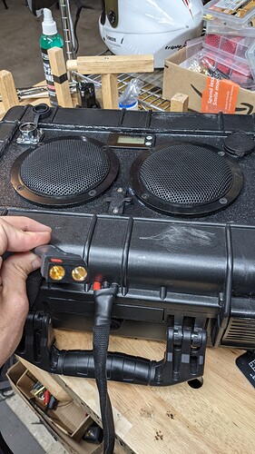

A spare 12s6p P42A battery for a Lacroix. This is a hot swap situation, NOT a charge and ride. There is a single loop key that can go into either the board (in board power) or in the box (external power). Since there is only one key, the two batteries can never be connected in parallel. This reduces the chances of damage from a voltage difference. This route required two ports be added to the board.

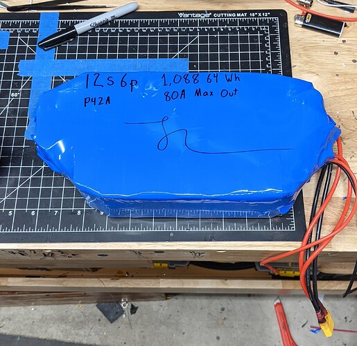

The battery is your standard affair
For all the ports I ordered a laser cut plastic panel from sendcutsend.

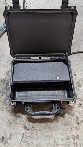

Finally delivered to client :call_me_hand:

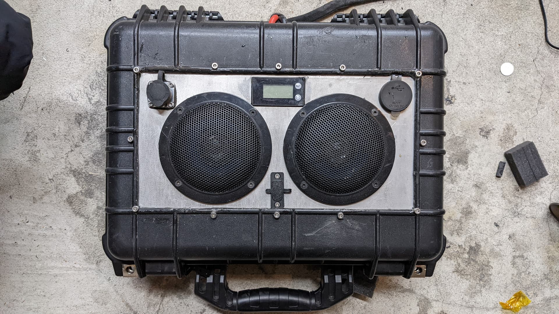

The box came back to the shop because someone sat on it and the epoxy failed. I made a laser cut aluminum version of the instrument panel that is bolted in place. I also completely redid all the electronics inside to:
  1. Make more room for storage
  2. Reduce idle drain
  3. Make it look less like a bomb/ piece of shit
The anti-spark inside is only for the accessories, the discharge for the board is bypassed of course since the board has its own anti-spark inside
Side effect of reorganizing the inside is that the box sounds a lot better than before
