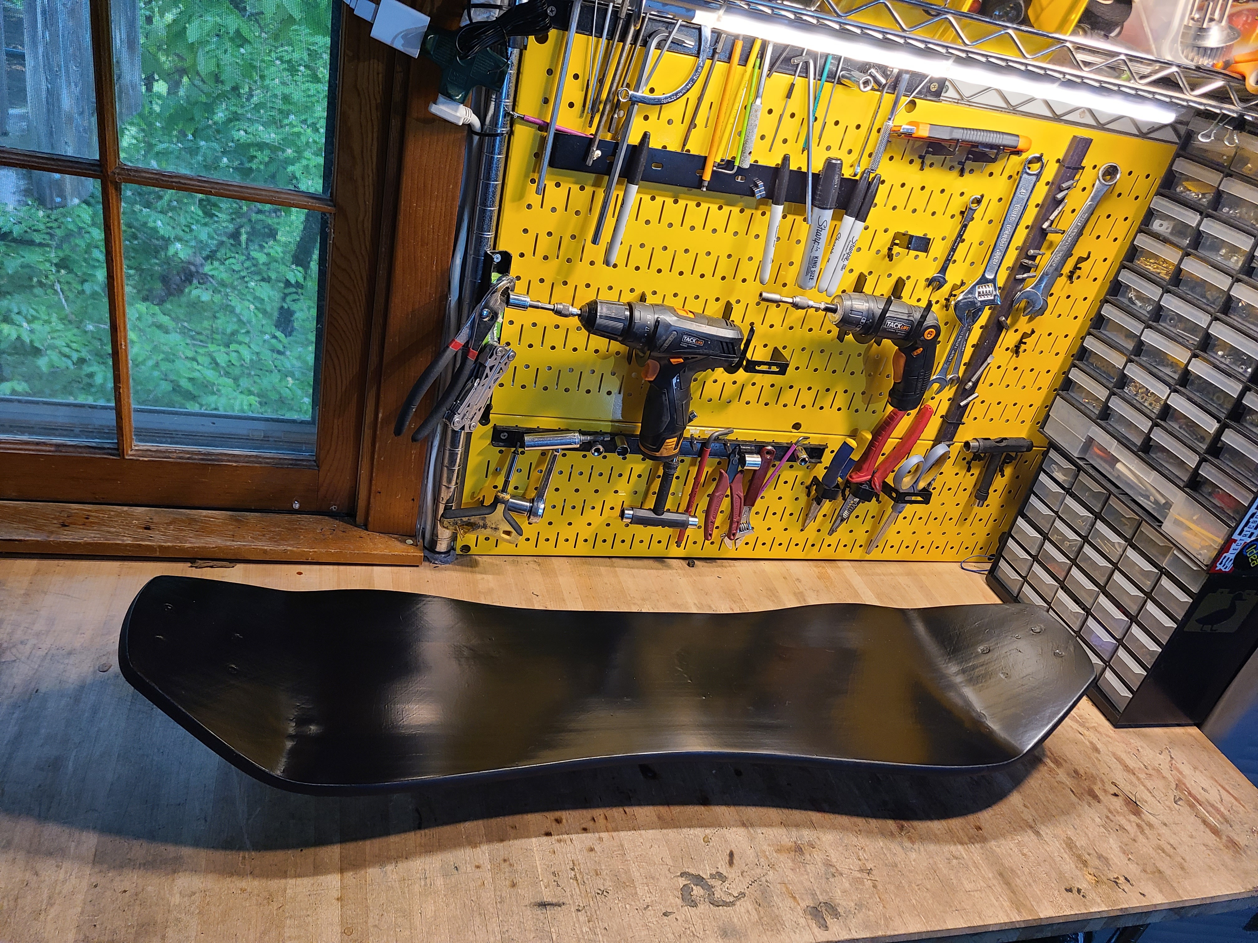

The Carver... My final frontier

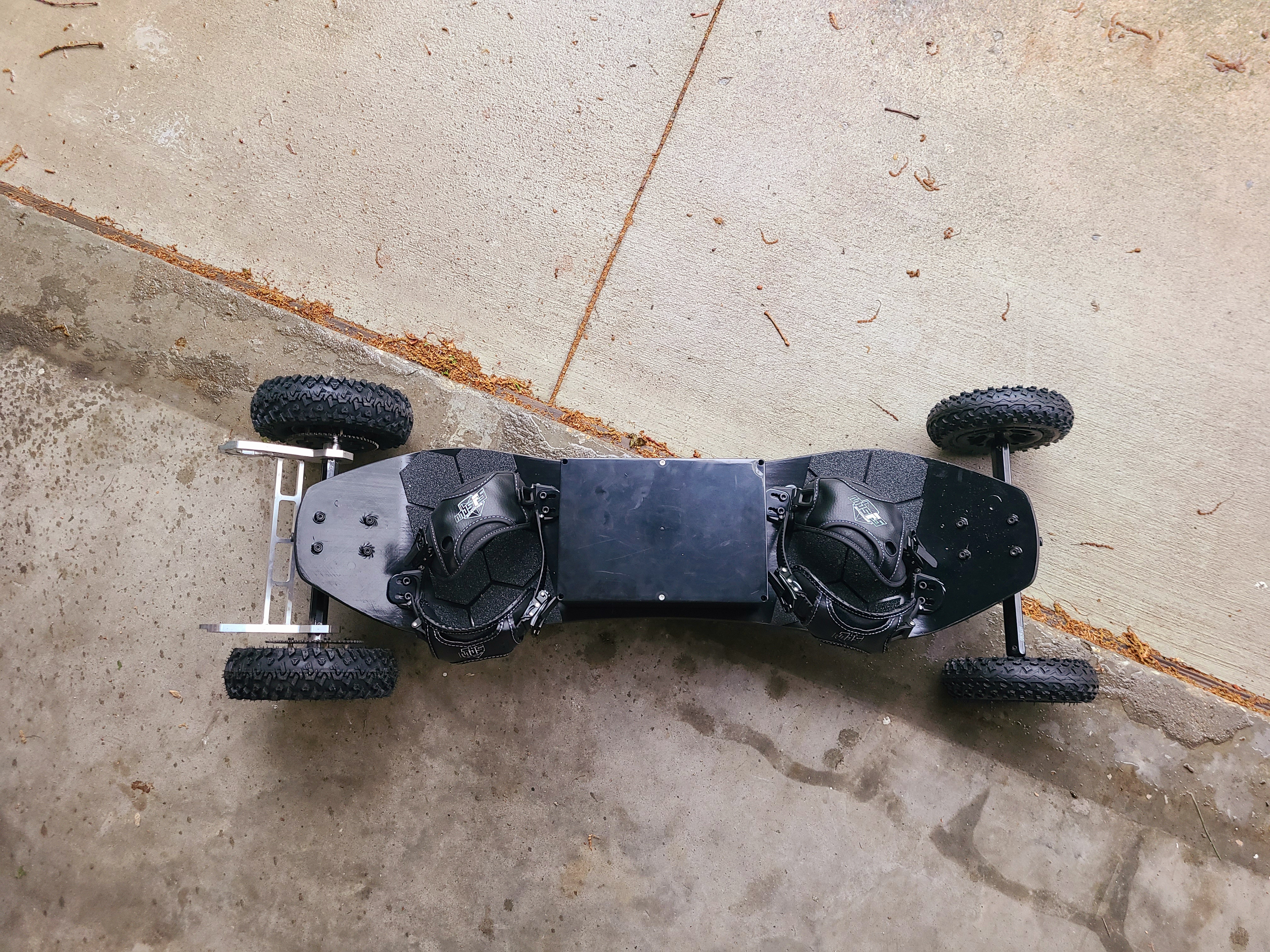

Big huge difference between these tires…
Messing with me a bit…
First good preview.
What’s the thought process behind two different tires?
Oh.
I have not done it before. So my first time trying the 8 and 9 combo.
I really like 9s for the grip.
I hear the mudpluggers are even better than the MBS ones.
But some folks will keep 8s in the front to keep it lighter.
Might be more nimble steering with the 8s as well.
So.
I want this board to be lighter… But could not see myself giving up the grip…
So trying the combo.
I have seen this 8/9 combo on a bunch of the Trampa videos.
Tow truck is 45.8 lbs… 20.77 kg
And for the first time in its illustrious career my Haero meets bindings.

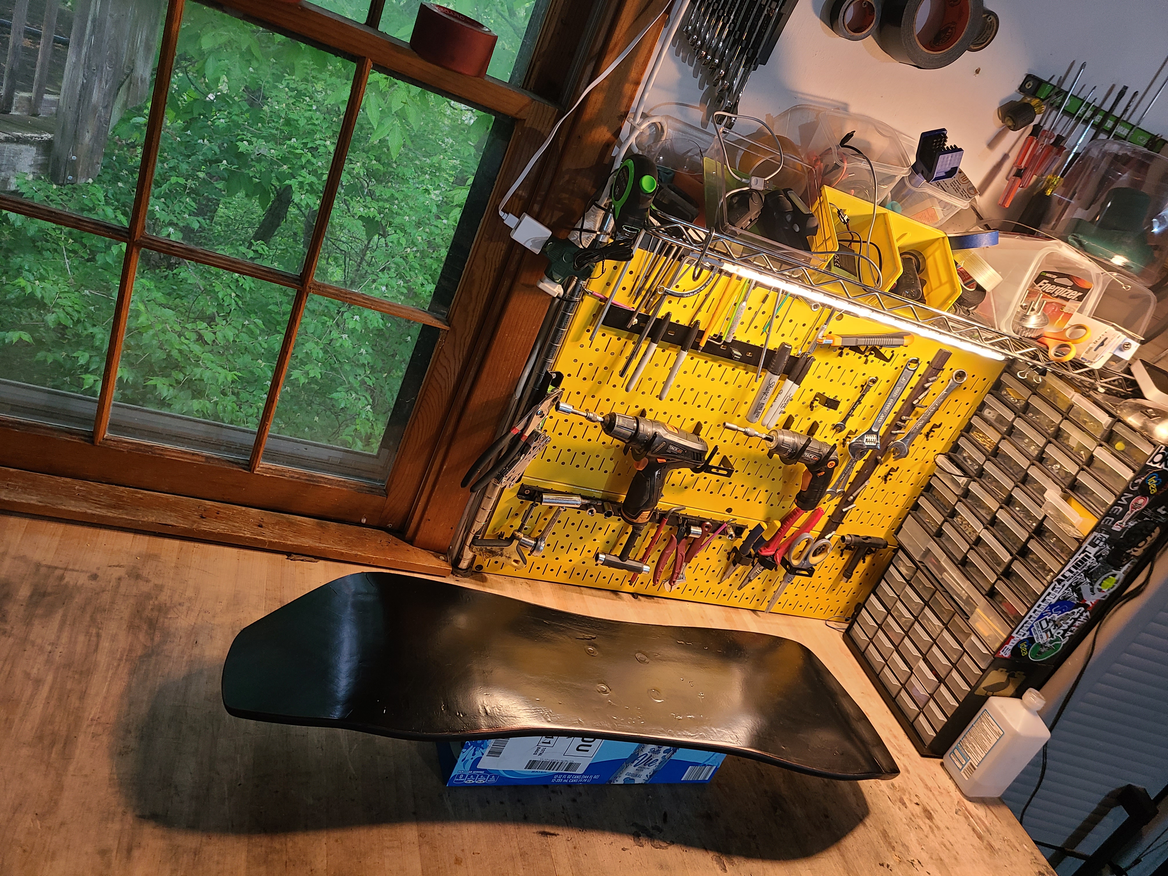

Little bits.

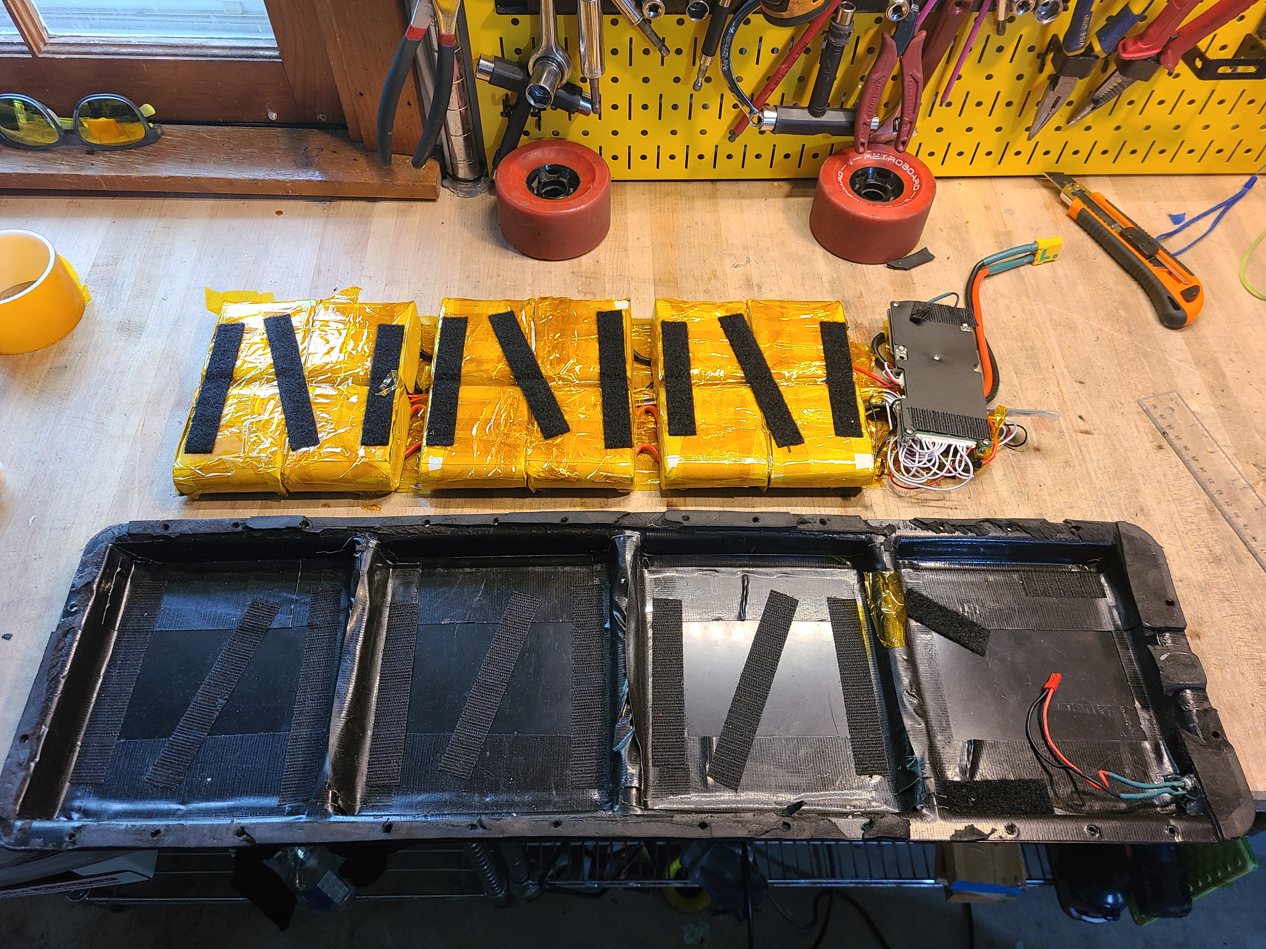

Tearing down the old sleigh.
Motors go on the shelf.
Unity stays on the Bro.
Battery is, hopefully, going on the Llama.
I’m pretty proud of myself.
After all the miles I put on the Bro the inside was perfectly clean.
On the challenge side…
I obviously never meant for this battery to come out of the Enclosure…

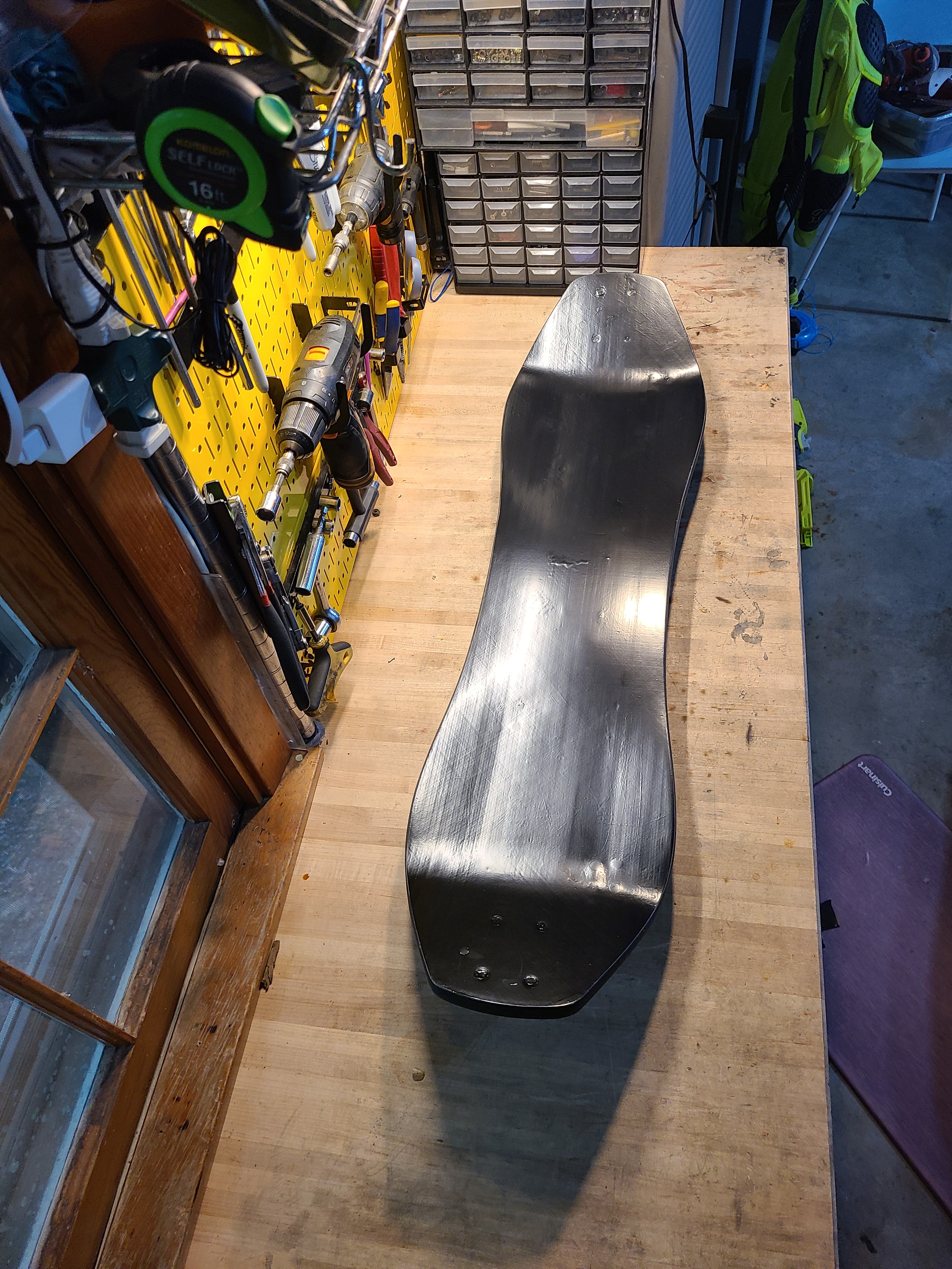

Drilled the board…
This is always one of the most enerving steps for me.
Using regular skate bolts.
Going through these barrel nut things.

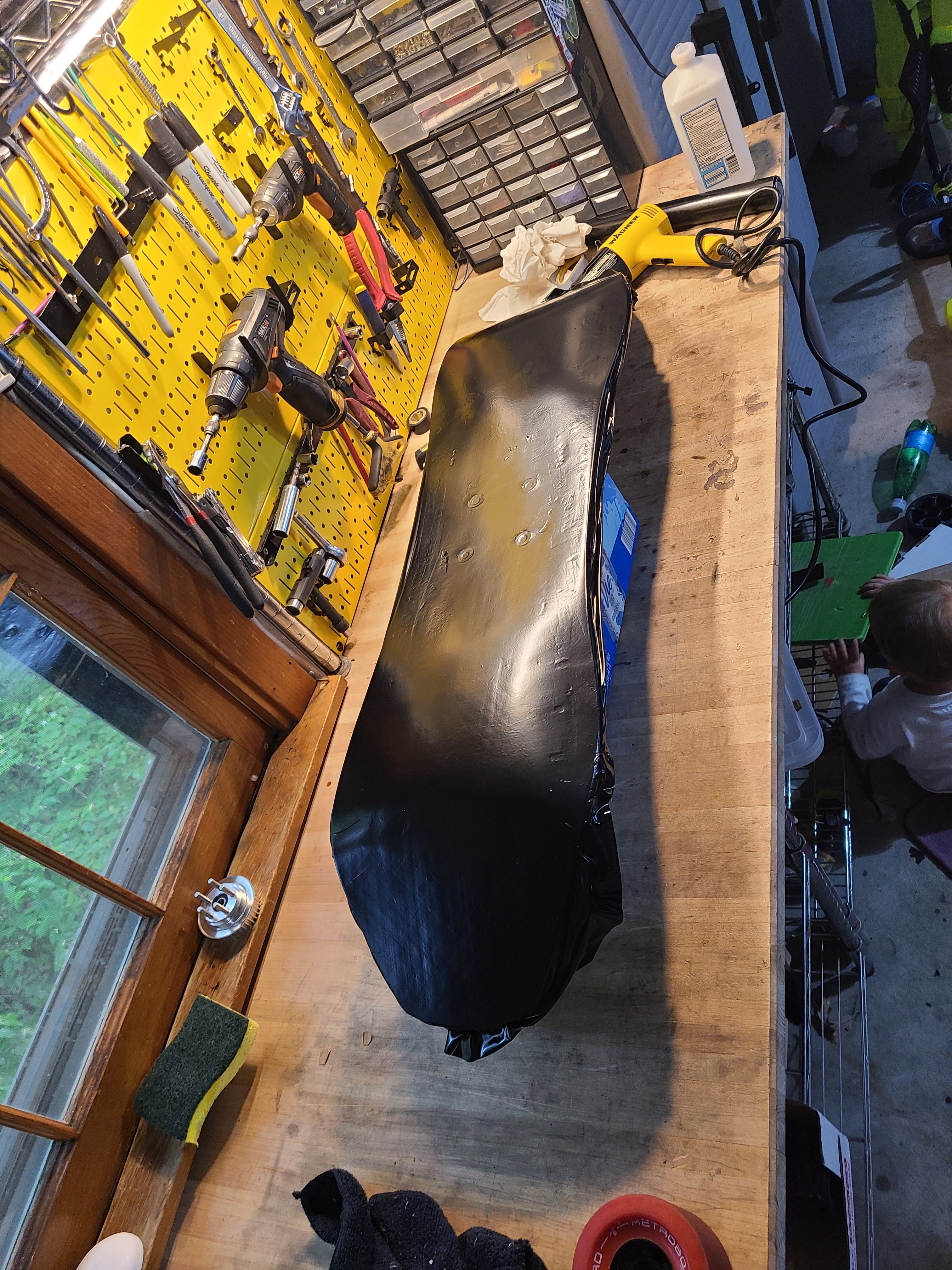

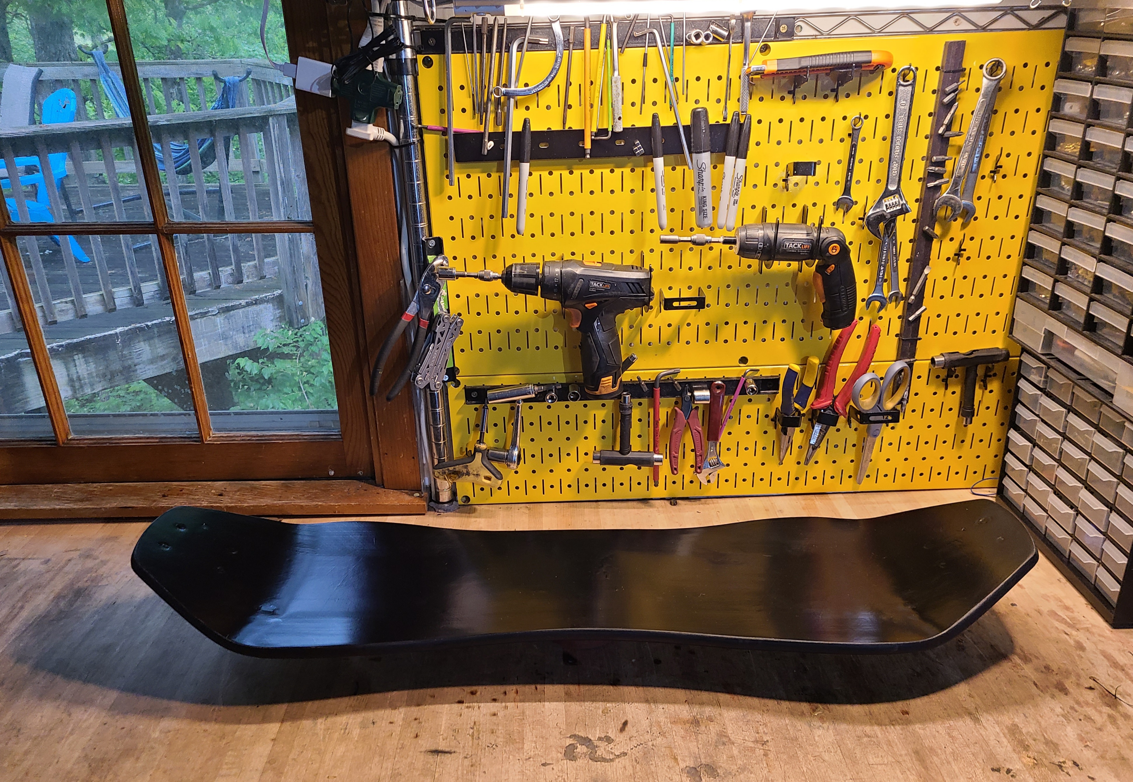

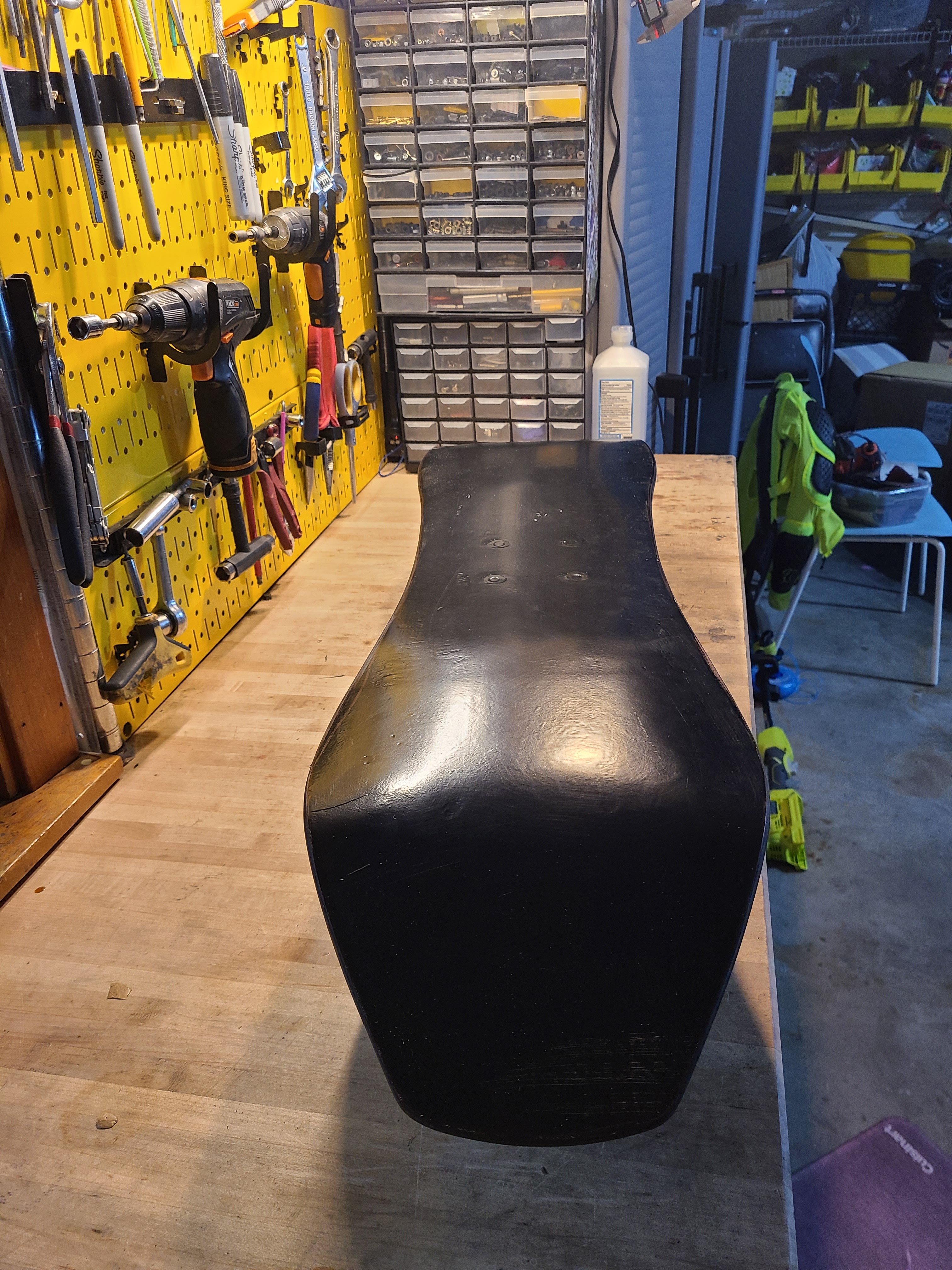

In comes the Bat Bro.
Looks awesome! What did you use to wrap it?
This Vvivid stuff.
It is far from perfect up close.
But I can live with it…
I’m happy with the overall look.

after almost a couple of months slacking and working on other distractions I took a couple of steps on the Haero.
cut the shafts on the motors… yey.
and cut the enclosure to fit the heat sink on there.
next up I need to extend the motor wires…
