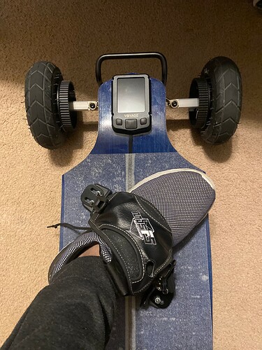

this is what i did for mines. first went out riding to see what foot placement my feet were comfortable at, took pics and then went back inside. i then placed my foot on the board the same way and wrapped the bindings over with my hand, marking the holes with a marker. i then drilled the holes out and countersunk it, pretty simple process although annoying and time consuming. the holes are roughly 8in apart or 204mm but if i was to do it again, i probably would space them out a little more.
i also put some silicone sealant around the holes on top the board before i tightened down the binding so in theory, no water or debris would get through and into the battery enclosure. and no this board won’t be ridden in the rain but accidents happen

Don’t treat it like a Bible though. I’d mark some grip tape with chalk on a board and go for a ride to see where your feet are moving over the course of a trip. Then fit the binding in a way that covers the maximums. I set my emtb up with the default holes and my feet ached for weeks before I skewed the bindings towards my preferred stance.
Personally, I like them loose enough width wise to be able to rotate my feet but not much more.
Doing the first placement test w/short pan head or whatever wood screws can be a good idea.
If you get things right the first time, all you have to do is enlargen the holes & go all the way thru the deck to use proper bolts.
If you don’t like the placement, the holes from wood screws are small and easy to fill in w/putty or something & you haven’t gone all the way thru the deck
