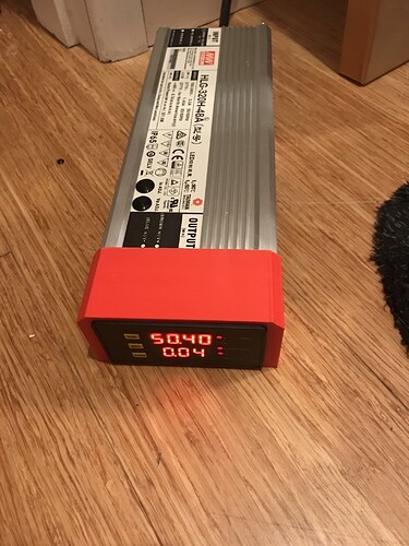

I use a drok cc/cv with a psu. It’s adjustable and it’s nice to be able to see when your pack is full and trickling at 0.1a I assume that means it’s still balancing a bit. I have never seen it less than that though for amps.
Most llt and Daly do this. Well at least the ones I use in my builds do.
I’ve broken every cheap bulk power supply I’ve ever gotten. Meanwell or nothing for me going forward. Get the waterproof fan-less one with adjustable voltage n current! And wire in a wattmeter. You have to attach a wattmeter and it’s the difference between knowing nothing and possibly blowing up and knowing everything
Many supplies/chargers/devices are not very accurate at low current levels and will show 0.1A even though much less (even zero) current is flowing. There might be around 100mA flowing but there is a good chance that there isn’t.

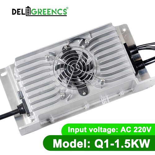

soooo, anyone with a lipo pack or no sense of self-preservation want to try out this nonsense? There’s also a 3.3kW version if you’re feeling spicy
When you need to install a new circuit in your house to charge your board
