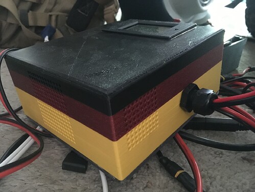

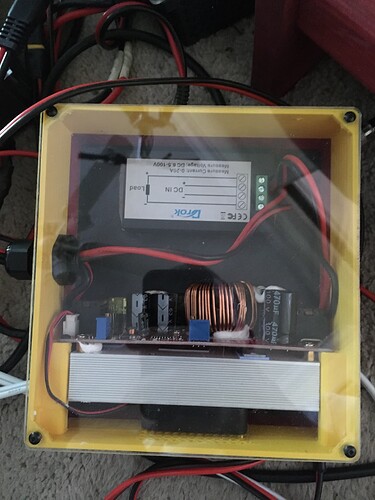

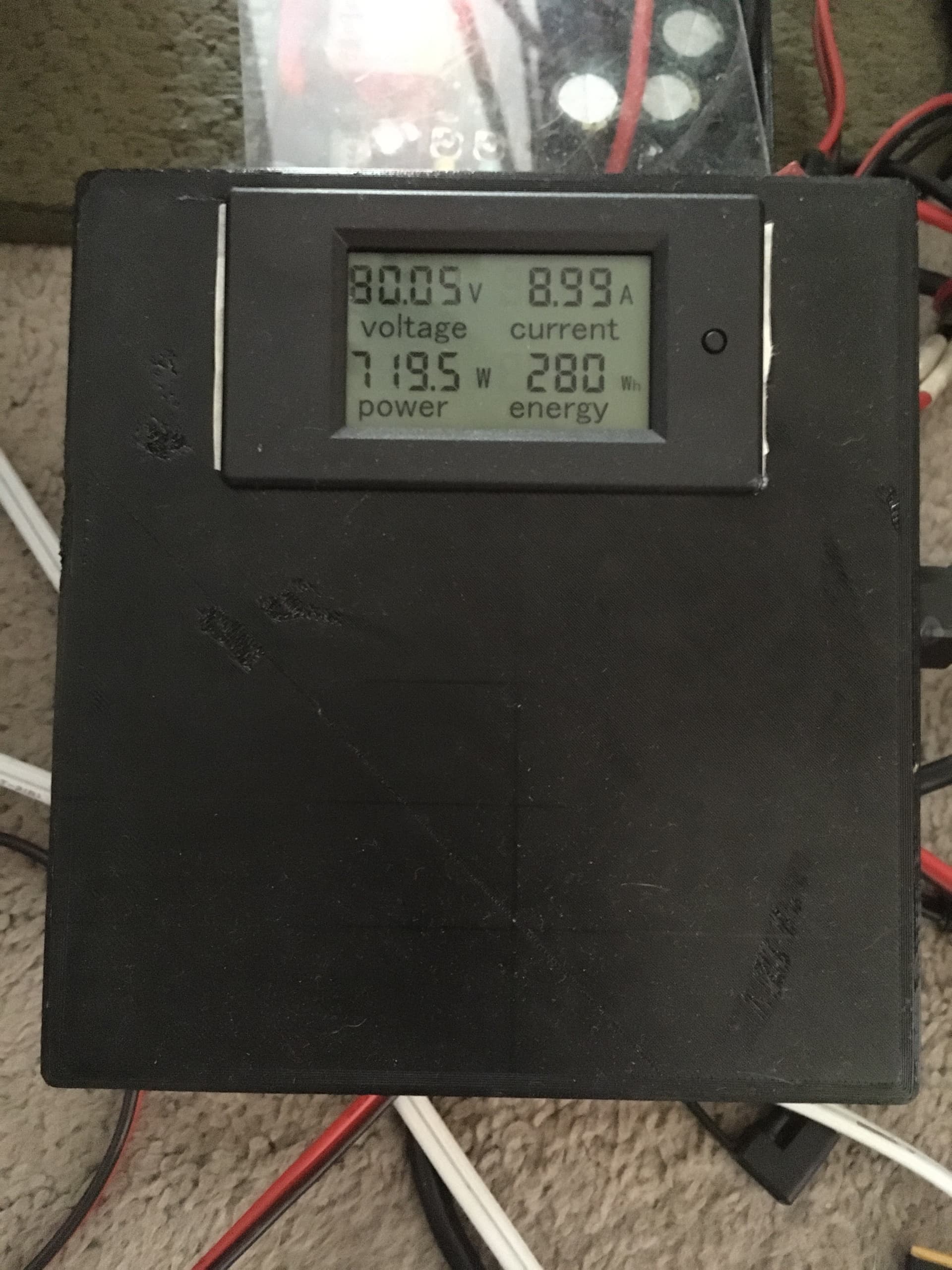

New DC-DC charger I built. I prefer DC-DC because they are cheap and I can charge to multiple voltages on one power supply. Mostly I charge 15S and 20S.
1500W DC-DC Boost Converter
Multimeter Display
Power supply I use
I used left over material for the 3d printed enclosure so it looks a bit janky. Efficiency is good. It gets about 97% if the voltages are within 10-20V and gets down to 90% at more extreme boosts.

This is an awesome build. Thanks for sharing.

Have you been able to confirm that the Drok voltmeter/Ammeter display is relatively accurate and consistently so? I’ve had very inconsistent accuracy with these, in both, and kind of just shoulder shrugged and remember the Asterix factored their use.
Is the Fan Noisy? I had one of these 1500 watt V boostersthat I fried when powering 24v hedge clippers from a 12v battery, and regret not salvaging the fan or heatsink before abandonment.
These style of fan’s blades often stall, when there is resistance to flow close to the intake side of the fan. Moving that resistance just 5mm away can make a huge difference in both airflow, and the noise the fan makes. I highly Recommend experimenting.
Getting a 50mm ( IIRC the 12v fan was 50mm, could be wrong) finger grill and mounting it on the outside of the case could make vast improvements in both airflow and noise, as would a puller fan on the other side.
The fan provided with my booster was sleeve bearing, with poor CFM and Static pressure specs compared to a Noctua or Delta Or Nidec fan of same dimensions and Amp draw.
if the fan fails the Booster could smoke itself so I feel that the best way to prevent magic smoke is with a quality dual ball bearing or Maglev fan that can scavenge all the air it needs without excessive restriction behind or in front of the blades. But flow restriction in front of blades is far better than restriction behind.
I’m charging at 3 amp per cell on p42a and p50b, which I think can handle 4 amps, so it does not really get that hot. I think I usually see 35 degrees C at the most so I don’t even consider cooling before riding.
It’s quiet. Much more quiet than the power supply. I’m running about 800W and the fan is only running intermittently. I think the heat sink is plenty large for the heat generation so it should be good for over 1000W but the documentation even says if you plan to run 1500W you should have some additional cooling. That’s a good thought about fan reliability. I might swap it out.
I had a similar looking power supply before I got my Meanwell RSP-500-15. Its provided exhaust oriented fan was pretty loud a with a lot of restriction close to fan blades.
I modified the Lid to put the fan on the outside of the case, and the flow and noise was greatly improved.
