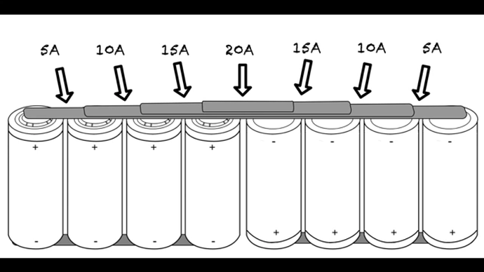

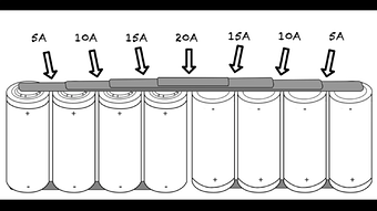

Each nickel strip attached to a cell in a P group will do about 15A, but the Series connections will do 15A*5.
So .15mm strips for each cell in a P group then copper series connections should work.
If you want to weld thicker you can stack two strips on each other and double it up. Might or might not need thicker than .15mm depending of your current draw requirements. I don’t think welding thiccer than .3mm is reasonable with the KWeld.
How many amps is that bad boy capable of discharging?
Its only 200W
Welding above 0.2 is tricky and not every one can do it reliably as the weld current wants to travel down the strip not in to the battery welding the strip and battery together. Iv never heard of any one welding 0.4mm nickle

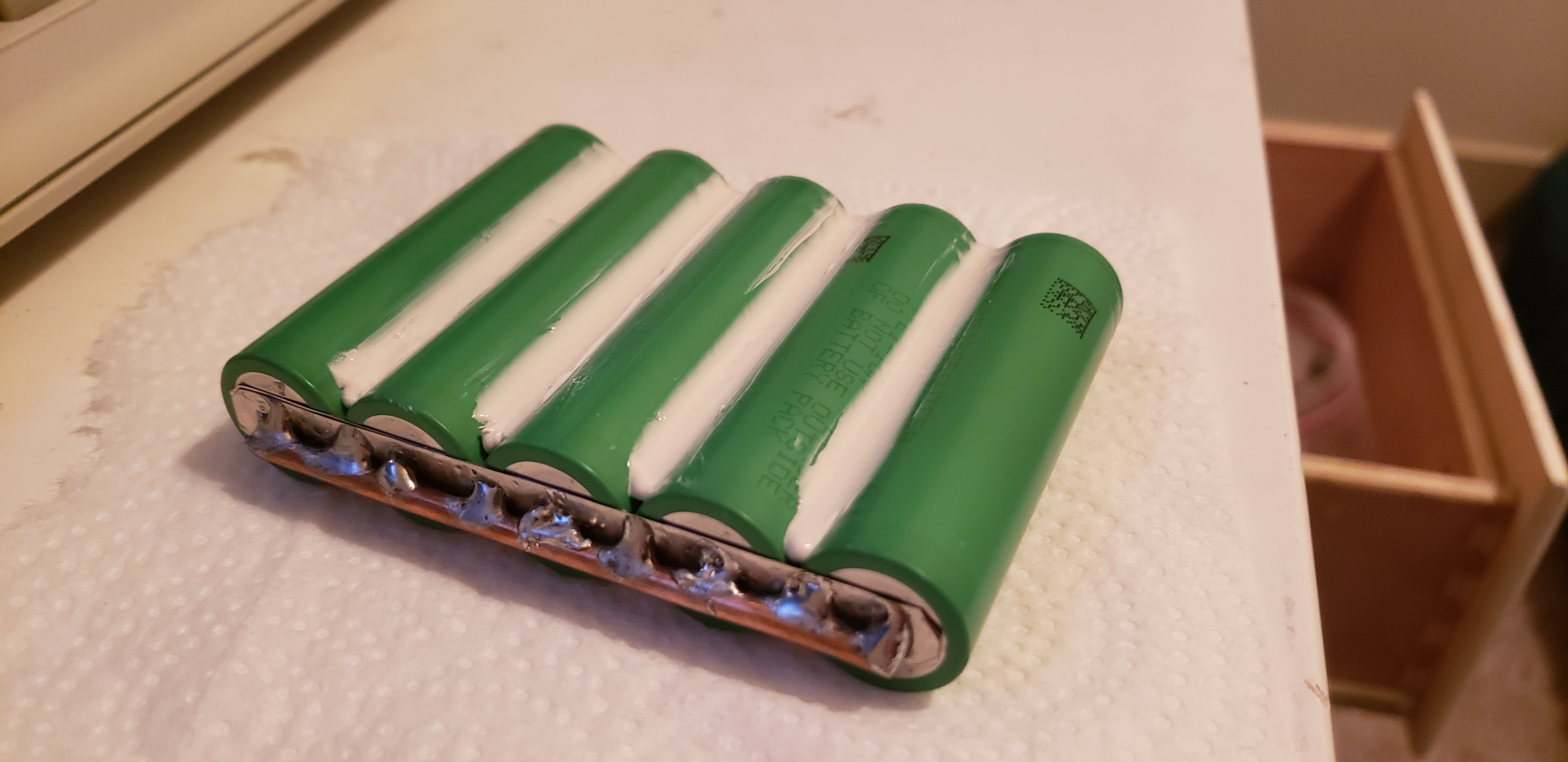

This is the idea, then connecting series in the middle.
Ideally you would solder the bus bar somewhere away from the cells like on top of a PCB so as to not overheat the cells and connect bus bars in series with flexible silicone wire. Copper takes a ton of heat to solder, so the heat quickly travels across the whole bus bar to all the cells if you are soldering directly to the nickel you spot welded to the cells.
Either way, I did this with my pack and it works great, just don’t dribble solder down the crevice between the positive terminal and inside the cell. Be as quick as possible, and be ready to cool the cells down somehow with cold forced air or something?
The only reason I did a copper bus bar like this is because my 5P pack with VTC5A is capable of 175A, and without the 8AWG bus bar there is no way a few layers of nickel would carry a fraction of that current the short distance across the P group over to the series connection without heating up.
If I were to do the PCB, and nickel bridging the terminals to the PCB, I’d personally layer up the nickel from each cell 2 or 3 times, then solder the copper bus bar to the PCB ontop of the nickel, that would mostly avoid heating the cells like I had to.

@sedmii did some tests on professional lab equipment. He used 12x0.2mm pure nickel strip. After 7 minutes on 30A current, nickel had temperature of 47 degrees celsius. To be fair, nickel wasn’t isolated under kapton tape like in battery pack, but still this is much much higher current than in any data sheet on internet. what I want to say, we are probably using nickel way too conservatively.
for example, look at @longhairedboy video making battery for evolve. he uses only one layer of nickel (0.15mm if I am not mistaken) and his wires for series connections are not even in the middle of group, thay are between 3rd and 4th cell. That means that only one nickel strip has to carry current of 3 cells. If I remember right, evolve esc draws up to 40A, and that’s still 30A (out of 3 cells) on only one strip. and I never heard that he had melted nickel strips or burn marks.
It is better to put layer too much than layer too less, but I still think that people worry too much about nickel ampacity.
what was the length of the nickel strip that you tested?
few cm, similar length like we use in batteries
The length of the nickel strip is not relevant to its current capacity.
It does affect voltage drop and total heat emitted but not ampacity.

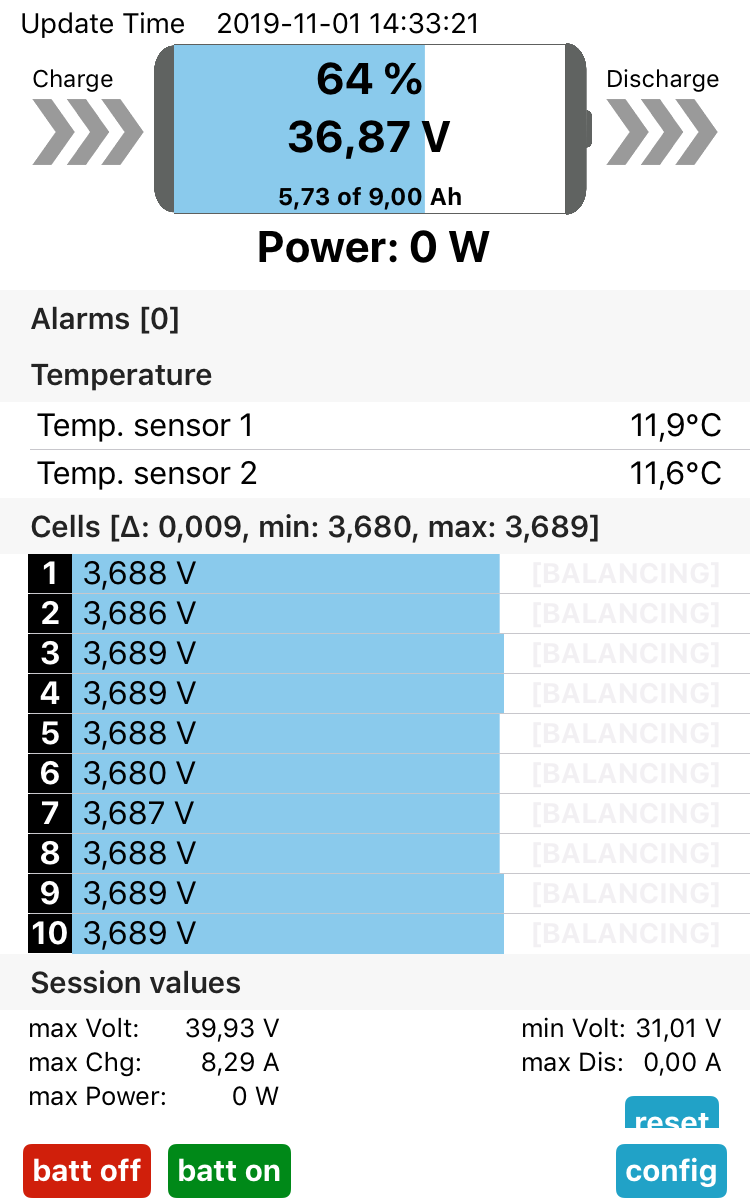

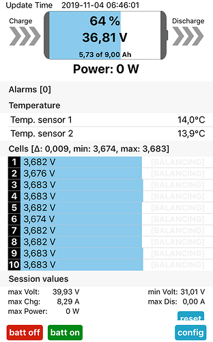

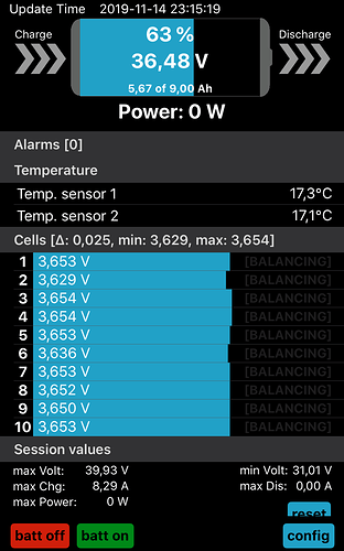

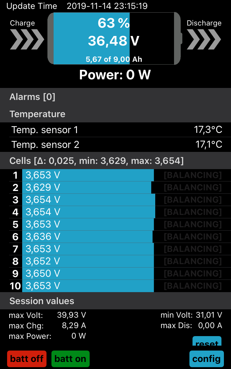

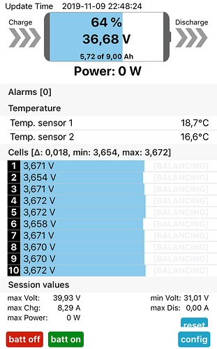

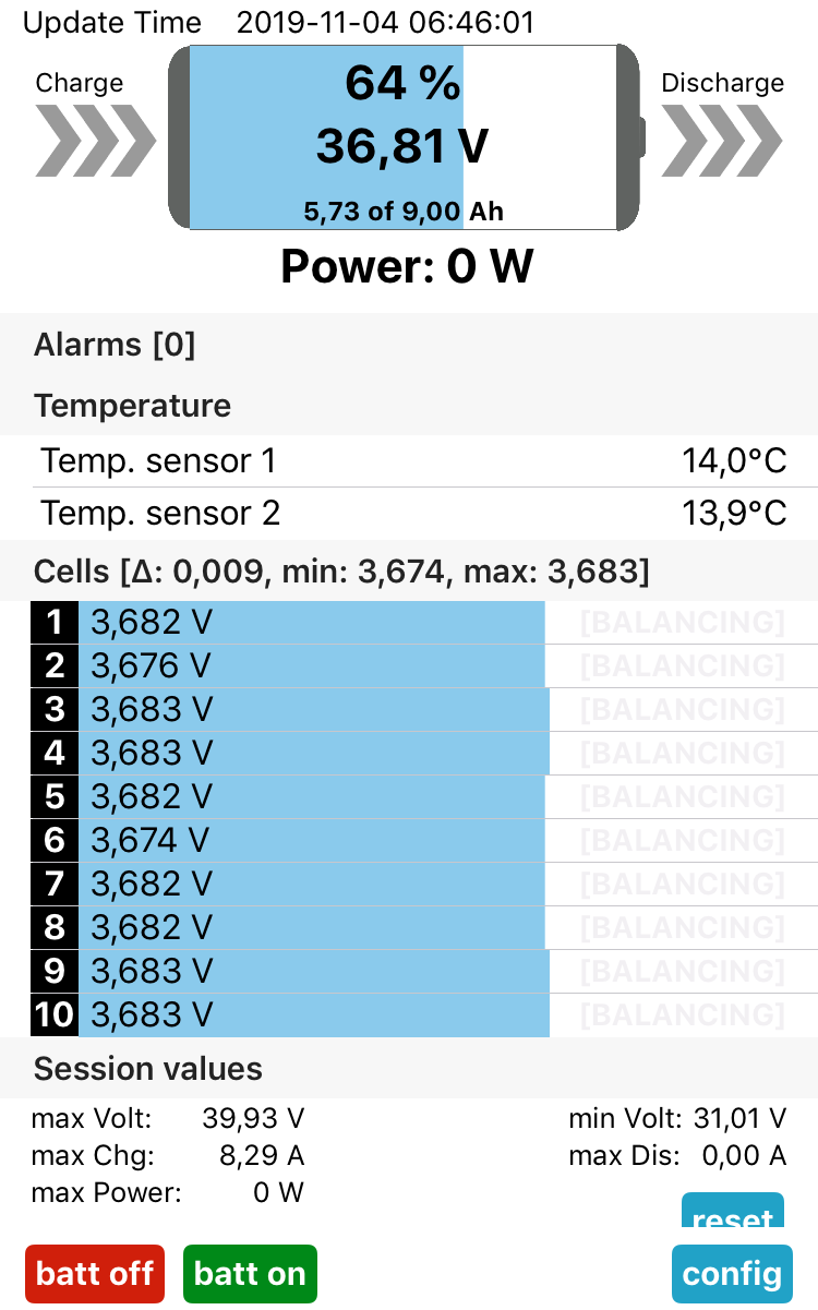

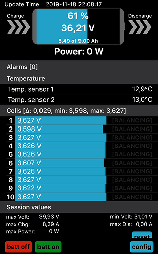

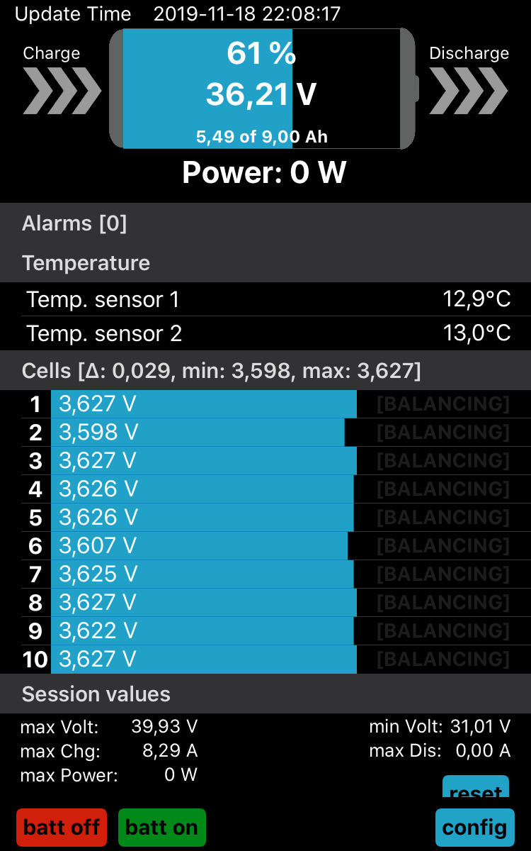

Maybe someone has an idea what is happening here but one of my groups loses voltages faster then others from time to time (when the board is just stored away). In the beginning this didn’t happen. Opened the battery but can’t see any mechanical defect.
Screenshot of my cell lvl’s:
Summary
As you can see it started balanced out on the 30/10 but in the mean time (without riding) group 2 and 6 dropped significantly more.
Could it be the bluetooth BMS?
Have you tried leaving it with nothing connected?
Bluetooth BMS seems suspect.
unfortunate having just a subtle issue with a battery and having to repair it.
Yeah, maybe I should test it with the BMS disconnected!
It’s indeed annoying but luckily I can leave on passive balancing to drain the rest of the groups equally. But you still wanna know in the end :sweat_smile:

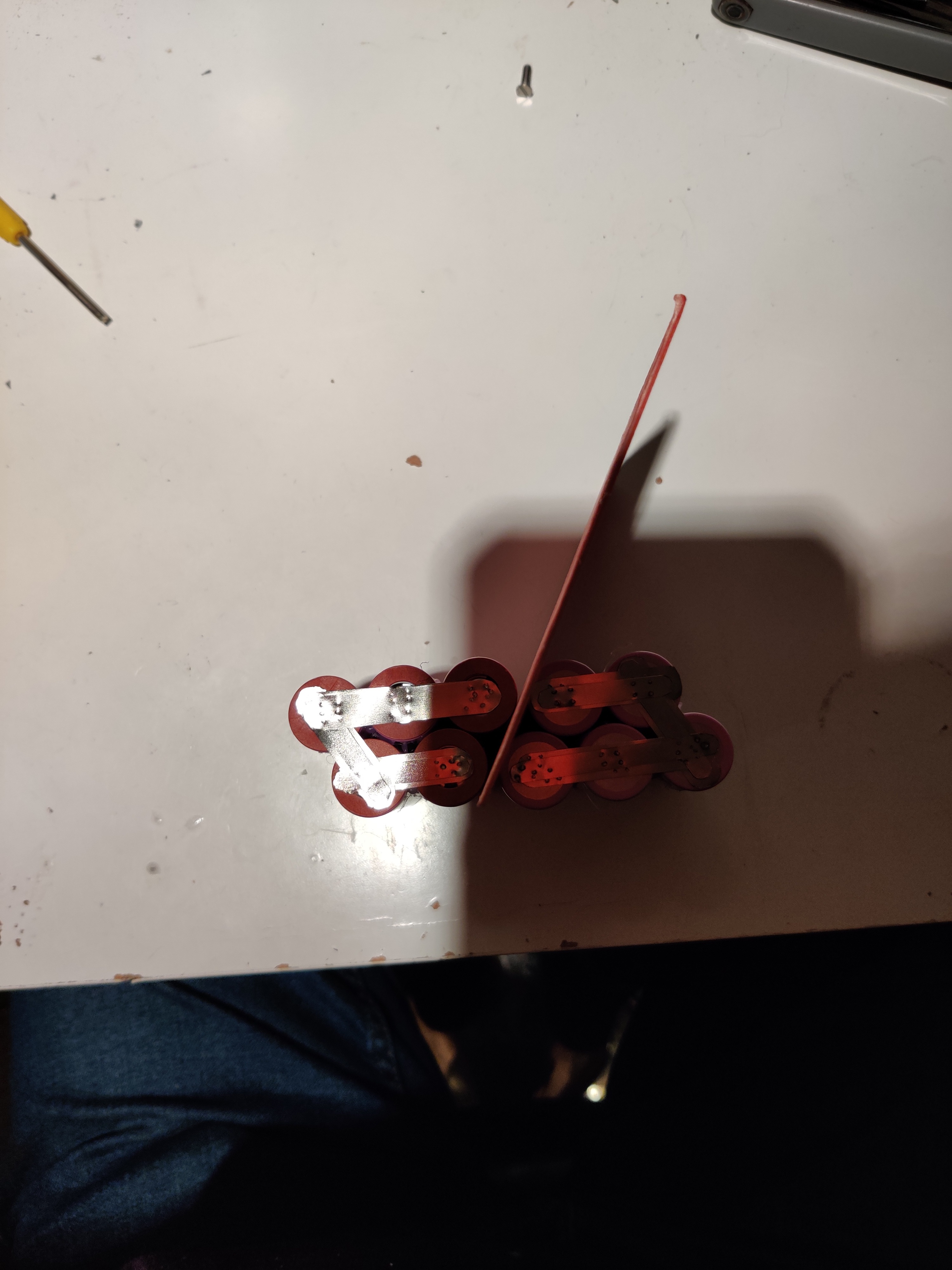

I have this issue, the fish paper I ordered turned out to be a stiff plate covered in fish paper instead of normal fish paper. Can I still use it? I would cut into appropriately sized pieces and put it between the p groups like this:
