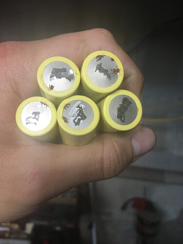

Hey what does this mean, should I Chuck these cells cuz a the rust at the bottom is the electrolytes leaking out? I’m prob gonna use em anyway, I’m building a bomb I mean board for an enemy I mean friend of mine.
Edit: the percimon are just for reference
If you aren’t concerned about your friend’s safety, and are going to use these cells, I’m confused why you’re asking us if you shouldn’t use them. :thinking:
