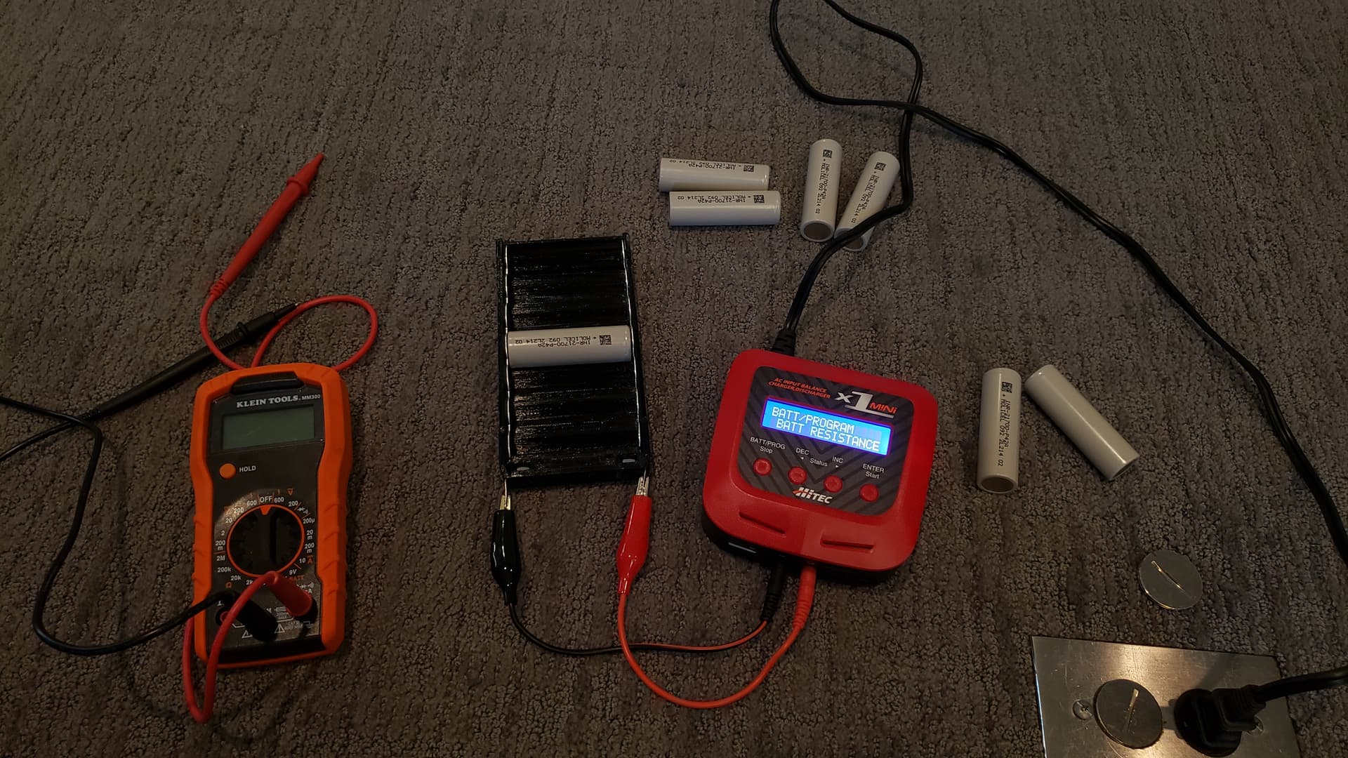

So it looks like 5 of the cells have a resistance of 36 milliohms, but one has a resistance of 41 milliohms and the other has a resistance of 47 milliohms.
Would that signify that those cells are bad?
how sure are you that those numbers are correct? Did you repeatedly test them?
Did you take multiple measurements for each cell, inserting and removing the cell each time and using different slots, to make sure the measurements are consistent?
I’m assuming you used a round cell charger for the measurements. If not, what did you use?

So I think I found the issue.
The center slot in the nese, when slightly flexed outward and then release, and then i check the resistance, the resistance shoots up to like 80.
I then take the cell out and put it back in and the resistance is 36.
So it looks likenit is not making good contact.
What is recommended for cleaning the nickel? Isopropyl alcohol, or lightly sanding it?
I use this setup. I get consistent results with it.
IPA is great for general dirt and body oil but not too much else.
Sanding can help if there is a layer of something between the nickel and the cell but I don’t think that’s the problem.
Is it dirty or contaminated nickel or could this just be inconsistent pressure?
I know it is not a pressure issue.
So would that leave just the actual nese strip being bad?
Edit: I know this is nuts, but I just scrubbed every surface with ipa and I am getting good readings over like 30 tests of taking cells out and putting them back on. Would this make sense?
If there was something non-conductive on the nickel you washed off then it makes perfect sense. :slightly_smiling_face:
Or….
Doing that somehow changed something else mechanically that resulted in better pressure being applied.
