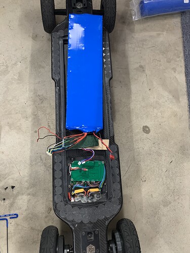

My esk8 shenanigan hiatus finally ended:
Hate to be that guy but you can tell that you’ve been gone for a while since you’re still using nickel for series connections in a flat pack :zipper_mouth_face:
I suppose with a rigid deck like that you’re probably okay though
+1 For nickel series connections are no good.
Nickel series connections * in a flat-pack design * are not good, due to the low cross-section and risk of flexing.
For brick style packs with more cross-sectional area and less flex, they are excellent.
Also nickel series connections will get hot af if you pull some amps. That is if you’re just using a 8mm strip like you did.
really fucking dumb, but I told you this in person. Hope you changed your settings
Yeah I did lol
You really don’t have a choice in the CGT deck unfortunately. He’s got the space maxed out putting that many cells in there. Looks like the nickel is lawyered up and the evolve controller is probably pulling 30A tops, so the current support is fine. With the completely stiff deck it will likely survive. But yeah it breaks most conventions we like to follow these days.
Yeah looks pretty tight, only thing I can think is nickel braid or copper braid would be more resilient
Ive never seen or heard of this before. Links?
Isn’t it just the silver braid stuff?
Edit: Maybe it’s just pre tinned copper braid
Yep the only things I have seen are tinned copper braid and un-tinned copper braid. I suppose someone probably makes aluminum wire braid, but I dont think any of us want that.
Nice.
I’d say the only thing I’d probably add is some fish paper on top of the balance tabs. It’d add a bit more protection against the CF lid over time.
