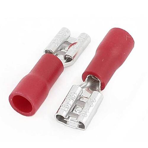

Make your own using blade spade connectors
kinda puzzles me that this was not already a method used by people who do all silicone everything like a lot of us.
Might have just failed to notice.
I guess a lot of us also just solder axial fuses to xt30 loopkeys or whatever, more reliable than blades and we have those connectors.
I went to a small auto part store once and asked for that fancy online fuse holder. The old dude there threw spade connectors on the counter and said to use that instead.
I think he didn’t have the in-line ones
you could solder a blade fuse to the xt30 loopkey too. you could make it externally serviceable as well then
If this were for a custom job or a DIY, I would definitely do that. But it aint, so I gotta go for a certain level of polish.

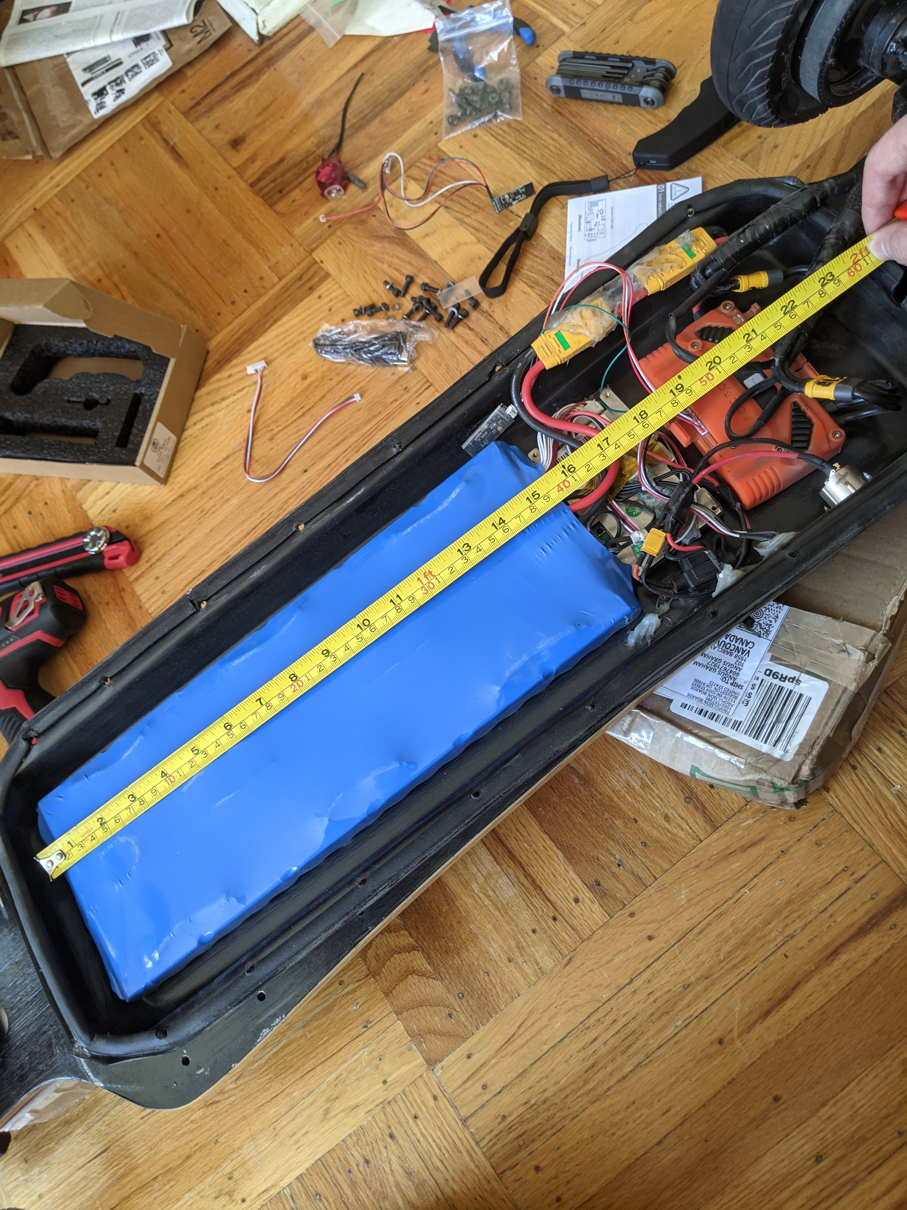

I want to get a new bigger battery built for me but first I’m hoping to get some advice on what to ask for.
(I posted this in noob thread, but hoping to get a response here where the battery people are)
The existing 21700 12s3p battery is 39x14cm.
The flat bottom of the enclosure is 59x17cm.
So if a 12s4p is 25% longer it would be 49x14. That would leave 10cm for the focbox and bms to live in - if I stack 'em that seems workable as long as I carefully route the wires around instead of over the stack.
(I’d get rid of that bizarre nest of gender-changing and xt-to-bullet adapters)
I’m thinking it should be fine to heat sink the focbox into the bms since it isn’t used during discharge.
Alternately it seems like cells could be arranged in a 8 by 6 configuration which should be around 17x42cm which might even allow me to not stack the electronics. Is that possible for 12s4p? Do the cells pack so tightly that 8 side-by-each can fit in 17cm?
Actually I’m guessing it would be more like 17x43cm since there would be tabs and whatnot between each row but that should also be workable I think.
This looks like it’s the propulsion board enclosure? Assuming so, a 12S4P will fit by arranging the cells 8 wide and 6 long, 425x175 plus BMS. I’ve built one with smart BMS to fit it before.

OK thanks - 8x6 it is.
What’s the absolute best 21700 cell to use for the 12s4p? I understand the existing pack has P42As.
P42A is still the current king of esk8 2170 cells.
Haha, yep I remember that they needed it ASAP!! I was trying to figure out why I didn’t know who you were lol
Def use P42A.
I suppose 12s5p is out of the question, right?
Yeah, unless you wanted to double stack the cells and add a spacer/gasket to the enclosure, not much more room than 12S4P
