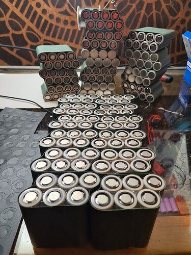

It always seems like a good idea to build two batteries at once, but everything takes fuckin twice as long :unamused:

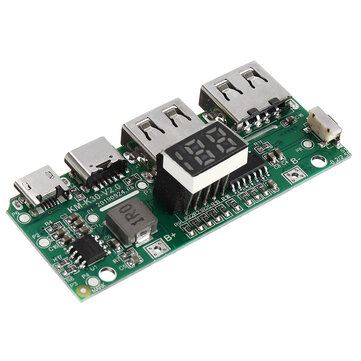

US $2.19 7%OFF | 24W QC 3.0 Type-C Lithium Li-ion 18650 Battery Fast Quick Charging Charger Module Board DIY Power Bank
I used this for my powerbank, charges SUPER fast both my phone and itself, assuming you have a QC charger which you probably have from your phone
