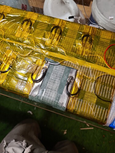

Something a bit different… after this pack had its first charge, cell 2 started losing voltage. After a few cycles it was still happening so out it comes.
Interesting to note, the only part of the wrap that got damaged during deconstruction was the tiny spots where i put the hot glue.
Welds were good tho :muscle:
Will replace the whole group for now, and individually test the retrieved cells to find the bad one
