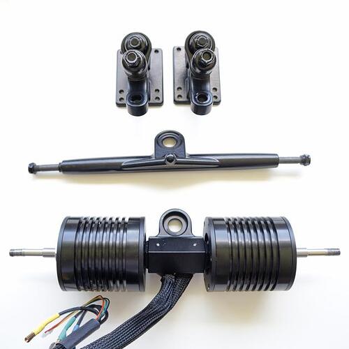

I was thinking about Boundmotor dd but I live in EU so with customs duty I need to pay much more for esc and motors from USA or china than Onsra kit. And it’s my first build so I wanted somethink half done already, in future I will change Hobbywing for some VESC.

Those are low KV, if I want to use 105mm Cloudwheels I would be able to ride only 43-45km/h, I want something closer to 50. But those dd’s are pretty good too, I will think about them.
You can run them on 12s with esk8supply’s ESC and pick up 2-3 mph.
