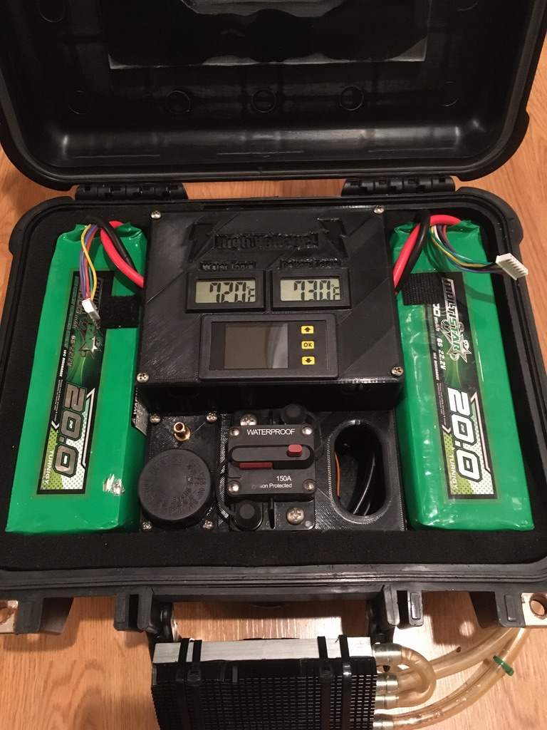

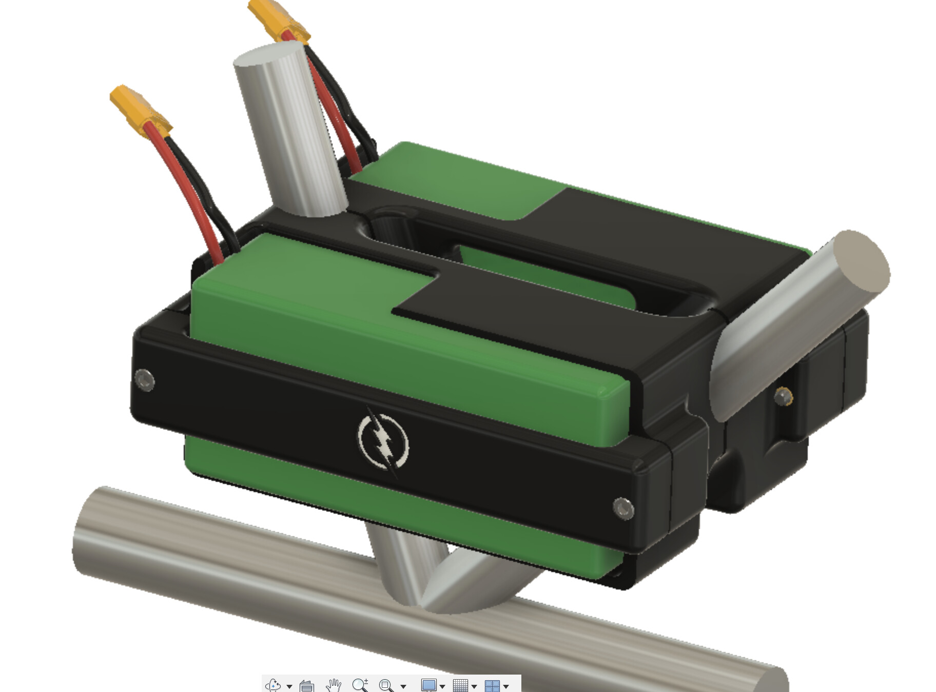

Im fairly space constrained on the left and right sides as well as the front face. was hoping to keep the bulk of the wiring on the top face towards the front of the pack as shown by the first sketch below. I guess since I’m able to use smaller (maybe 10 or 12 gage wire) for the two short positive leads at either end that only carry 50A, I could do something like you suggest in the second sketch and still not have a huge bulge in the front of the pack like I would if ran 8awg.
I realize keeping the current path from each cell uniform is ideal but given the wire gages used here and the relatively short distance across the 4 cells, is going with sketch 1 vs sketch 2 really that big of a difference? I guess there is some fairly substantial current running through these connections (50A) but I really have no concepts for how unbalanced this would make the pack.
I also threw in some pics of the mounting constraints for the two applications I’m using these packs for so you can get a feel for what I’m working with.
