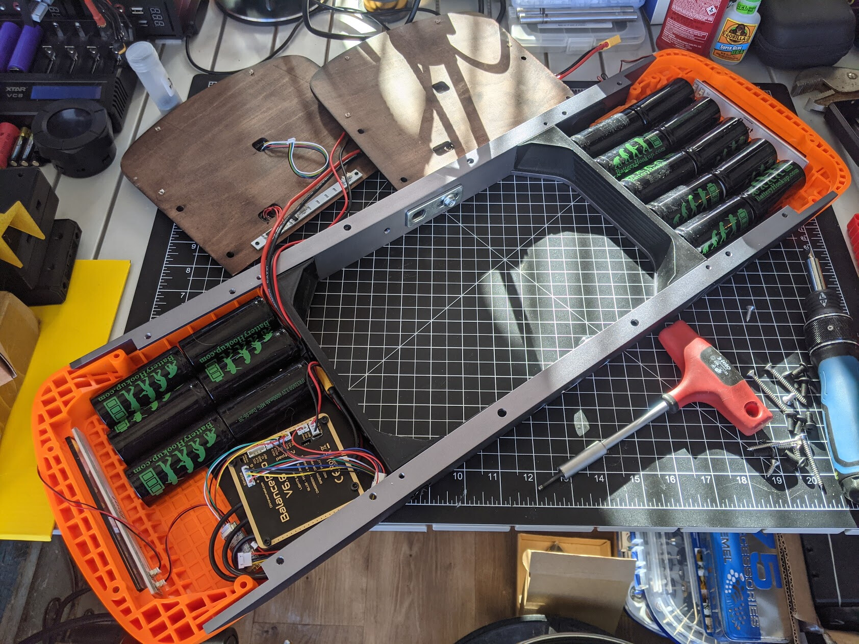

make sure you get better boxes. wouldn’t want you dismantling batteries too :joy:

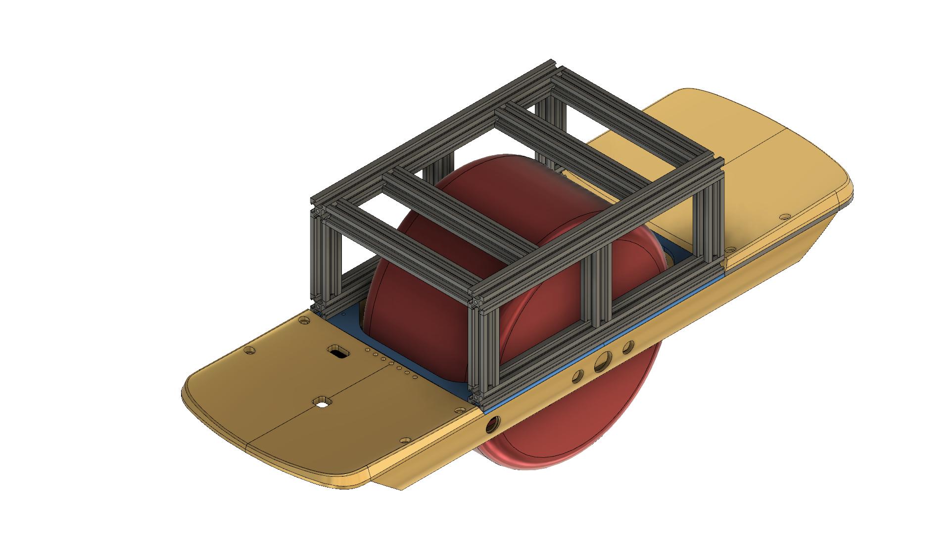

if i build my extrusion cage for my floatwheel, ill be needing some powerful cells :rofl:
I’ll be taking that CAD model now,
which part?
fusion btw
yes.

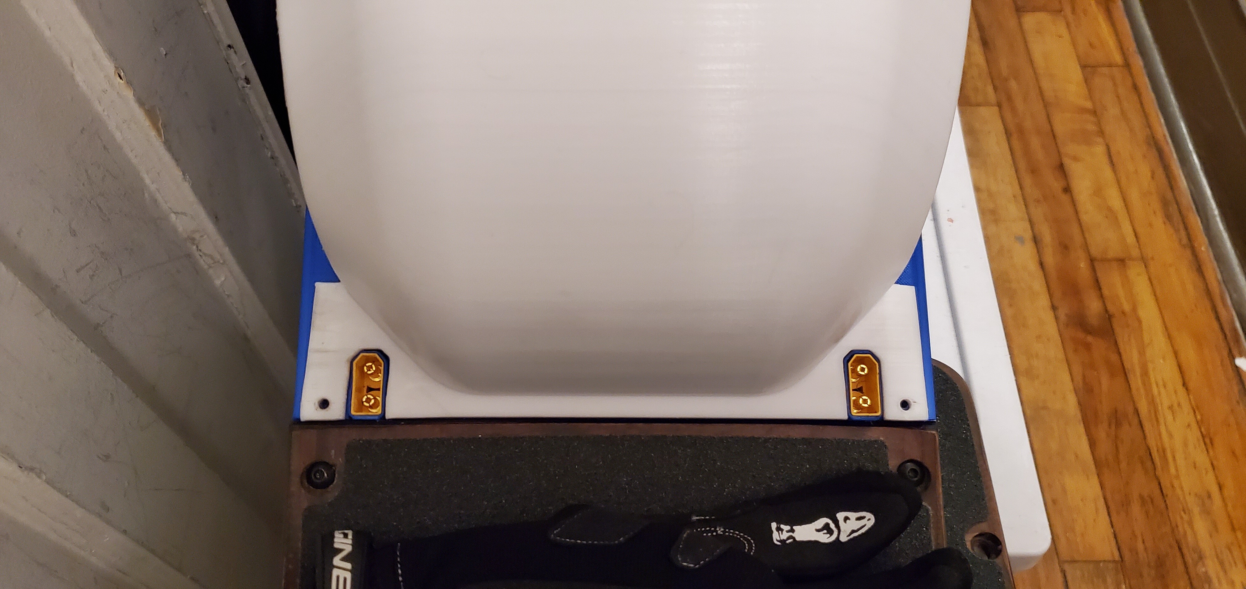

Also what cells did you really want for that? is it not a paralleled battery to the stock one? Then I could see using some more powerful stuff.
No parallel on this
Loopkey to cut off the 12s1p and an xt90 for any 12s pack I feel like using

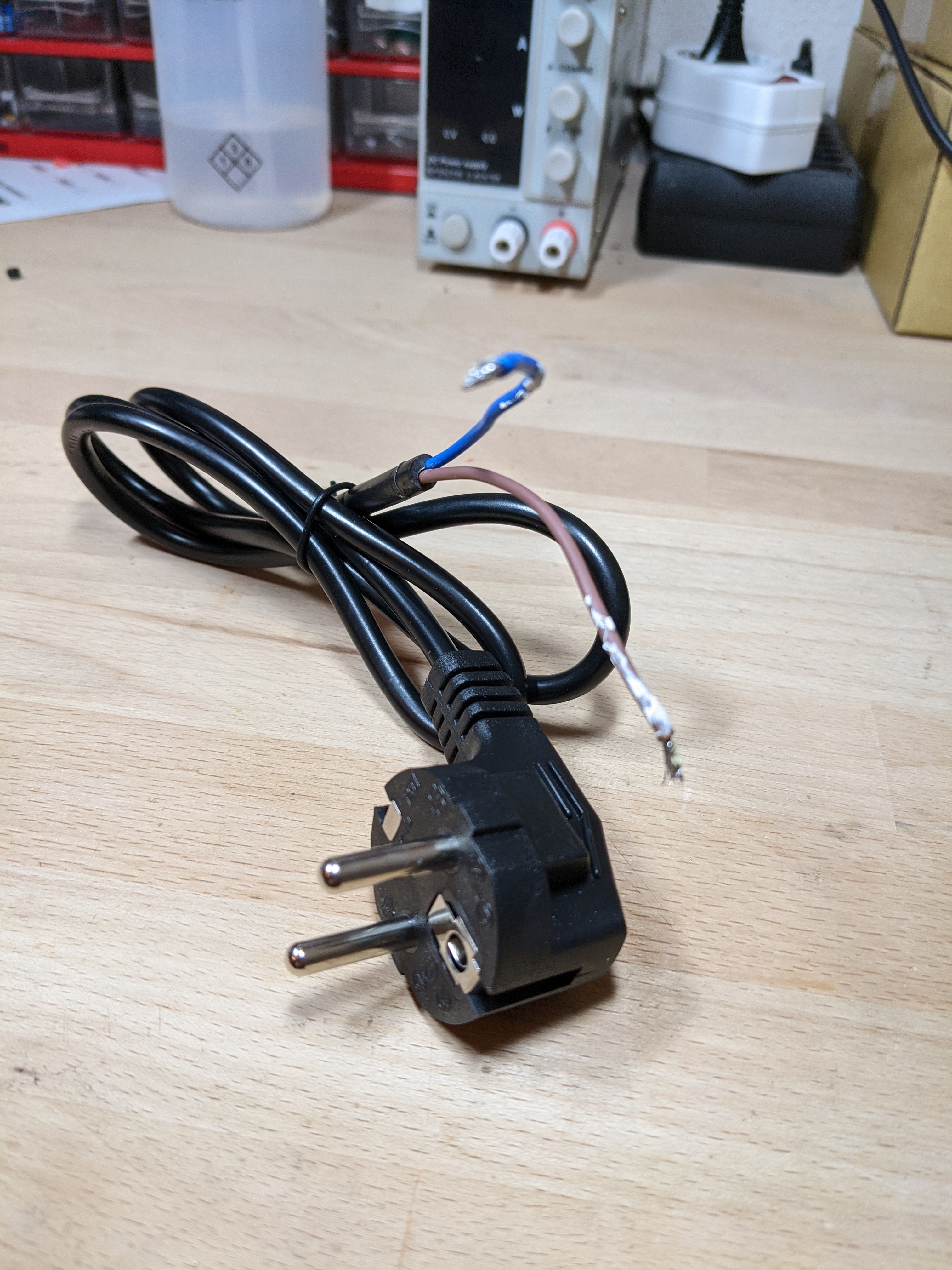

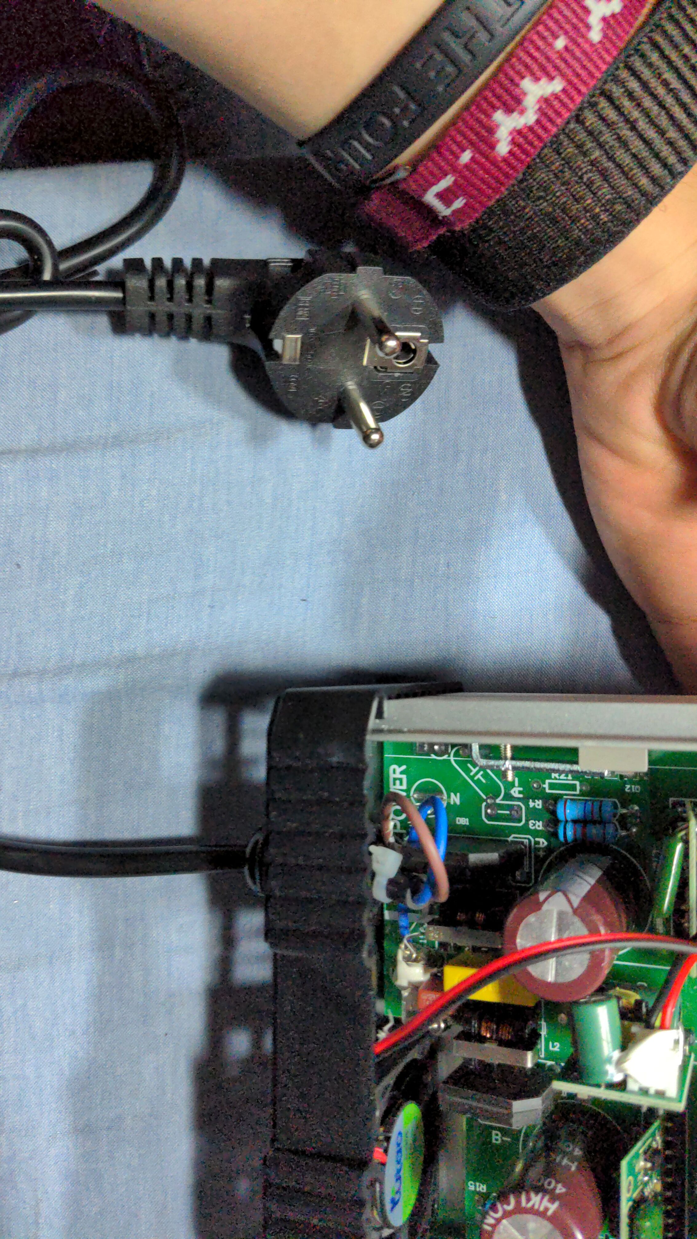

An example why I always open my electronics from China before I plug them in.
This seems like a grounded wallplug but there are just 2 cables inside the cord. The GROUNDING OF THE METAL ENCLOSURE ISN’T THERE.
If something fails there could be 230V on the case…
I mean look at this shit

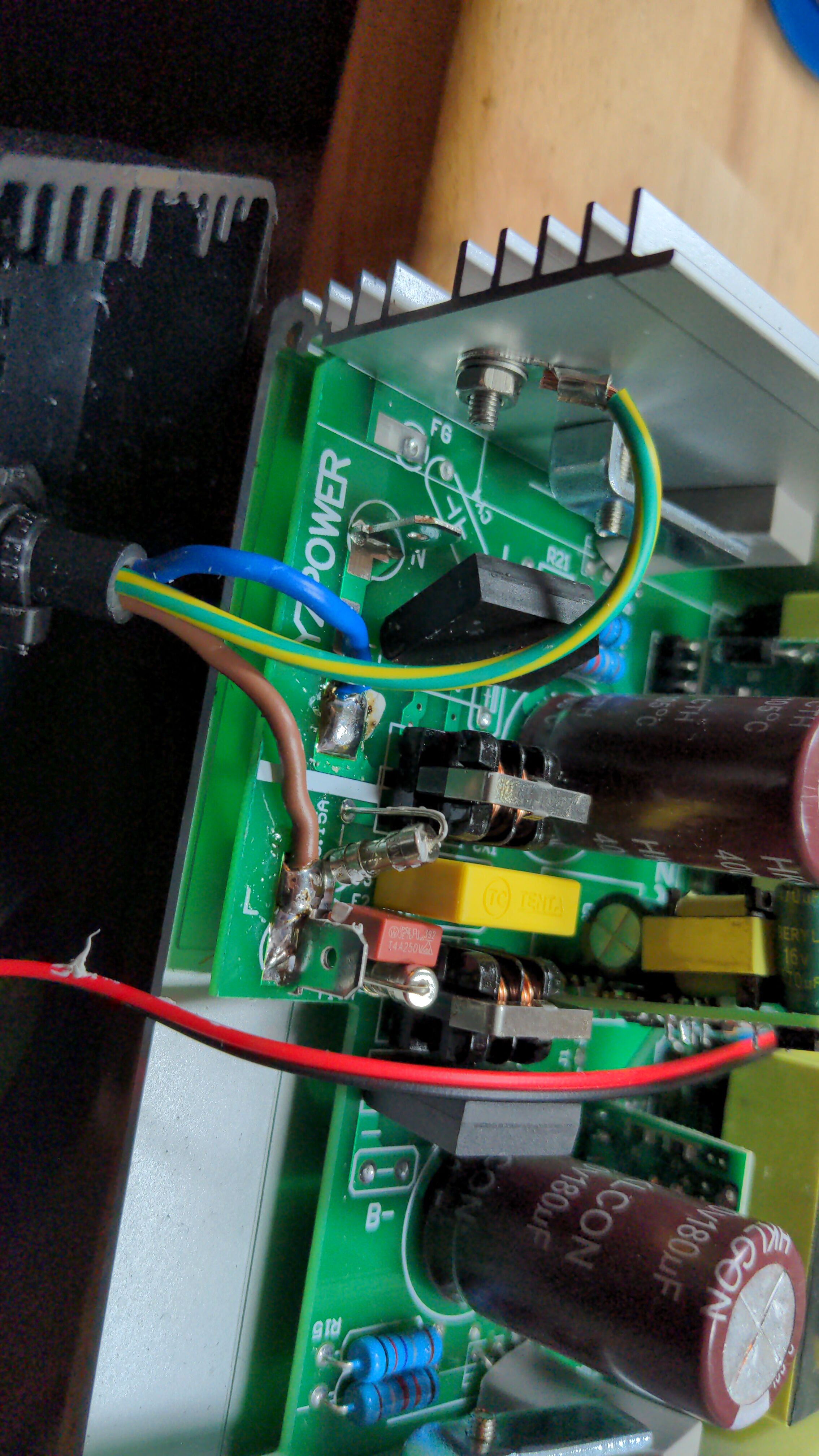

Anyway after calming down I put a proper cord with a grounding cable on there and screwed it to the aluminium case.
I mean if there was no grounding plug on the cable how would they have grounded the enclosure
