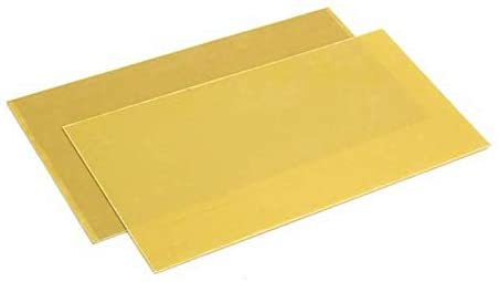

Im gonna look into it. Shouldn’t be hard. Honestly want some now for pack centers and edges, etc…
I think it’s like glass-fiber sheet or something, I’ve seen it in many stock batteries too
Edit: looks like it’s not hard to get since it’s on amazon
I’m building something similar. I have almost everything I need. Im building a waterproof( except being submerged) portable battery pack. It’s going to have about 2.5kwh pack with a 2kw 24v inverter.
If it’s G10/FR-4 that’s “blank” (no copper) circuit board material. Pretty tough and doesn’t start to go plastic until it’s up around 100°C if it’s the regular type. There are higher temp versions too though.
