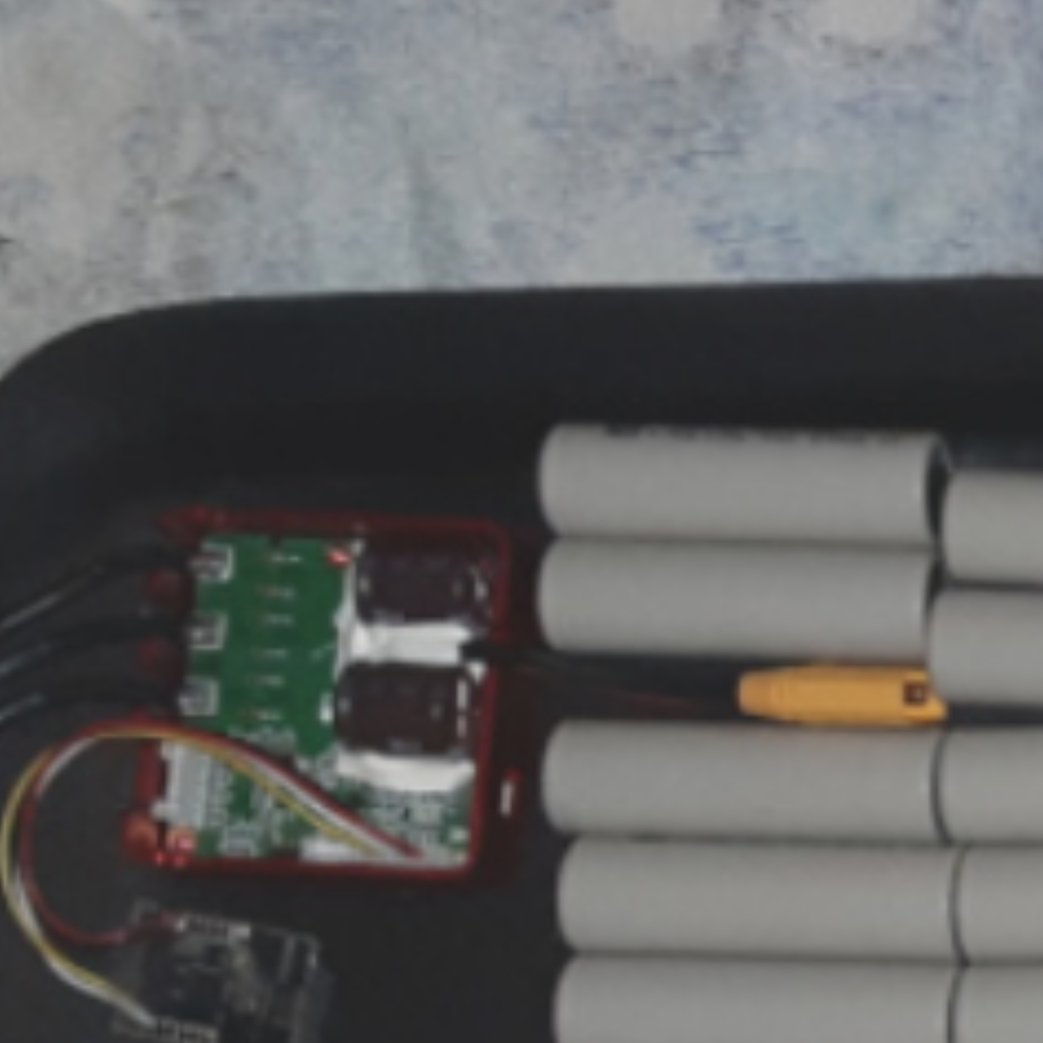

Having long and narrow batteries would also be the same, just longer balance leads…I’d decide based on if you think you’ll have other uses for 450mm battery again
Neobox ashtrays :rofl:
Did you glue 2 pics together? Lines don’t line up
so now you’re an art critic… yeah…
I didn’t want to drive to the shop to get my other ESCs
and the technical term is “stitch” or “'shop”
am I good to go now?
I “think” I’m going to Go for the big “C” 12s4p
looks easy-peasy except for the balance wiring… that will be a NIGHTMARE

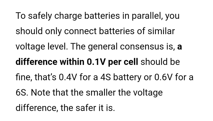

Guys using lipos in other hobbies do this all the time. they charge up their packs all off one charger by plugging them all in parallel. They just have to be at the same voltage when you connect them.
like this:
You sir just made my day. I noticed 4x 6s 5ah LiPo charging off one charger is a pain in the ass. Gonna get me a parallel charging board. Now, if only I didn’t have to make xt60 to xt90 adaptors :sweat_smile:
Sidenote: this info is pretty interesting
I was thinking of it as each 6s pack needs a diff of 0.1 or less. But it’s actually each cell which makes it so much easier
