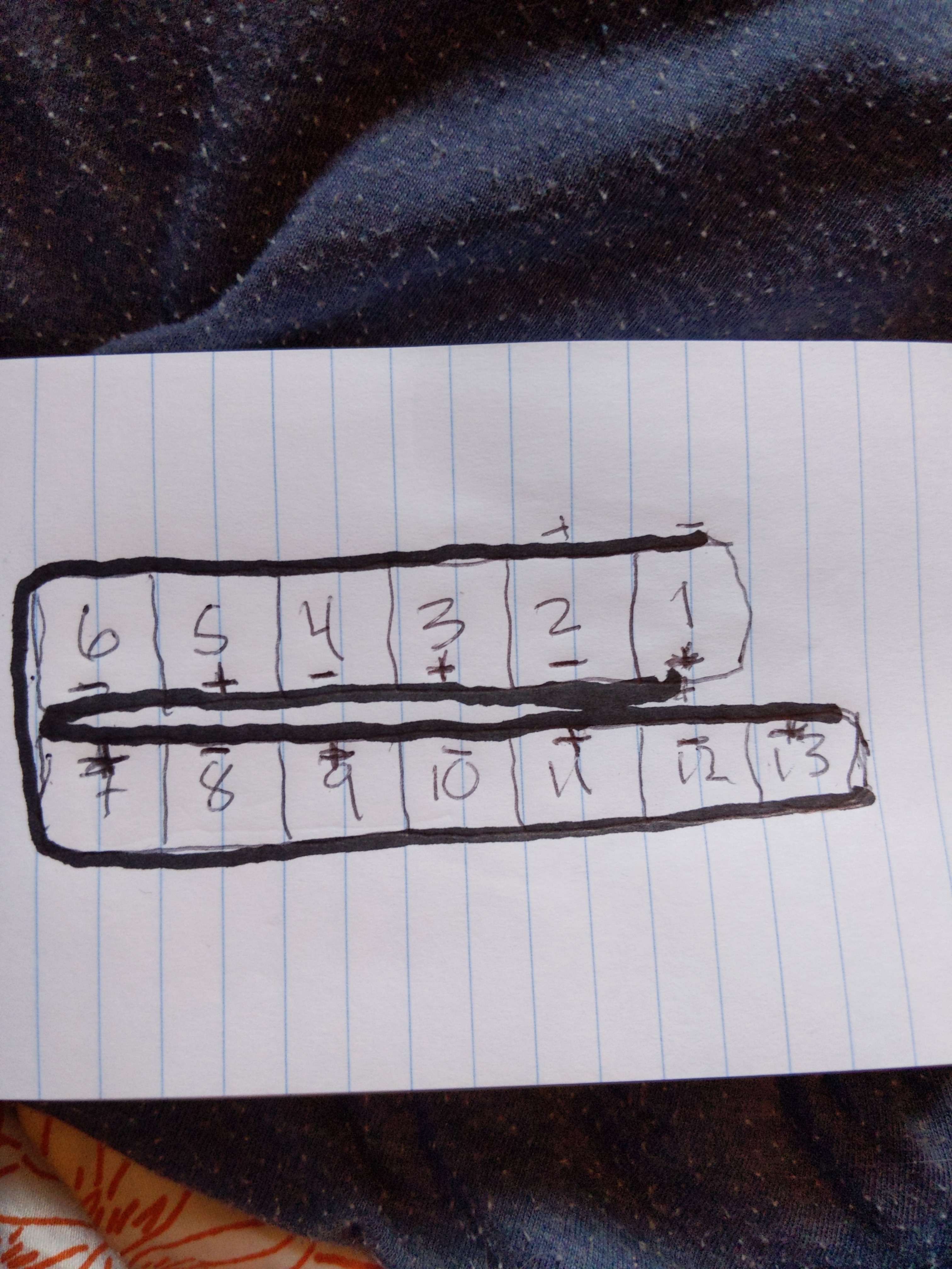

Is it safe to make my series connections with one long strip of copper braid like this? Assuming I isolate between the rows of course
How exactly would that work? You have to connect to both ends of each battery

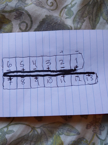

Also, what happens if you turn on your board while balance charging both batteries? would it power on?
Sorry, like this
I think I would do 12awg actually instead of copper because I want to make it flexi
Edit: I suppose I’d have to break up the connections. Nm. Don’t mind the noob

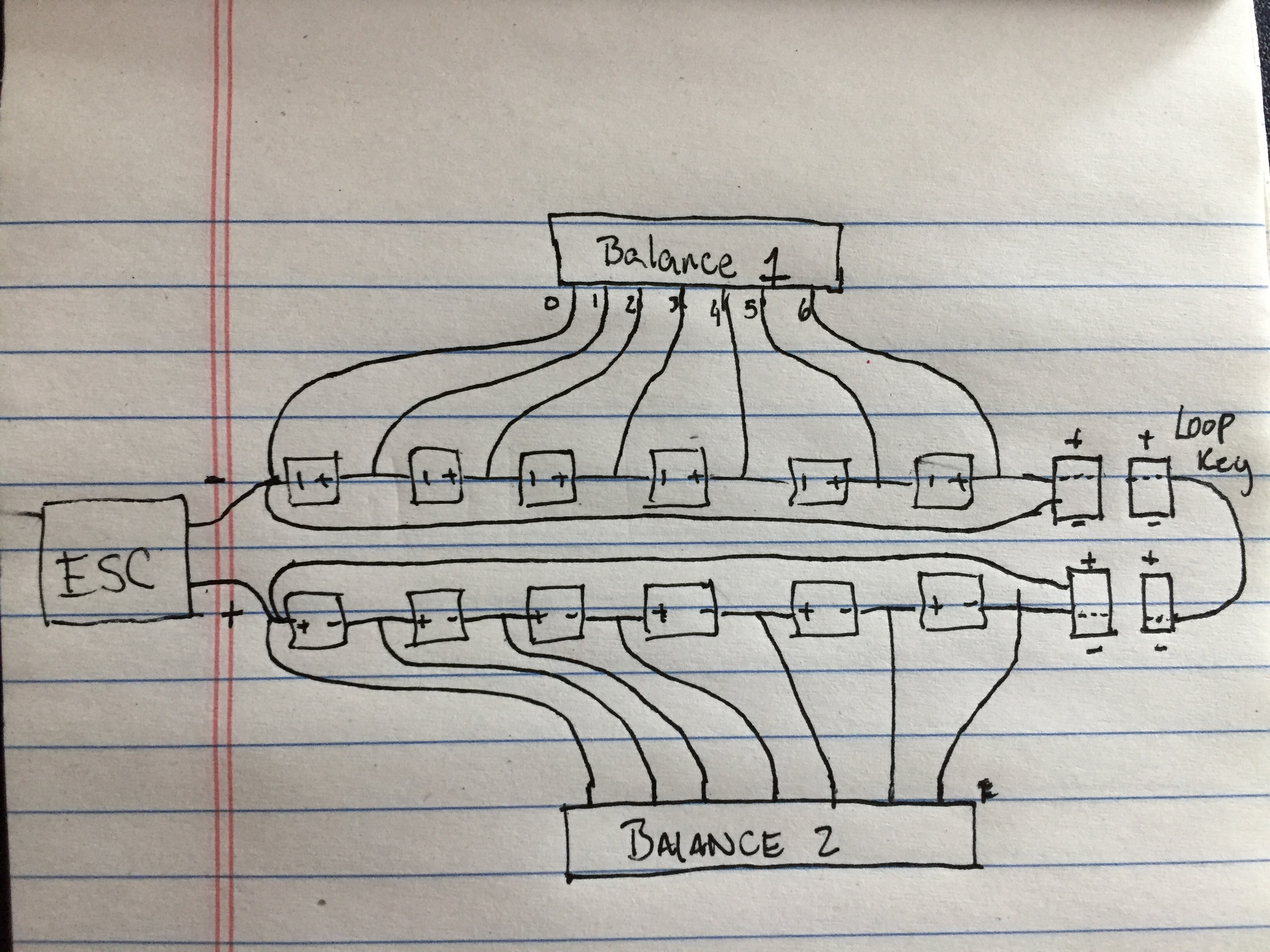

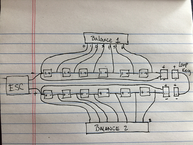

My old RC chargers didn’t go above 8S. Here is what I used to do to charge higher packs:
You need to have 2 independent batteries:
Battery 1: Main negative needs 2 wires, one connected to ESC connector ground and second to charging connector 1 ground. On the positive side, you need a single wire to charging connector 1 positive.
Battery 2: Main negative needs 1 wire connected to charging connector 2 ground. On the positive side, you need 2 wires, one to ESC connector positive and one to charging connector 2 positive.
To charge, you connect charging connector one to one charger and charging connector 2 to another charger (or 1 per channel on a dual charger)
To turn on, you need to connect charging connector one positive to charging connector 2 negative. Yes, it doubles as a loopkey.
You also need one balance connector per battery.
I’ll draw a diagram in a few minutes.
E: Here it is,
