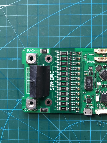

BTW, following this incident I implemented a major upgrade to my DieBieMS. :laughing:
