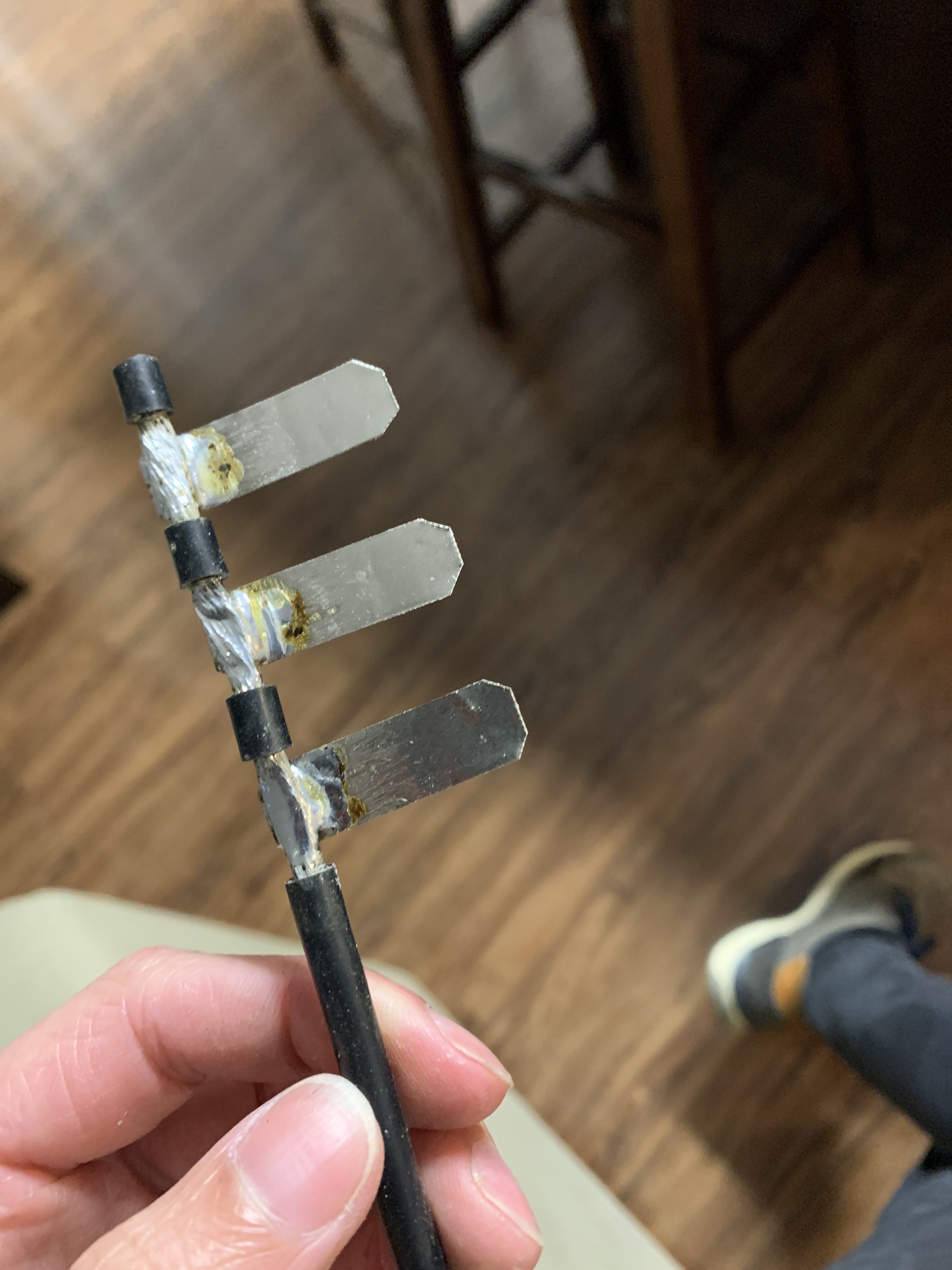

How do I do this without making the whole thing solid?
Agreed, pack may as well go in the garbage now
Lots of flux, lots of heat, move very fast. Also hemostats really help to limit heat and solder spread.

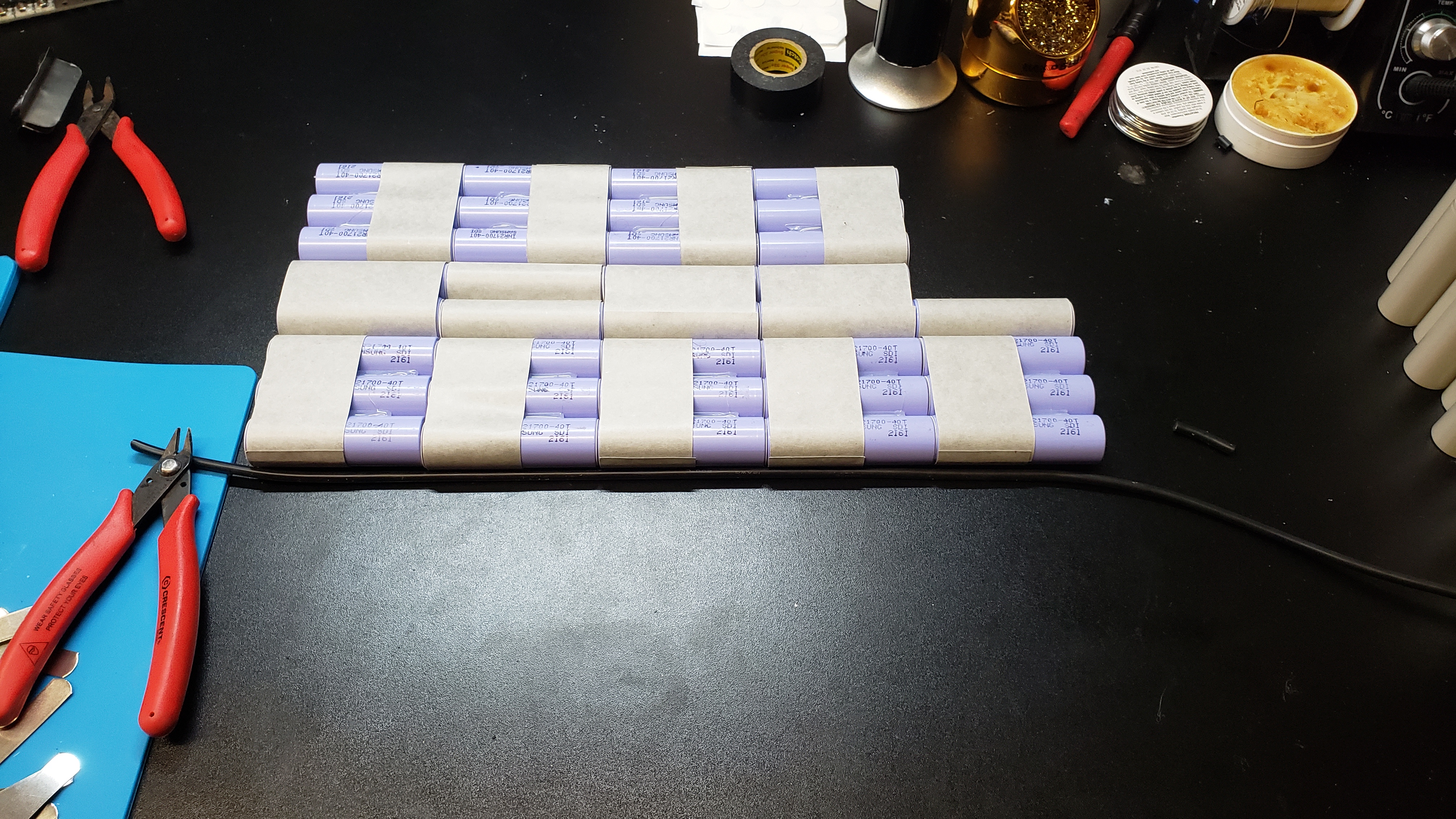

funcky configuration, will see how this comes together

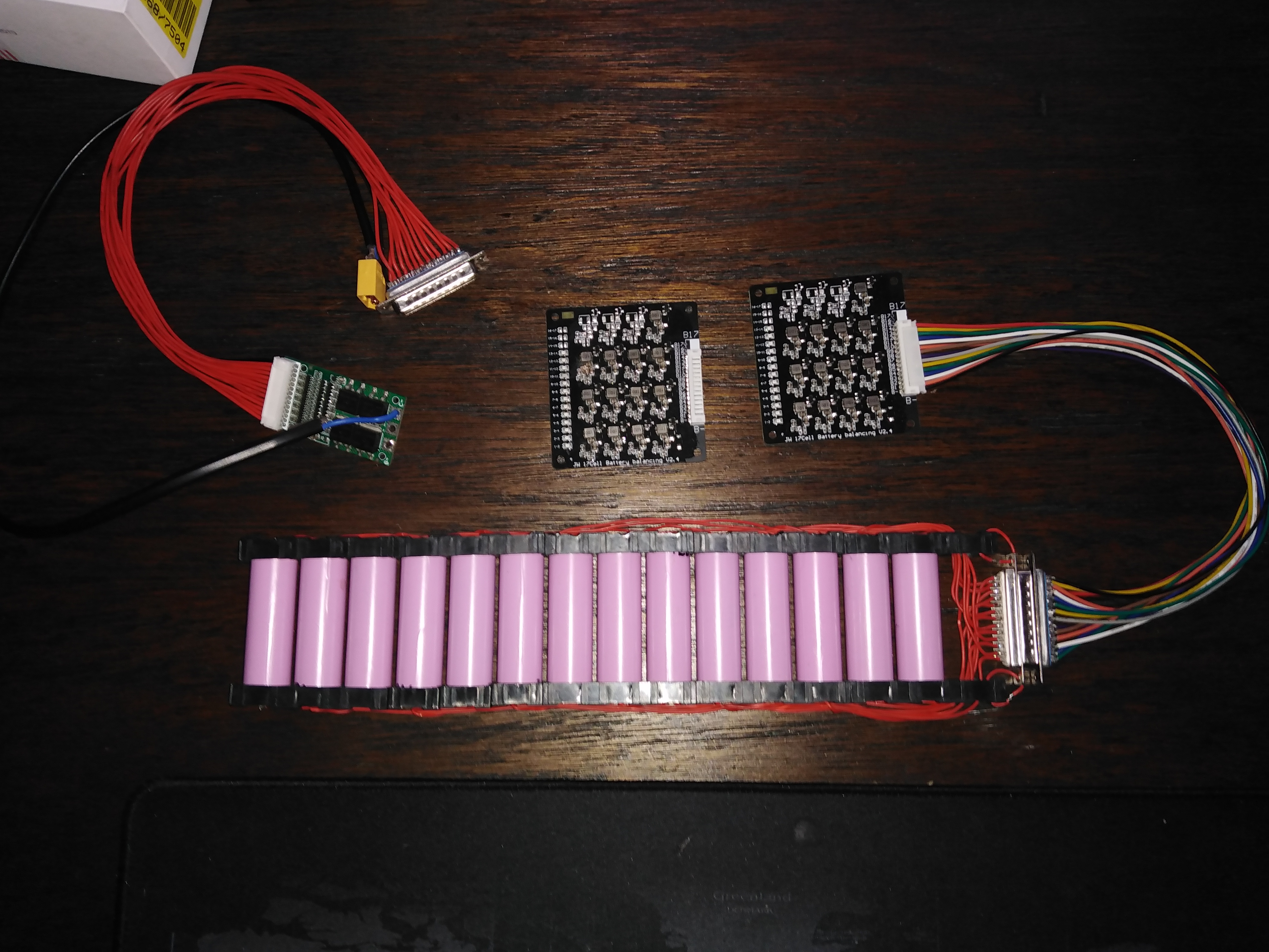

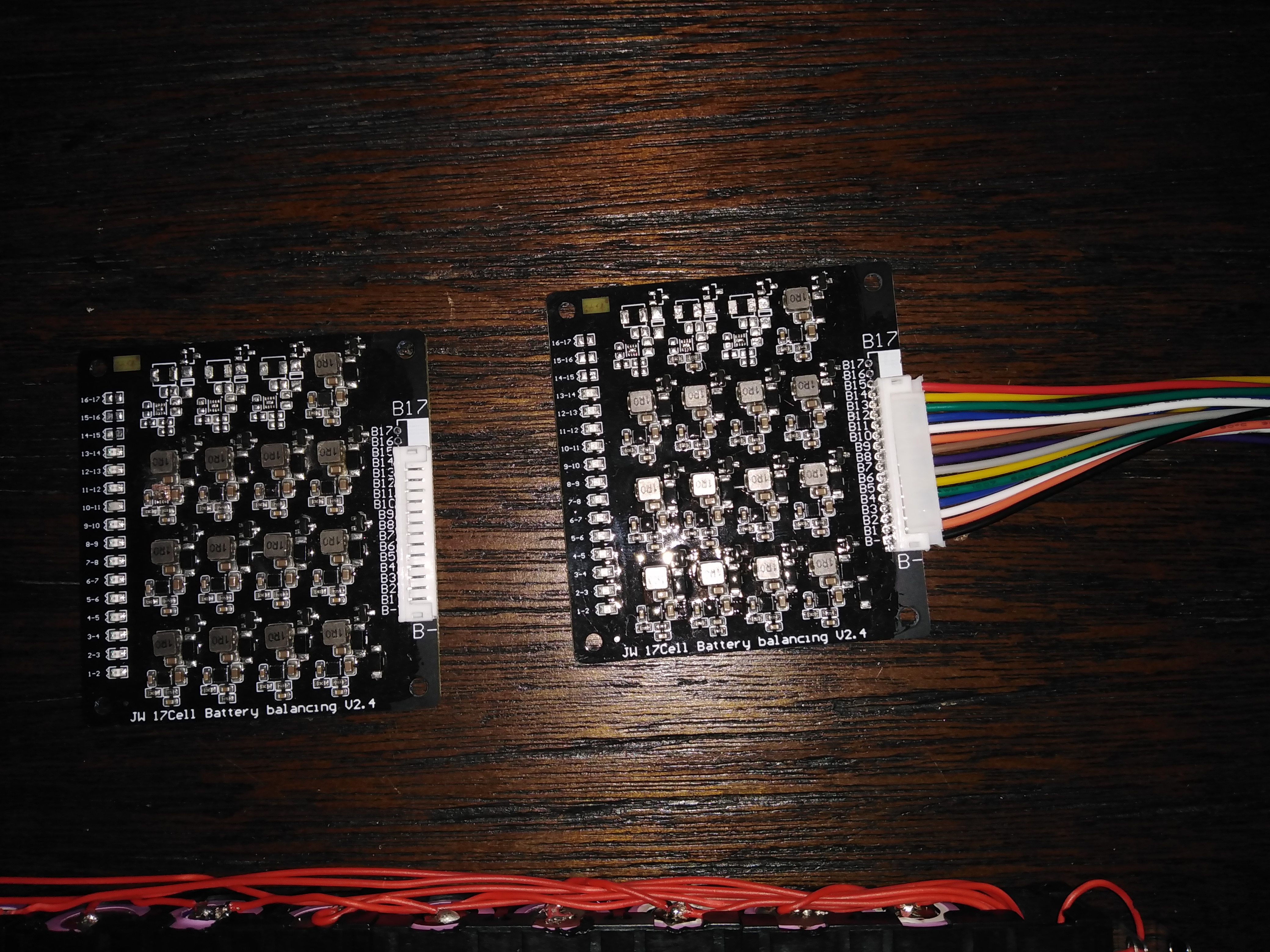

been testing this active balancer sort of bms,
pretty cleaver instead of dumping energy into a resistor and burning off the voltage it activly transfers the voltage acress each cell and balances each cell level been testing it fpor a couple of weeks now and works flawlessly,
first board i blew up :), i have a 14s board balancing the pink cells.
only downside there is with this balancer if is if there is a problem with one cell it wont stop, it just keeps transfering the energy into it non stop, but if you monitor each cell and there isnt too much vairairation then should be ok
i intend building my 12s9p pack without a bms, charging it with a charger then plugging in the balancer and balancing the pack every now and again, also keeping an eye on each cells voltage closly will keep posted
i thinnk bms are great but if using new cells shouldnt be a problem if monitoring each cells very regular, seen lots of people use lithium without bms;s without problems. am i right in thinking lots here just charge and no bms?

Those active balancer did work like shit for me.
They just start „balancing“ when the difference between groups are over 0.2V.
You can’t understand if the unit is working properly.
I did myself a test with two 6s lipos and a different charge, like 0,3V difference. The board never managed to balance the packs out.
I read that others have been more successful, but based on my results I personally would have a hard time to trust those units.
been using it for a couple of weeks now, and works flawlessly every cell 4,09v there are other versions out there mby you had a different one, they are pretty easy to blow up i did :slight_smile:

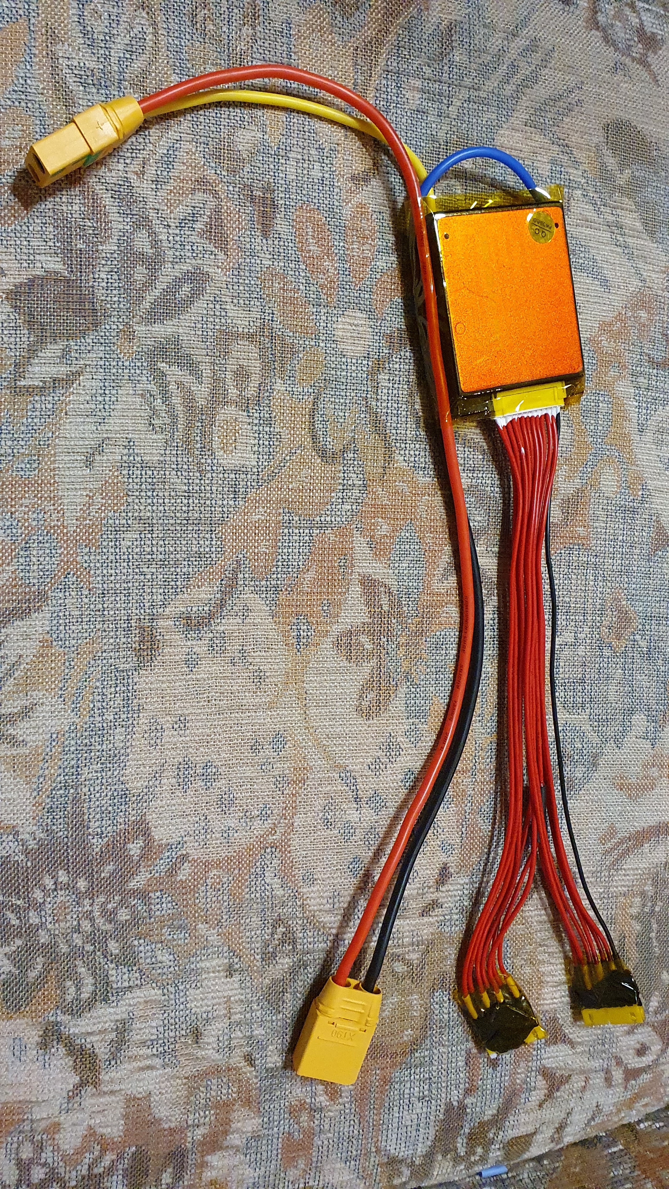

Anyone have any experience with building a balance charger with a regular charger and a BMS? Tips/tricks?
I did one for @xsynatic. For 2x 6s lipos. But it will work for any 12 configuration with wired balance wires.He can confirm if he uses it and how it works.
Can confirm. Works great :slight_smile:
