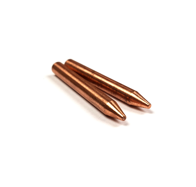

What kind of electrodes?

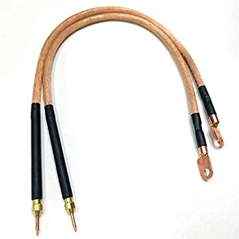

Is it safe to use some 10awg and a pair of copper rods in an epoxy block to make electrodes?

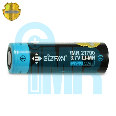

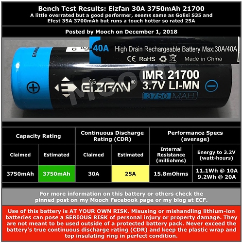

Hey, total battery noob here. I’m currently looking for deals on cells online but am finding myself unsure about the legitemacy of cells and vendors, and how to tell which cells and vendors I should be skeptical of.
These cells are super cheap and on IMR website, which I figured would be legit. Mooch has reviewed them as being decent. Has anyone got experience with these?

Copper I presume
yea but what shape size, theres lots of electrodes out there haha @jack.luis

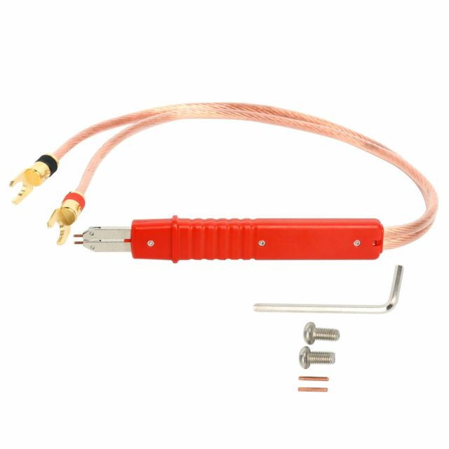

Shouldnt this fit?
I think im using the incorrect phrasing. I need the whole assembly:
Something like this
or this
I just need it fast
2 copper rods with 8awg or thicker wire, sharpen the copper rods to a dull point. Throw some heat shrink over it and bingo.
