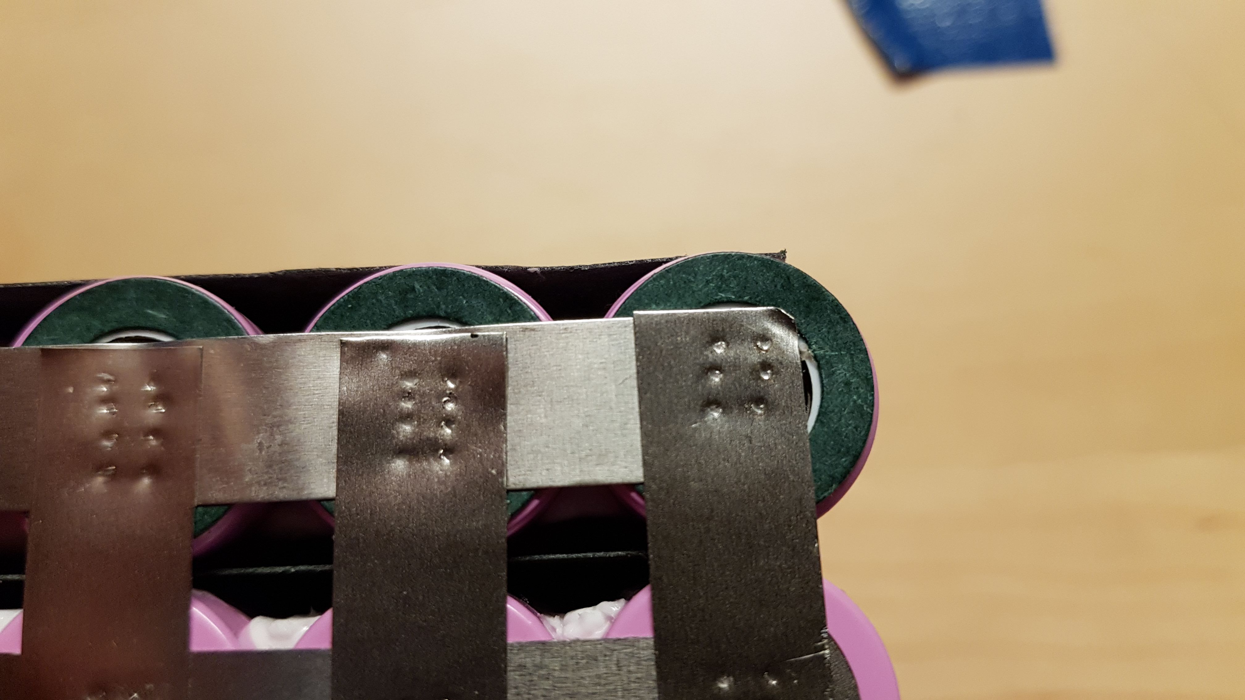

Hey mate, I’ll be honest. When I do something, I go into a no thinking mode sometimes and go into my own world. I stare. It’s like a switch. That’s unfortunately my nature.
Can you understand this?

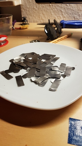

I totally understand. I experience a similar state while i’m trimming corners off nickel
Its meditative. You should try it some time.
Looks satisfying. That alone is reason enough doing the corners like that :sweat_smile:
Its a fucking pain :joy: but i cant help myself.
I should consider a crop-a dile. My keyfile works just fine. I have a dremel, but it creates a big burr. and btw. I’m flexing all day and it is also meditative.
Edit: I meant a angle grinder. :joy:

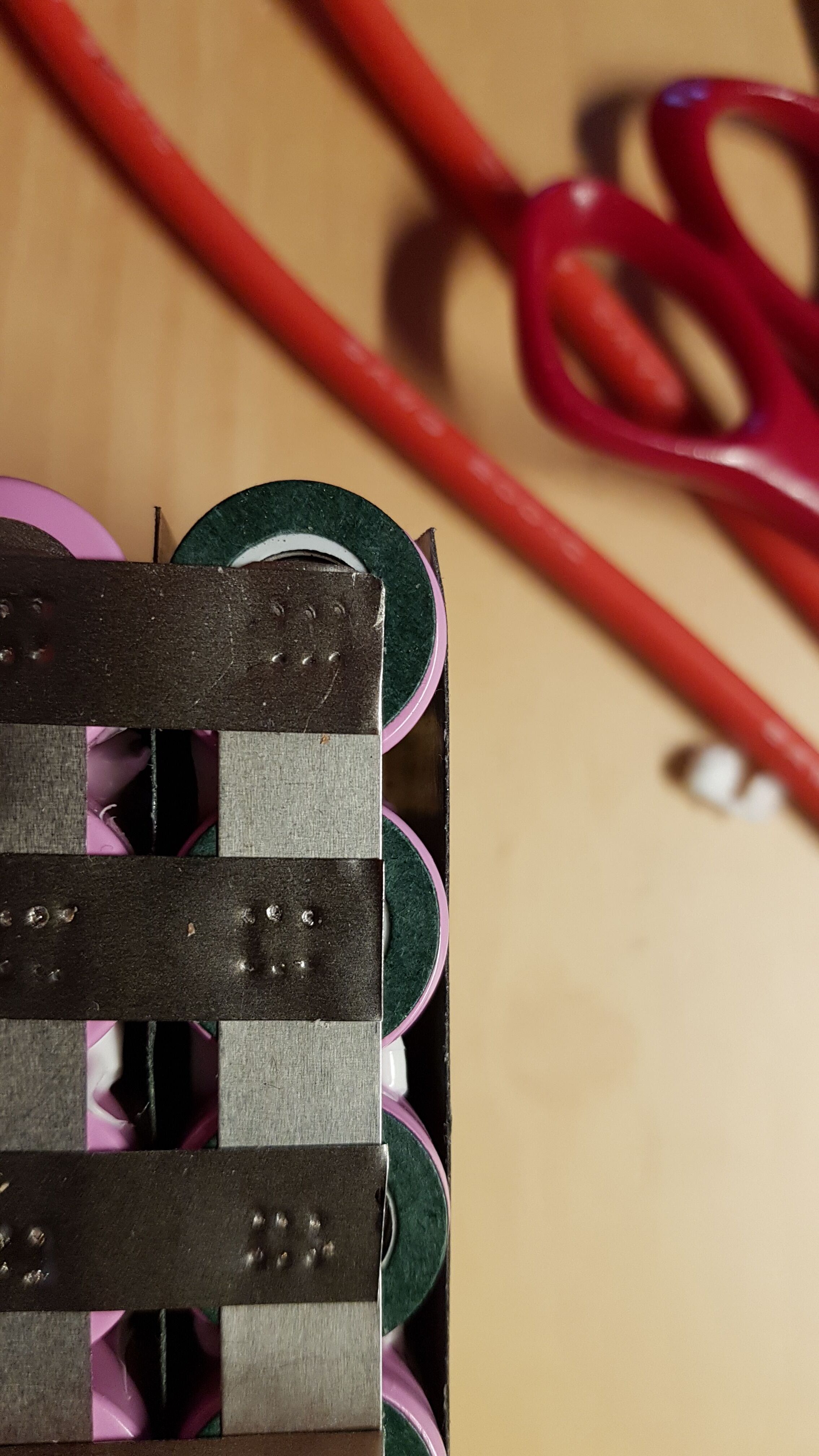

A good pair of regular scissors works fine dude.
Apart from the sharp corners its looking good so far mate. Good luck with the rest. Hit me up if you need any help :+1:
Thanks dood.
Let’s say I’m on a good way.
Oh and my scissor is magnetic. :joy:
Nickel strip would be incredibly easy to round on a simple belt sander, wouldn’t it? As long as you use proper technique there should be no risk of shredding the belt. Pretty sure the harbor freight base model is like $60, and a pair of corner chomps is something like $35. Not that it can’t be done with just scissors… but rounding shit on a belt sander is just relaxing.
I use, what I have available. :smiley:
Oh, that wasn’t directed towards you. Was just a general question. I’ve never tried and I guess I’m just wondering if it’s too flimsy to do well just holding it in your hands and taking it to the sander, because if you had to clamp each piece in something it then wouldn’t be worth the time.
I actually clamped a strip into a vice and grapped my dremel to try it out. Would have taken to long and it vibrated too much for me.
