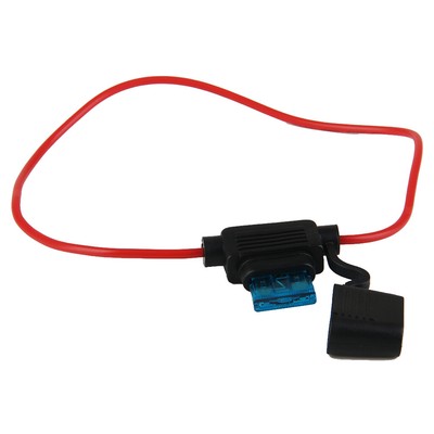

Thoughts on this one (15A version) for a 12s 8 a charger
150% of rating. Slow-blow.
Why slow-blow? Don’t the electronics on the BMS fry pretty quickly? Do the blade fuses count as slow blow or only the glass ceramic ones?
The fuse is there to protect your house from burning down, not the electronics. A slow-blow will be fine as you dont want to replace the fuse if theres a quick current spike when you plug the charger in.
Can I get 2 fuses please? 7.5 sounds good since I charge at 6.

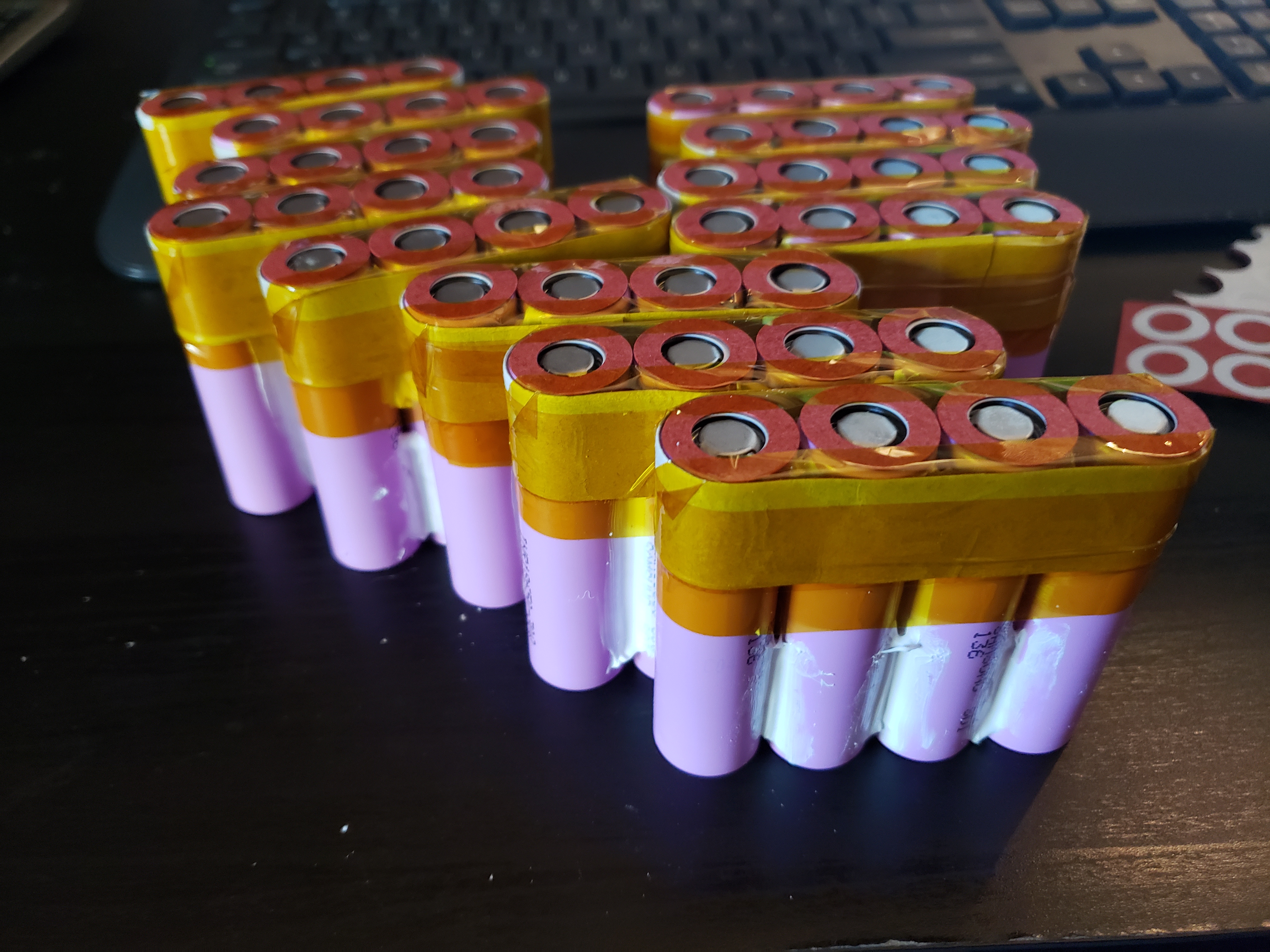

I built a modular 10s7p pack (30Q) a while back that I can disassemble in 5 minutes and pack away in lipo bags for transport/air travel. Don’t have photos of the whole process, but took a few pictures. Each P grp has a balance lead coming out of the 3D printed casing.
Sizing things up:
All siliconed up, shoved in ABS 3D printed sleeves and about to get welded up.
3 out of 10 modules done
The lesson I learnt was: It’s annoying and challenging to keep 10 packs of batteries neatly organized in your deck. It’s a mess in my enclosure. The concept is nice, but the reality is that this didn’t work out as well as I planned. I ended up taping everything together to keep it in place during assembly and to not end up ragequitting. Sure, I can still undo the tape and disassemble my pack but it’s not as ideal of a solution as I was hoping for.
To make it function more like I was planning it to, I’m going to remove the ends of the 3D printed shells, dangly positive and negative wires and figure out a better way to connect the parallel groups to eachother. I want something that makes a satisfying click as I snap the batteries together. :thinking:

If you’re taking the trouble to do all this (thanks), it’s very helpful to see what NOT to do (photos too). Maybe more useful than the good photos.

Thank you! I hadn’t considered this! I’ll do my best to incorporate the bad ones too
