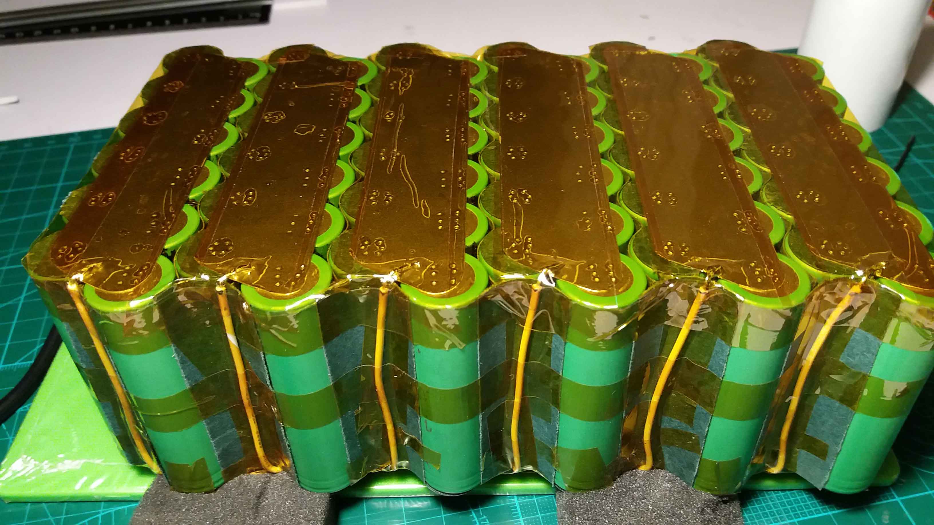

What size of heat shrink do I buy for a 12s6p pack in upright position?
It’s very simple to calculate. You take the circumference divided by 2 or just add width and height, then add 10-20% headroom est voila! That’s the proper size of heat shrink (flat dimension).
Here an example, my 12s6p brick is 200mm x 120mm x 70mm.
So the proper heat shrink would be 120mm + 70mm = 190mm. I could use 200mm (tight) or better 220mm. For the other side it’s 200mm +70mm = 270mm. A 300mm heat shrink would be fine.

You mean “add width and height”, right?
