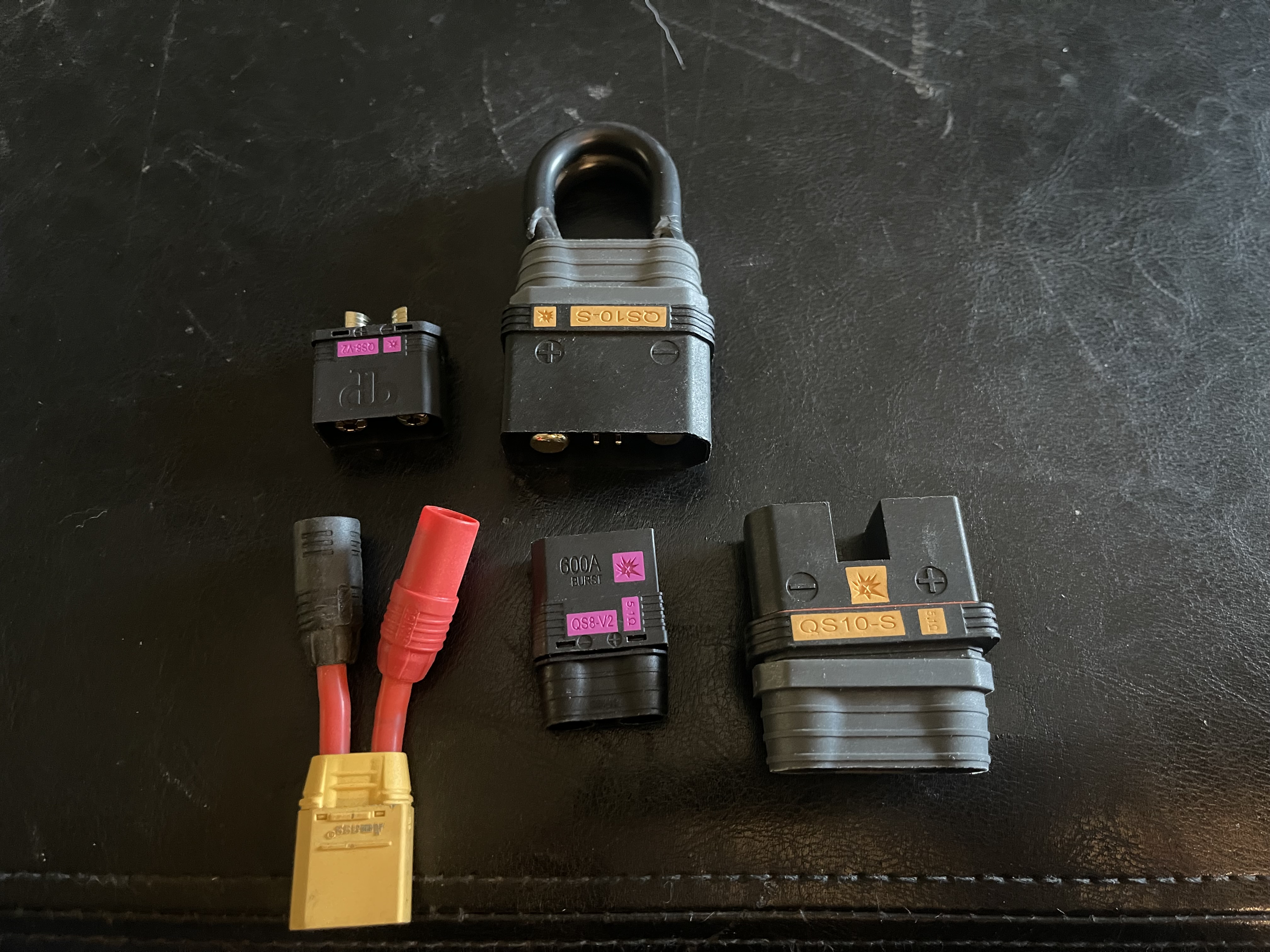

Hey lads, recently recieved a Exway Auxpack from one of the local riders to play around with, any idea what connector it is that they are using?
By the looks of it, its using 8mm bullets and 4 inner bullets that probably do nothing but cant seem to find a match.
Closest I have found is the qs8 connector (has the 2 bullets but not the 4 smaller ones) and the AS120 connector (has all bullets but are placed differently)

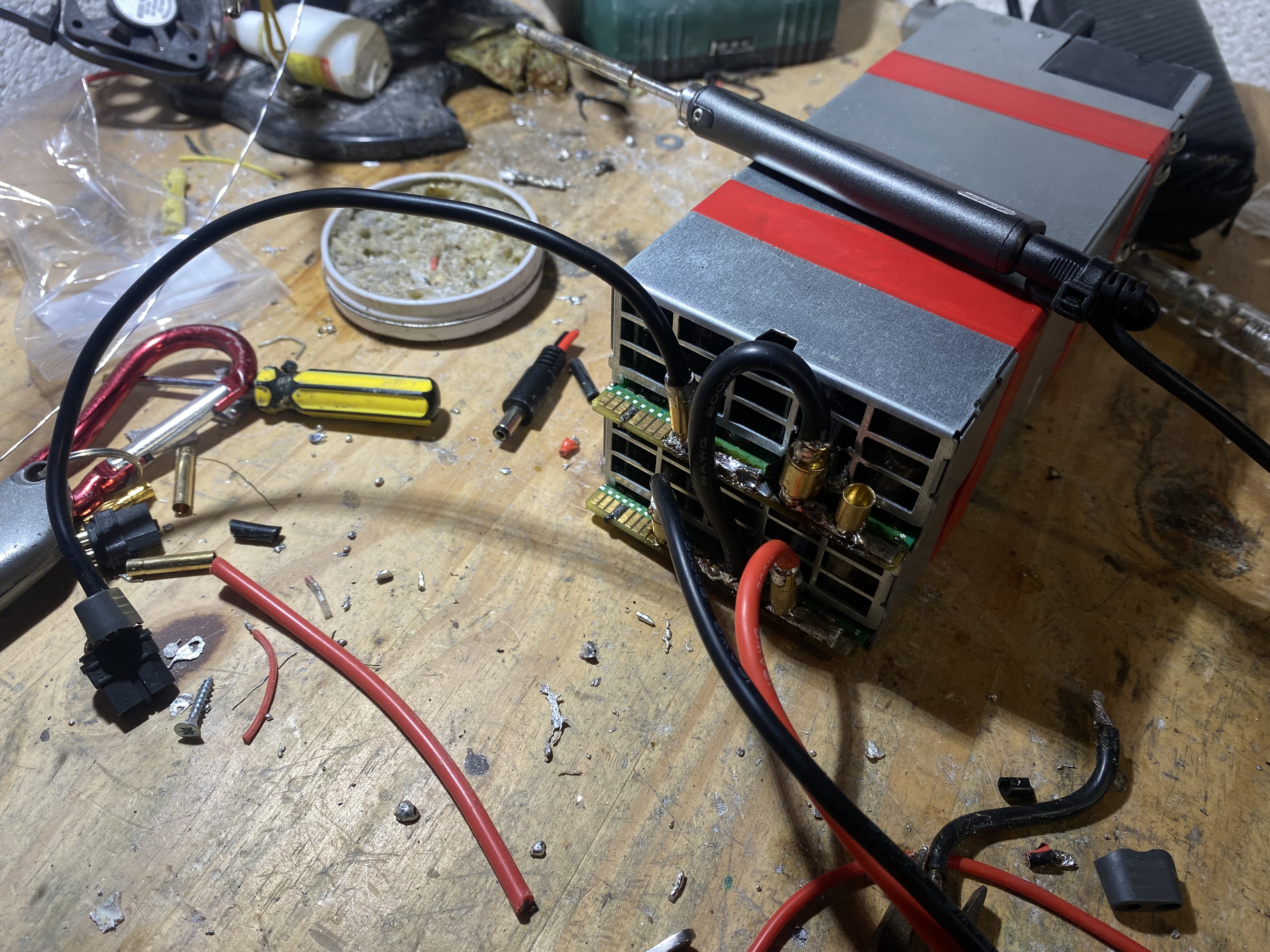

I have done that, it’s super cheap power. They have all kinds of short circuit protection etc which has saved me a few times.
Bargain Hardware is great for getting them. It was <Ā£10 for a 750 watt psu.
ended up buying a bunch from aliexpress to test out, out of all of them it was the qs8 that worked! sadly not able to find a config that has the 4 smaller pins in the correct location.

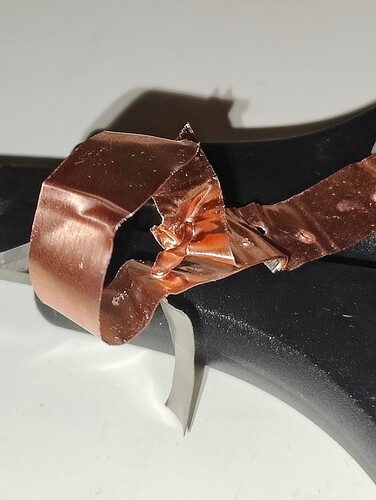

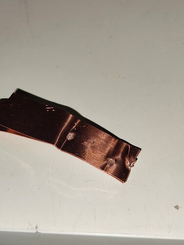

I’ve just got a new spot welder, the Glitter 811H, 42kW (7000A) variant. It’s a beast. Got it on sale for about 400€ including tax and shipping, with delivery time less than a week. Usually goes between 550-600.
Figured I would share. If you are looking to do a kweld supercap setup I think this is a significantly better buy.
50 mm^2 / ~0AWG cable going to the tips. The probes are super heavy.
Makes the kweld look like a toy. During my first weld I got genuinely surprised from the magnetic fields pushing away the probes and the cables from each other. Doesn’t help that first I tried to penetrate triple 0.15 copper + 0.15 pure nickel and weld it onto a cell at 99% :grin: stacking copper requires welding flux which I did not use, I suspect this is the reason the weld didn’t go all the way through, because I’ve seen others do 0.4 copper + some nickel at 90%.
Next up a single 0.15 copper strip with 0.15 pure nickel on top at 30%. Measured 7.6kA on the screen with the caps charged up to 6.1V
Very strong weld but I need to work on getting more even pressure between the two probes. This is not like the kweld, here I need much more pressure for a good weld.
I’m ordering some 0.3 copper and 0.1 nickel plated steel to do more tests. And for now build 4x 5S1P flight safe modules with BAK 45D tabless cells, will report back when I get further along with tuning in the welder.
Are you not worried about that much welding current and pressure puncturing the cell can on the negative terminal?
I’ve watched a couple videos and tried reading up on it before buying it and some high power ebike battery builders use it with good success on 21700 liions, even though it is originally more so intended for welding to lifepo4 cell tabs. The only way anyone is going to puncture the can is by turning them up too high.
The thicker you go with your connections the more crucial it is to have it tuned in right for your materials with some pull tests, but tuned in it’s not going to puncture. The extra pressure isn’t an issue because the time while you have melted material is also significantly reduced.
Also it’s going to stay more consistent throughout the pack because it doesn’t really heat up and change resistance like the Kweld does. So it’s really is just one tune in and they work.

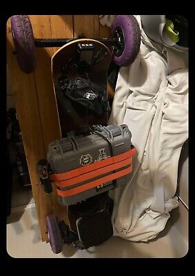

I’m looking for some advice on a pack for this thing that I bought and is supposed to show up tomorrow:
Obviously, the battery is absurdly under specced compared to everything else. This will be my first mountainboard, and I mostly plan to use it off-road, but I may also try to go to some races or at least racing practices.
I’m mostly looking for something that will be more power and voltage-appropriate and not completely blow the bank. Also, I’m honestly more worried about keeping weight down than getting a huge amount of range. I know an 18S5P or more P42 or P45 would probably be ideal, but I’m also trying to look for more budget options. I’m also curious if 18650s or lipos make sense if I’m just looking for good power and light weight at as low a price as possible. 18650s seem bad if you’re looking for range per dollar or range per weight, but better if you’re looking for power per dollar or power per weight, but I’m not sure if that is actually true. Just looking at P42s vs P28s it does though.
Also, the cheap ass in me was looking at
and
I know these are far inferior to P28s and P42s, but they’re cheap as fuck and seem to suffer more from low capacity than low power. Would these be serviceable for my goals, or should I really avoid older cells like these even if they’re claimed to be good? I’d probably do at least 18s6p with those, and it would be massively cheaper.
There will probably be some great Black Friday deals on lipos soon. It’s an easy (potentially easy ) alternative to building a whole pack when you just want to get out and skate.
I have a few boxes of the battery hookup 30T cells. I was planning on using them for a MTB with a pelican. Nothing special, not trying to do long distance or backflips on my MTB.
Lipos do need extra care over their admittedly shorter lifespan, but making a 12s pack from two 6s packs is easy.
I think the best pack is the one that gets you rolling sooner.
I mean, I’ve built packs before, so it wouldn’t be a big deal to build one for this. It would be the largest I’ve built, but since it will be a brick pack in a case on top, it shouldn’t be difficult. Now that you mention black Friday, maybe I should wait for that and see what happens then, though. Idk if 18650battery store or liionwholesale do sales specifically for black Friday, but maybe they’ll do something.
What kind of current can you actually expect from lipos? I assume the insane 100C ratings are overrated, but I don’t know what I actually need if I go that route. I want something cable of 150 amps or more since that is about the limit of the ESCs. I’m not sure if I’ll be able to handle all of it as my most powerful board right now isn’t super high power, but if I’m going to upgrade it, I don’t want to have to do it again soon.
