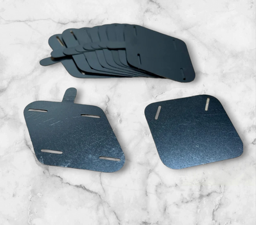

I’m doing a 20s1p Onewheel pint pack and i may be overly finicky here but really need this nickel design.
I know the single tabs mboards has something very similar so I’m not too worried about those but the two different types of series connections the field and the ends I can’t find something similar. Mboards has a 2s piece but the tab is ginormous most mine only need a small balance wire tab.
Also the end ones do you think putting that cut in them compromises the current handling in a significant enough degree?

Seems a shame to add that cut at the end and adding a bottleneck. Unless it’s super thick or youre not using much current it looks sketchy.
I see no reason to not make them overall bigger as well
Since they’re almost all the same you could just make a paper template and cut them with snips.
I’ve got some custom copper/nickel bits u could cut n be better than just nickel especially since they’re so small as is.
The slit on the nickel intended for in the middle of welds on each cell isn’t necessary unless it’s really thick or copper
Oh I’m an idiot just realized I don’t need 2 cuts out of the end one just need to flip it 180 put the balance tab in a better spot too.
Plan is to be 0.2 nickel and i like the slit personally to keep welds away from the center of the negative post.
Yeah i know i could probably hand cut them just prefer the cleanliness and consistency of machine made components.
Might have to bite the bullet a modify a printer with a laser head just haven’t done too much research on how beefy of a laser I would need to cut 0.2 nickel.
Oh and it will be a p45b pack so likely 35 maybe 40a would be my battery max set point, I’m thinking.
Yeah in order to eliminate 1 notch those would need to be 2 different pieces or put that balance tab in a weird spot on 1 side or the other. I’m not getting why they are too small overall. They are just about the same size of the terminals of a 21700 cell, about 12mm wide and 24mm long. Would it be beneficial to make them closer to the size of the hole cell? Kind of just matching what other precut nickle option seem to do.

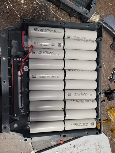

I’ll post pics this eve. There is plenty of room above the cells for connectors and bms behind in the regular place. Plus box is definitely better for 20s1p 21700

Finally finished my v2 modular fly battery lol. Rode it today for probably about 30 miles (with charging) and it held up pretty well considering the small leads. Obv. it’s not meant for very high current.
  • The black stuff is not burning; I believe it’s just some grub that got into the case or just my fingers
