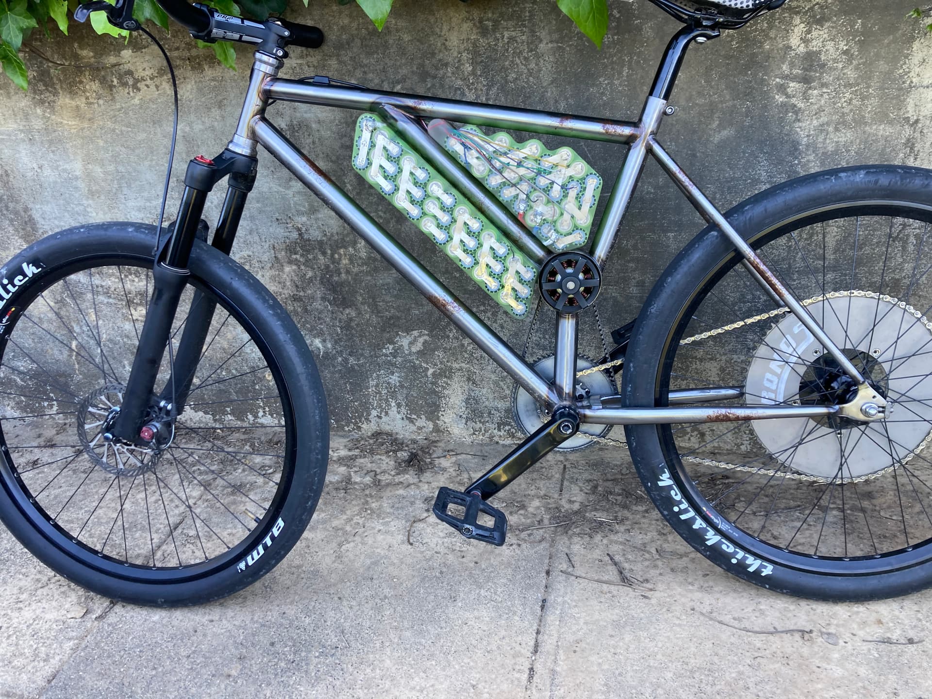

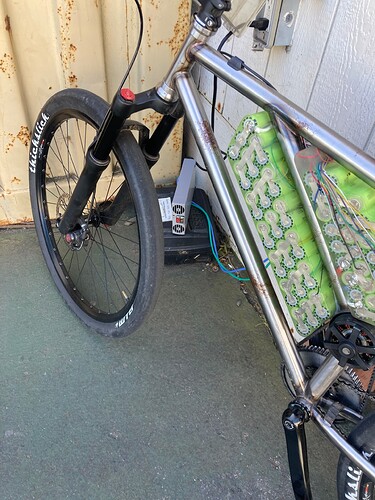

I’m making another battery for a bike like this but will use the aforementioned molicel p42s. They come without any covering on the cells, or at least it slides right off and doesn’t even cover the cell, and I want to re-cover them. How is that best done? Try to heat shrink on the typical vinyl(?) stuff with a paper donut under? That sounds tricky to get right and don’t like the idea of getting heat on a cell if not needed.
Then I’ll pot them like this

Not so much scared of using hot air, just don’t like the method and hoping to find an alternative
Something to consider…
Hot air is how wraps are put on by all the manufacturers. You can use a hair dryer on these PVC wraps, takes only a few seconds each. External cell temp stays under 45°C-50°C if done right.
Otherwise perhaps just use tape or find wraps that are a friction fit and use self-adhesive rings on top? Leaves a gap between the ring and wrap though unless you extend the wrap beyond the cell’s ends.
While highly recommended (unless the risks are fully understood) you don’t need wraps, just insulation between the p-groups and between the pack and the world. Top insulating rings are still mandatory though, of course.
