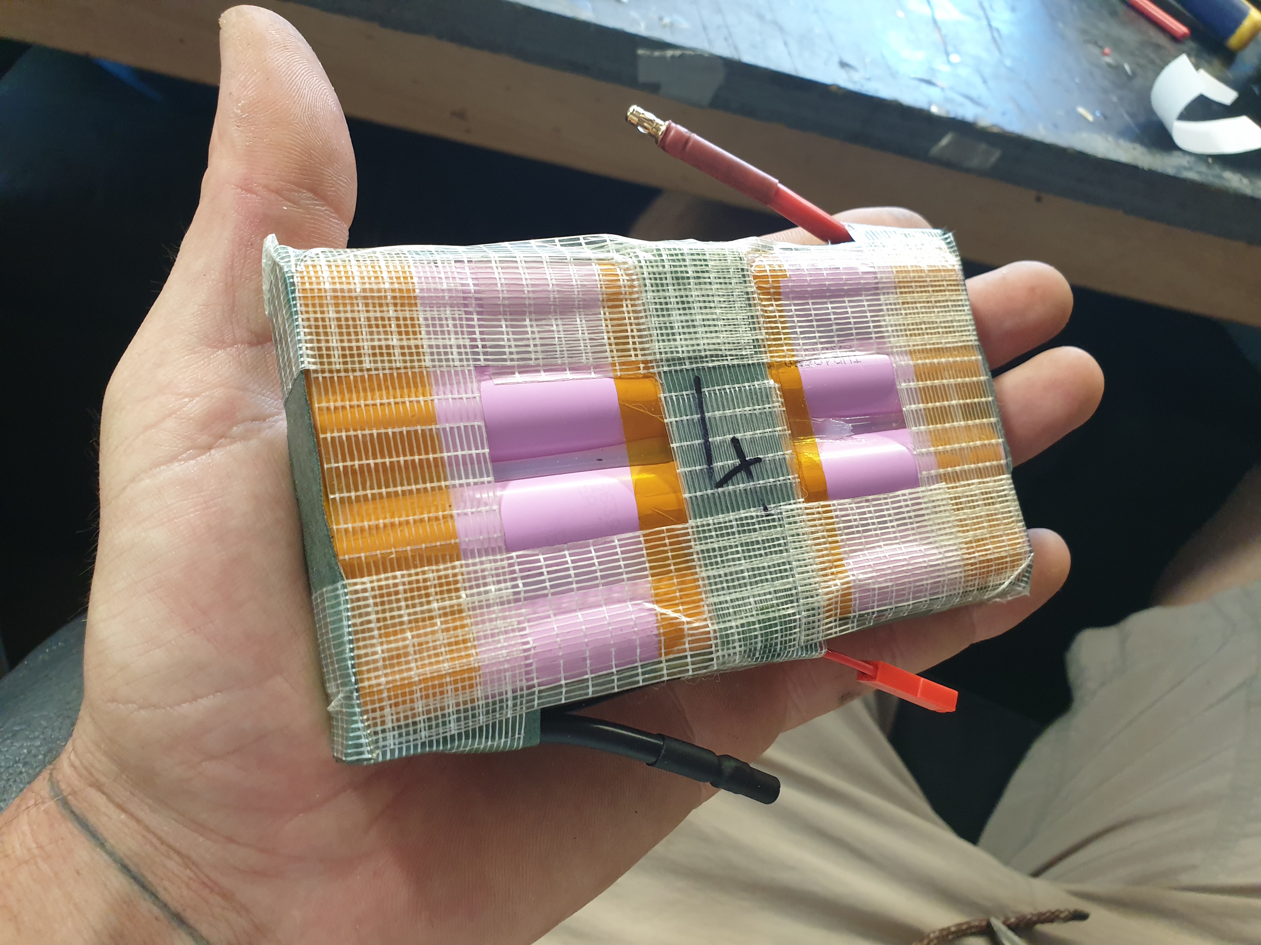

Now to do the mains wires and hook up the BMS. Also need to clearly label connections to make it idiot proof

Very happy with how this came out, still gotta print some labels for it in the hopes that it will get through the airport a little easier :+1:
Next is a flight friendly 10s4p for the neoONE deck :ok_hand:

Hi there what’s that white tape?
This white tape?
Looks like fiberglass mesh tape
@Fosterqc is correct. It’s called filament tape, it has strands of fibreglass through it. Helps hold everything nice and tight.

Oh that’s good to know. I have a lot of this left over from gift wrapping, think I’ll use it.

Remember that most tape exposed to heat is likely to get gooey and lose adhesion. I’ve found that the filament tape holds up pretty well to that.
Kapton is heat resistant but also tears easily :man_shrugging:
